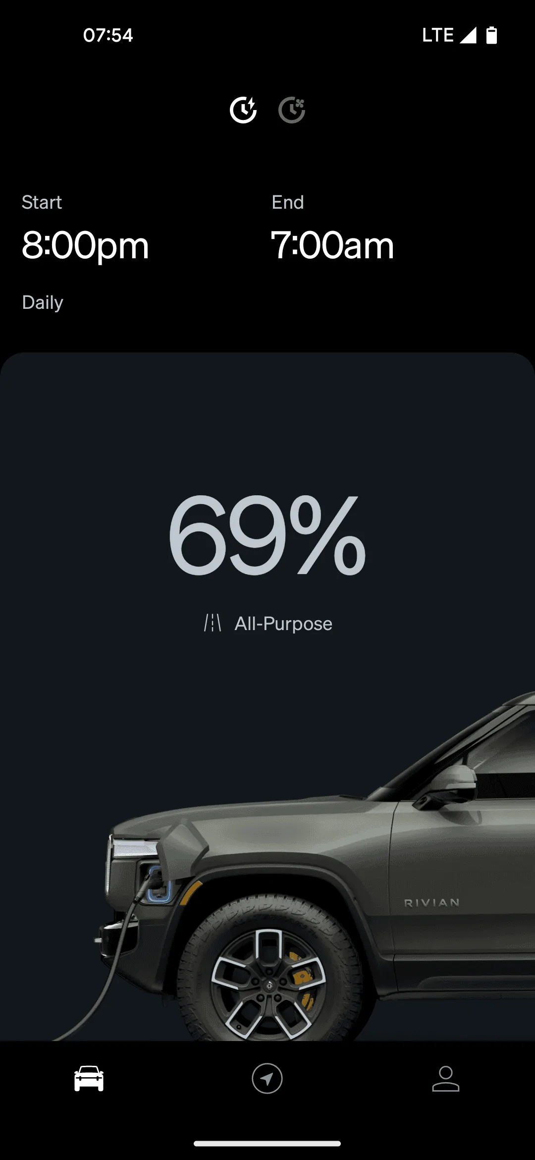

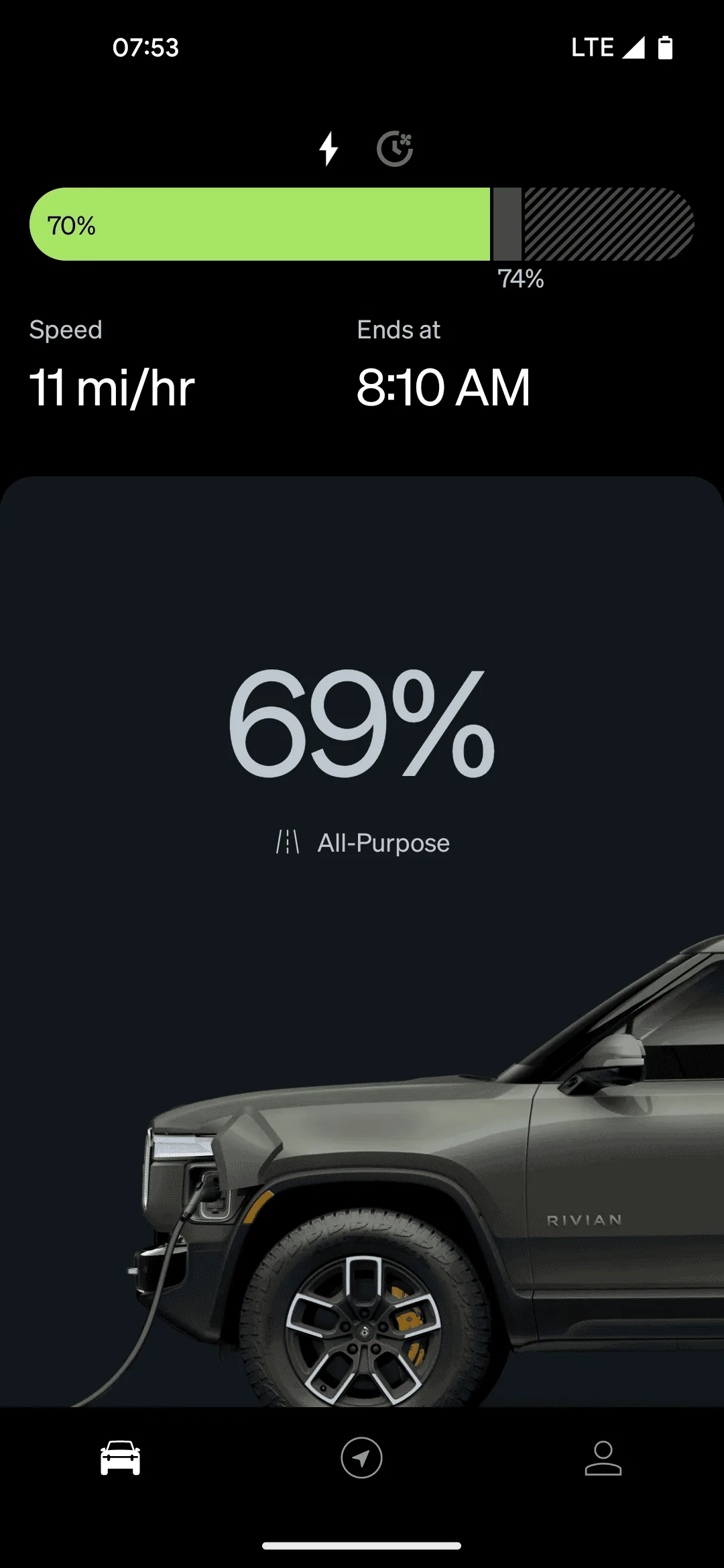

But I did use the app for the whole thing. I should've screen shot it, I distinctly remember seeing "will resume at"
Here's what happens when I charge off schedule then turn off:
Charging
Rivian R1T R1S Screwed again by manual->scheduled charging! 1000008974
Turned off (shows schedule)
