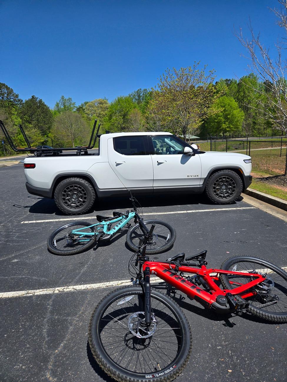

Pic attached of a regular activity this truck is awesome for.
Rivian R1T R1S Seat Memory - does this work for anyone? 1000012432
