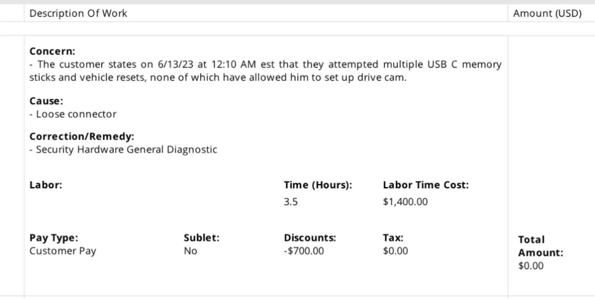

I’ve been unable to setup a new usb drive to record gear guard drivecam but the car does not recognize any usb-c memory drive. I’ve followed the instructions that many have posted online (format fat32, create gear guard folder etc) and bought multiple different branded 256gb usb drives but the car doesn’t register when I plug it in. Does anyone else have this problem? What’s the solution?

Yes. And I’ve also tried every combination of advice from actual users in this forum who have successfully connected at USB-C drive. So it’s now over to Rivian support to solve.
