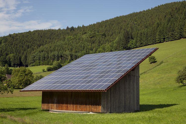

Like the previous poster I was going to say, build a small shed with solar on top and batteries inside at your property entrance. It will be useful for any EV or even if you wanted to drive a camper up you could plug it
Rivian R1T R1S Should I bail out or stick? GettyImages-570242981-a6380ff6a901450cbdb91192f50965ab
in.
