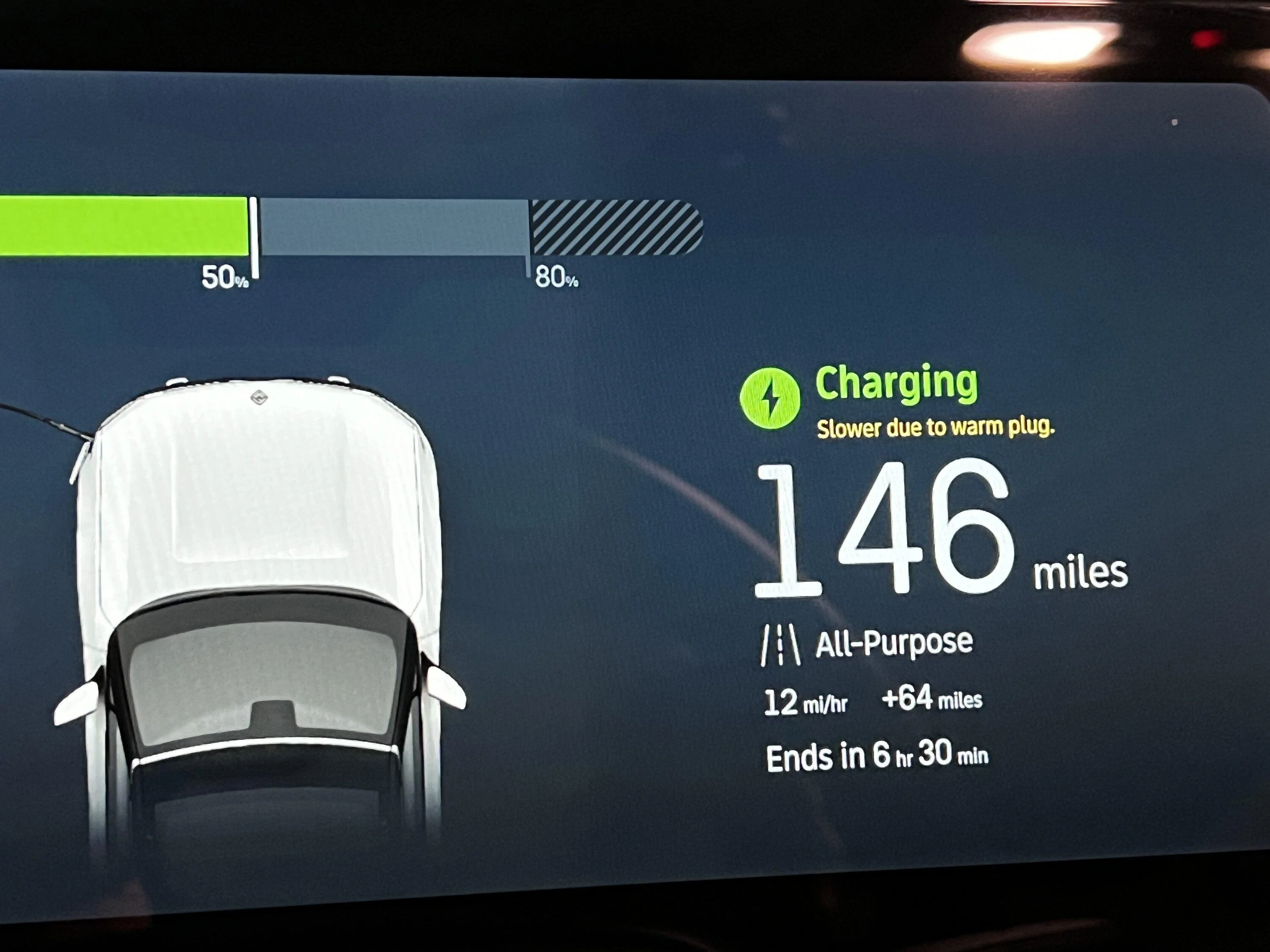

Been getting the same message the past couple of nights. It’s usually parked outside while charging but since I washed it, I’ve been keeping it in the garage. Seems like my garage is too hot for it.

I’m having the same issue. I tried unplugging and letting the plug handle cool. Got back up to 11kw for 20 minutes and then it dropped again. Tried charging at night when ambiant air temp is 60 degrees. After 30 minutes, still get warming and slow charge at lower air temp. 2022 Rivian R1T with Rivian charger. Never had this problem last summer. Problem started this year when I got back from a road trip.
Has anyone found a fix?

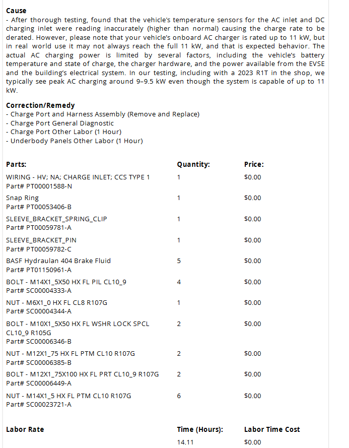

My R1T is in service as of yesterday for this issue. Plus I discovered the rear passenger door trim was coming off due to adhesive failure.
I noticed this morning they tested the charging at least 4x times. In the middle of those tests, they actually re-installed the latest update. Best guess is they are working through the troubleshooting steps hoping it's a SW issue that can be resolved before they go deeper into the HW side of things.
Good news - finally got an R1 loaner! A '22 Forest Green w/ green interior. Offroad wheels. And the camp speaker that won't stop chirping :p
Usually they stick me with Enterprise due to the loaners being all taken. The last one was the Chevy EV which died in my driveway. Lmao. Had to trickle charge the main 12v to get it to come back to life.
I'll post an update when I find out more.

Update.
They had to order a new "Charge Port Harness" and replace that. Then will conduct further testing to validate the issue is resolved.
I'm just happy I wasn't paranoid 😁

I'm back home after picking up my Riv.
They replaced the entire charging harness and since they had to dig into the vehicle, they had to do an alignment afterwards (included in the warranty).
They did note the temp sensors were reading inaccurately. These were part of the replacement.
They had me adjust the charge % to 100 when I got home and plug her in. So far she's holding steady at 11 kW at an ambient temp of 78*F today in Austin after a 25 minute drive home.
I'll keep an eye on it and report back in a month or so if the problem is fixed or not. Pending on weather conditions. They also did the knuckle fasteners (again? - could have sworn they already did these at an early visit).
Window trim has also been replaced successfully
