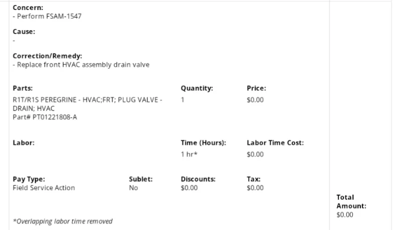

FWIW, there's an FSAM for it. I didn't request this, they added to my upcoming appointment.
Rivian R1T R1S Smelly A/C? 1000002094

Thank you for the heads up. Have they attributed this drain plug issue to the smell. Will they also perform a cleaning when they fix to eliminate the residual mold?
No idea to either, I'll ask questions next week.

They are likely replacing the plug to address the issues they have had with water getting into the floorboard of the vehicles. Of course, moisture doesn't help reduce smells so a better drain valve certainly can't hurt.
