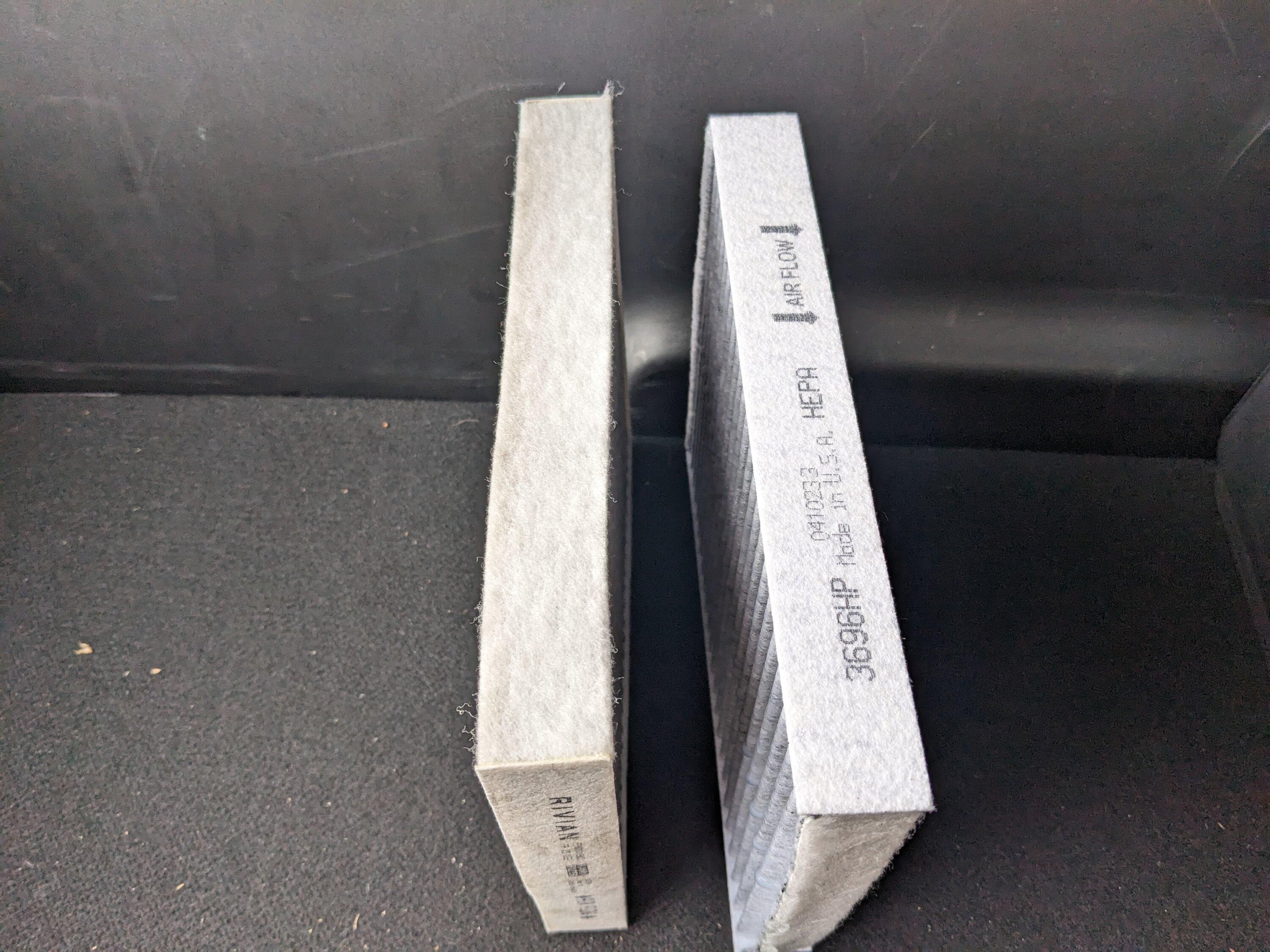

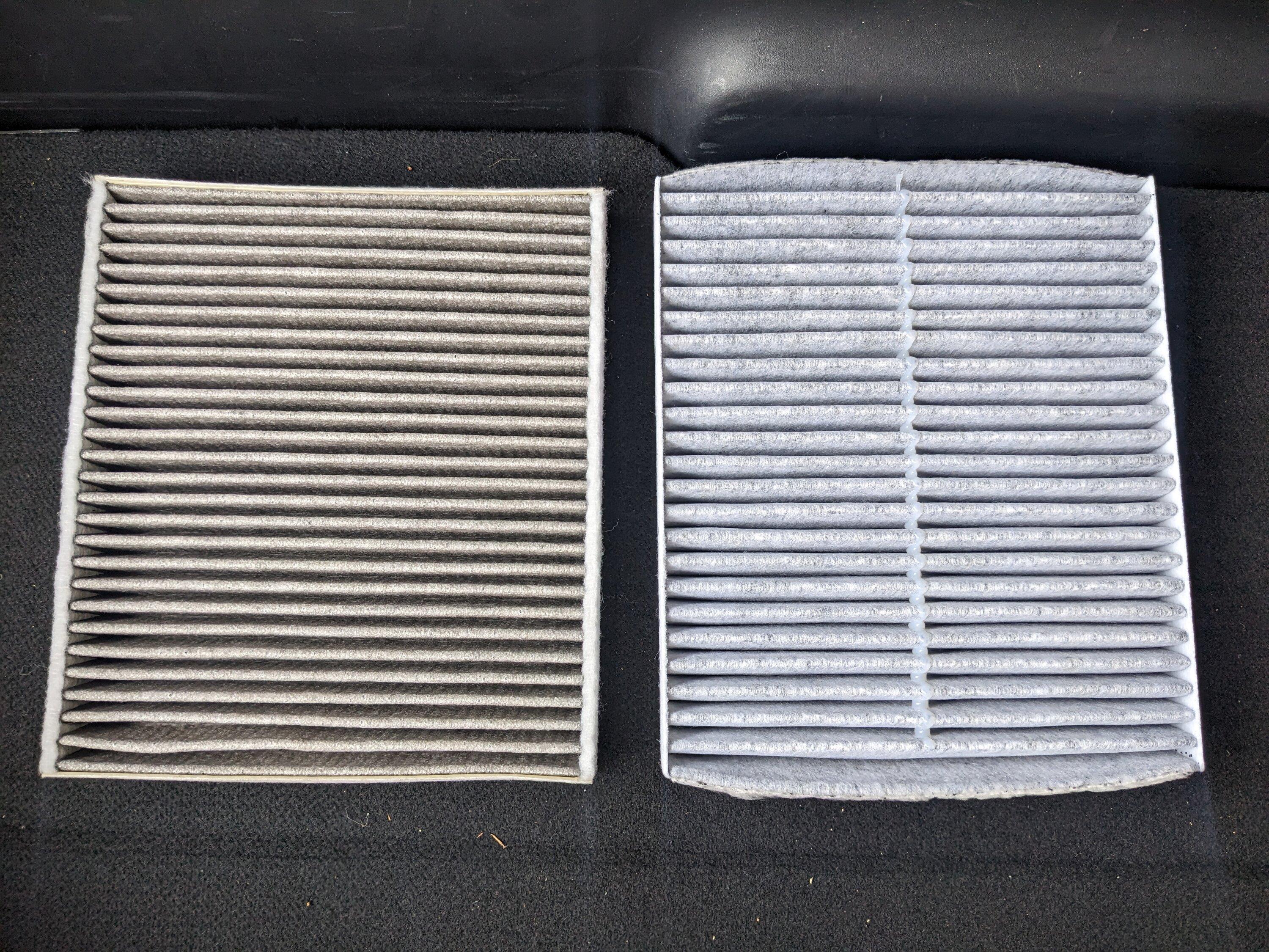

$35? Shipped from service center? Come on, Rivian...
It measures 230 x 200 x 30 mm. I think this is the OEM filter:
https://catalog.mann-filter.com/EU/eng/catalog/MANN-FILTER Katalog Europa/Vehicles/CARS + TRANSPORTERS/INFINITI/Q50 (V37)/2.0 Turbo M274 (T00000000813215)/Cabin Air Filter/CU 23 003
This is the closest I've found, belongs to an Infiniti Q50 and others:
https://size.name/en/products/ac206j
I'm going to pick this up local today and try it:
https://www.oreillyauto.com/detail/...2/microgard-hepa-cabin-air-filter/mgd4/3696hp
It fits! $30 after taxes here, can get wherever.
