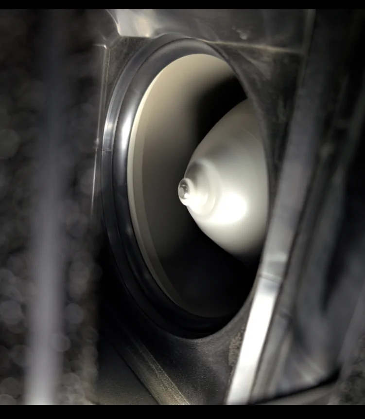

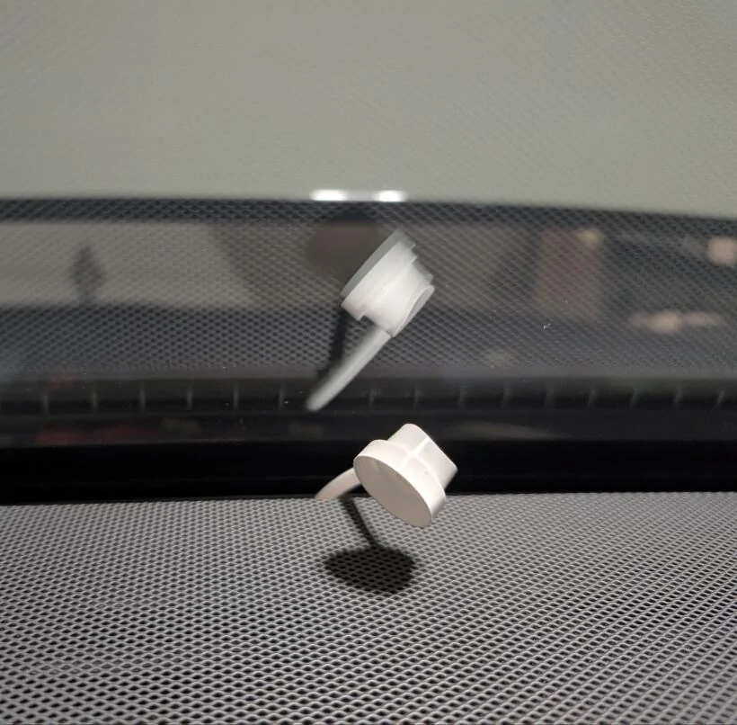

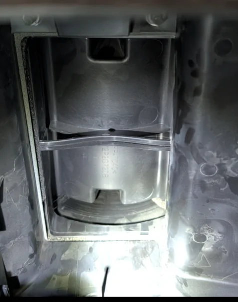

In an attempt to get directly at the evap coils, I dug in the front and found this.
Intake is closed when off (duh)
Rivian R1T R1S Smelly A/C? 1000001429
Intake only opens halfway when on, regardless of fan speed. I tried opening more by hand, there was resistance, so I didn't force it.
Rivian R1T R1S Smelly A/C? 1000001428
Blower running.
Rivian R1T R1S Smelly A/C? 1000001427
I assume the evap coils are beyond the blower, but I can't get to it when it's off because the intake is closed. Again, prying a little by hand, it didn't want to budge so I didn't force it open.

@mudito when you did this, where did you see the dripping from? I might start pulling panels to see if I can find the drain hose and connect to it. I like the Toyota way:

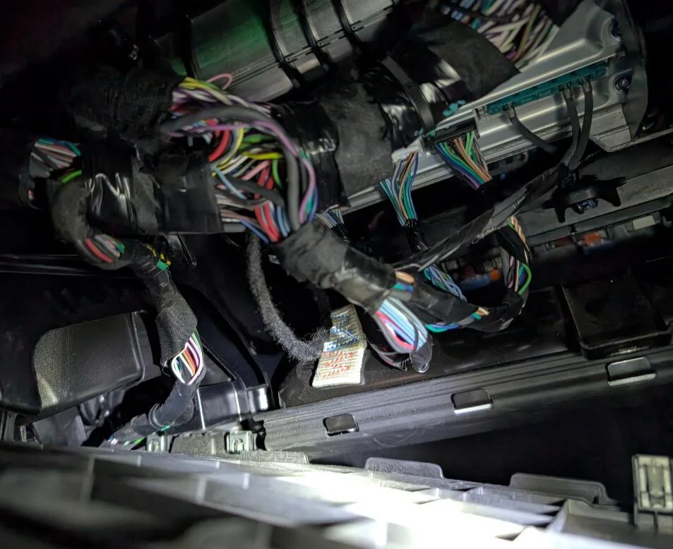

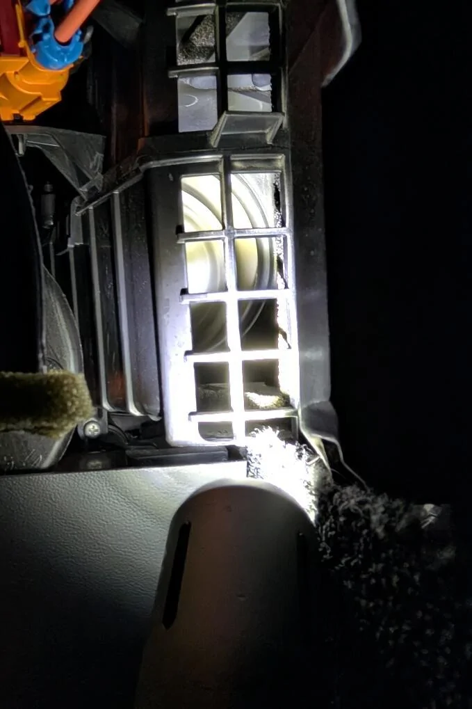

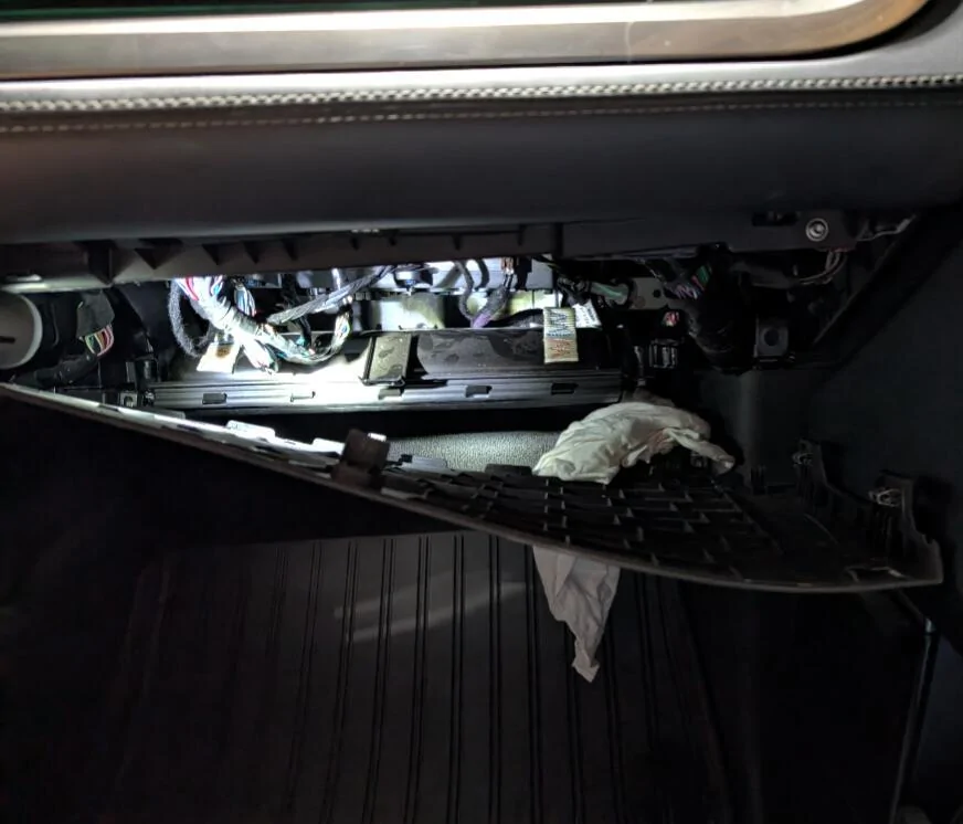

Well, I just did this and learned quite a lot. Most importantly, DO NOT DO THIS YOURSELF. DO NOT SHOVE TUBES INTO VENTS AND START SPRAYING.
I'm kind of mad at myself for doing this now. I'm very much a DIY person, but I risked royally fucking up the electronics following these instructions and videos. They work for conventional cars and where you can access the blower/evap easily. NOT Rivians.
Highlights:
-Sprayed myself in the face a couple times trying to shake the can and the tube popped off
-Fluid started dripping out under the dash below the vents
-Learned how to pry off the under dash plastic
-Found the passenger fuse box
-Zero dripping underneath the truck, which is even more concerning
Rivian R1T R1S Smelly A/C? 1000001438
Rivian R1T R1S Smelly A/C? 1000001437
Wish me luck reassembling. This is not what I wanted to do on my Sunday.

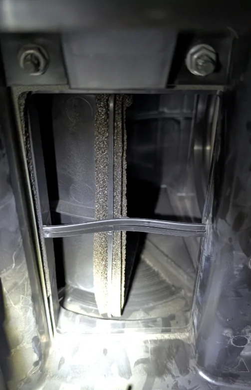

Underdash is back together. I found the other side of the blower intake. I didn't think to turn off the fan when I was under there, but if this stays open when you turn the fans off, it may be a way to get through the blower.

Just saw all this @Riviot . As I stated, I stuck it into the vents and pry it back/forth until it went very deep into... Somewhere? I might have been lucky and got the tube past the blower or no idea really.
The dripping part is interesting since I had an "oh shit moment". I heard dripping for a few seconds with nothing visible on my garage floor, but the noise was there. Then I pulled my truck out from the garage to the driveway which has a SLIGHT incline and then everything dripped from underneath.
I tried to see if I could spot a tube or anything from the underneath but I couldn't, might be routed/protected in a weird way.
