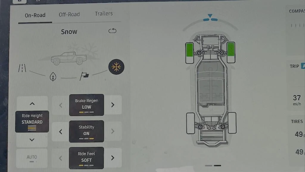

Snow Mode--still too much regenerative braking

The regen was also causing some issues for me and I really, really had to be cautious with it on HWY 100.

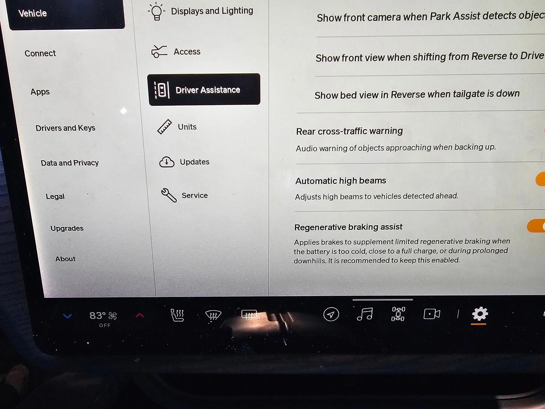

It may not disable regen entirely, but it's weaker in the cold. If it feels the same to you, check that regen braking assistance is not turned on. With it on, the friction brakes will be blended in to offer similar braking performance to full regen, even if it's freezing.
Are you saying make sure it is at the lowest level on the Snow mode screen or is this a separate toggle in settings somewhere?

Below about 10mph ALL regen goes to the front wheels. This results in the front wheels locking up making it impossible to steer.
That would explain why I was sliding and unable to steer
I just checked and I do have Regenerative Braking Assist on. I assume that antilock is active to the extent the brakes are used.
That'd be my guess as well. I wonder if regen ABS is superior to friction brake ABS in super-low traction situations? Heck, I wonder what regen "ABS" feels like.
