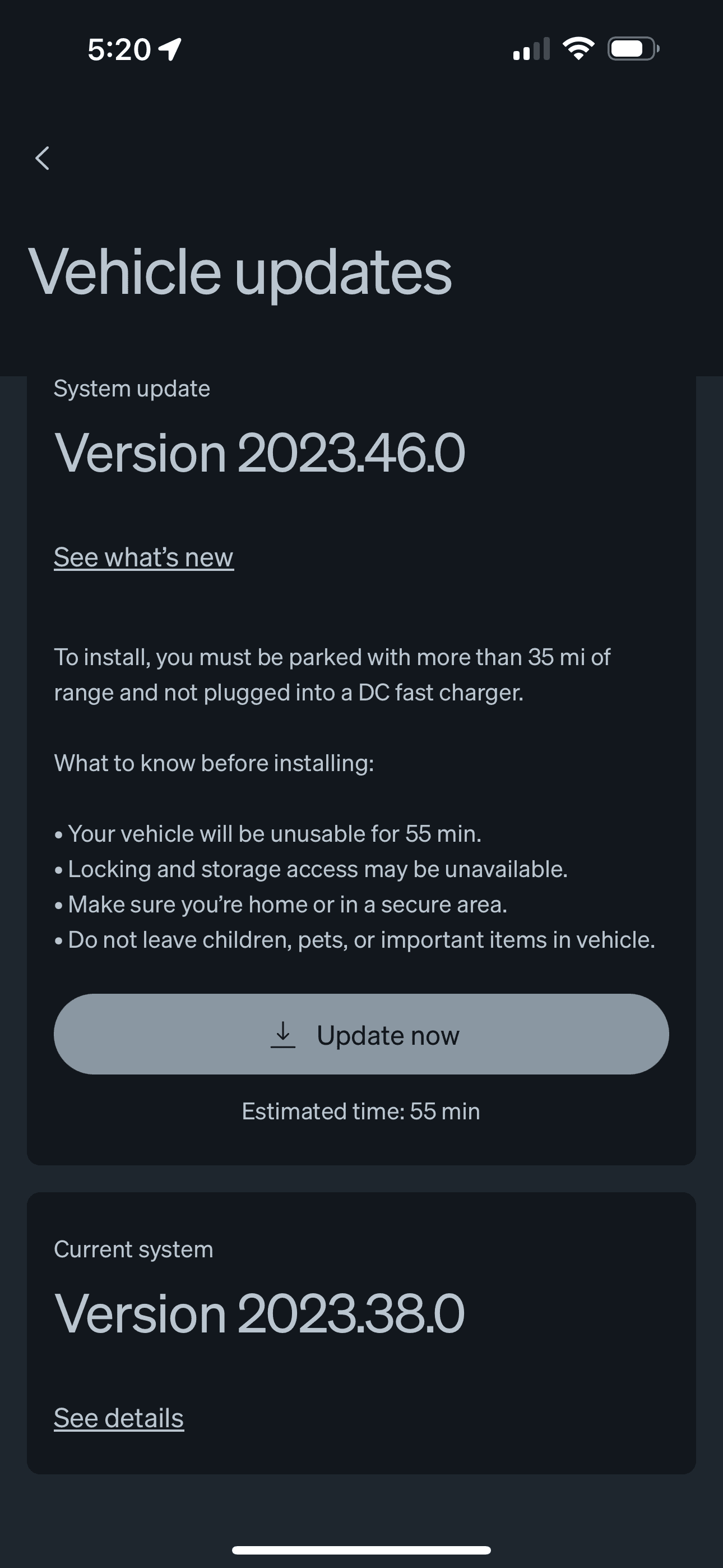

I updated the software to 2023.46.0 and
  • Total voters
    290
  • Poll closed .
