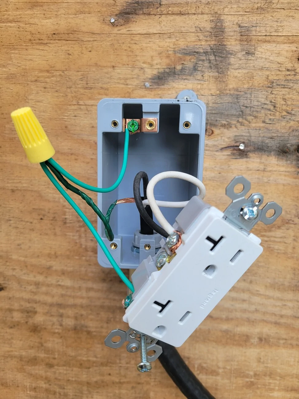

I made a change to receptacles - neither were grounded to the plastic box, and so with pigtails I did that.

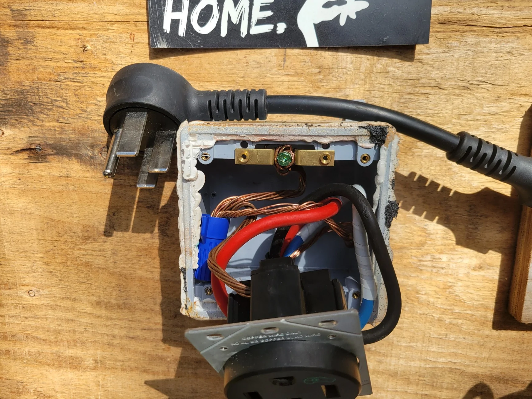

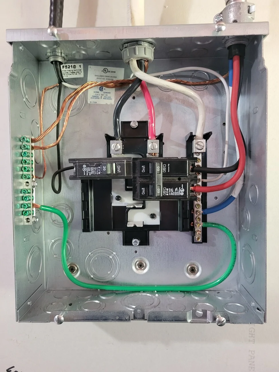

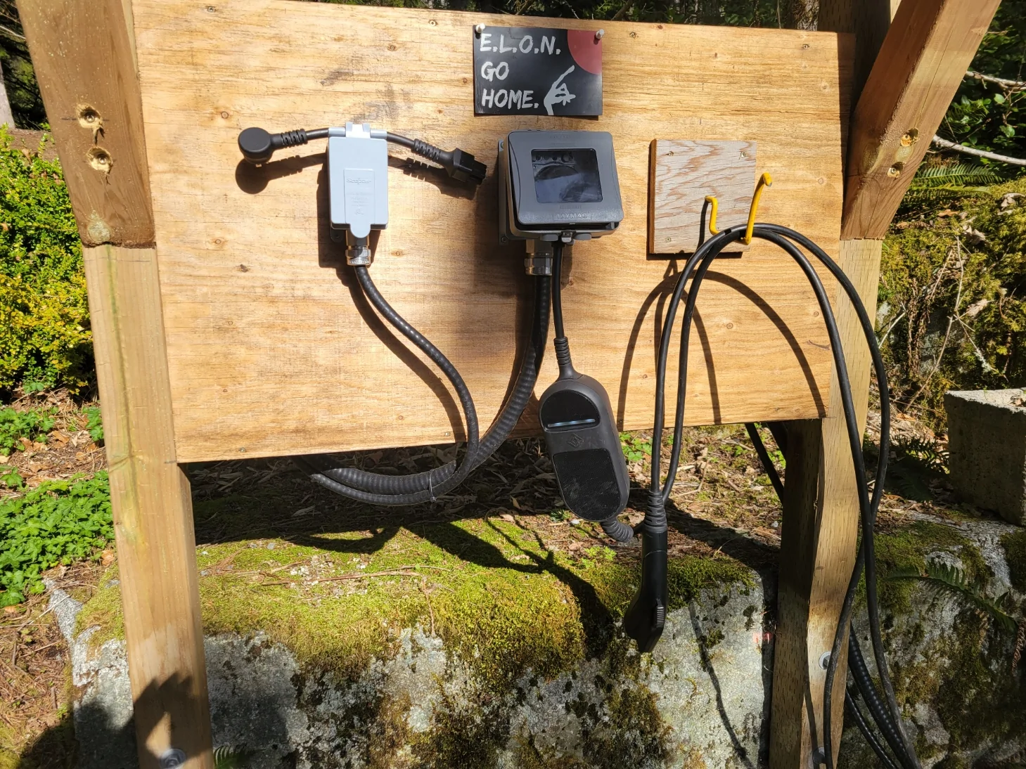

Rivian R1T R1S Solid RED light after partial charging with portable charger... 20260419_165451
Rivian R1T R1S Solid RED light after partial charging with portable charger... 20260419_122820
Rivian R1T R1S Solid RED light after partial charging with portable charger... 20260419_141300
Rivian R1T R1S Solid RED light after partial charging with portable charger... 20260419_155151
Photos of the charging kiosk with the two receptables, the service panel, and the two receptacles, in case that is helpful.

It looks like you have a 60 amp breaker for the NEMA 14-50 socket. I’m not sure if that is a good idea. Also, the wires connected to the 60 amp breaker look undersized in the picture. It’s hard to tell, but letting the forum know what the markings are would be helpful.

If you're using the portable charger and it will allow all night at 110V, another possible failure point is the 240v pigtail. If you're not mounting the portable charger and instead letting it hang, the pigtail connection will gradually loosen. If the 110v is fine, it is because you rarely use that pigtail and it has a more solid connection.
@Ceejay - Did you read the above comment and understand it?
Your image shows exactly the problem this was warning you about. Your portable charger is hanging from the pigtail. That heavy charger body pulls down on the pigtail, and the connection between the pigtail and the charger body gradually over time separates and causes charging errors.
This is not theoretical. It happened to me many years ago, I figured out what happened and fixed the issue by hanging the charger body on a screw (as designed and as recommended in the manual). I haven't had the problem since. I have called out this exact problem for years. For example:
The portable charger comes with two short adapter cables - one for NEMA 5-15 and one for NEMA 14-50. These short cables plug into the portable charger body. And because they plug in, they can also pull out of the body.
If you suspend the portable charger body from the outlet with no strain relief, then the short adapter cable WILL become separated over time. DON'T MOUNT IT THIS WAY, just dangling from the outlet.
The fit is tight enough that it will work for a while if it's just dangling there, but if it's hot out, the rubber softens, and it may be that it becomes easier to separate. Regardless, the weight of the portable charger body pulling down will eventually cause the body and the cable to separate just slightly, enough to trip the GFCI.
The portable charger body is designed to hang from a screw. Make sure you mount it properly and don't just let it dangle from the outlet. And if you're using the portable charger on the road, say at a campground with a hookup, then bring a bungee of some other method of providing strain relief for that junction between the adapter cable and the charger body.
Is this definitely the problem? I don't know. But @Mellowyellow gave you excellent advice, please heed it.
yes thank you, I have played around with suspending the 'body', and I don't think this is my issue, but I will be mounting the 'body' on a screw
hi thanks, yes that is a 60A breaker for the 240v circuit.
The wire to the 240v breaker is Teck 6/3.
Thanks for your interest.
I am able to charge again this morning on the 240v set at a low current (16A). We'll see how it goes, but I am planning on reaching out to an electrician today to get a look over.

@Ceejay Thanks for the reply. Hopefully an electrician can figure out the problem. They will probably at least recommend you replace the 60 amp breaker with a 50 amp. If it is replaced with a GFCI breaker you may run into new problems.

Remove the Green #10 wire. Do not bond the neutral bar to the ground bar in that sub panel. That is electrifying the box, the car and everything else along the way with return current. Less safe than without the bond wire. Things may work differently after that. Possibly better if the rest of the grounding is proper.
Technically the sub panel should also have a ground rod or two, as well as the return ground lead to the main panel. Don't underestimate how effective/important grounding is.
A heat rated 60A breaker works with heat rated #6 though the outlet isn't rated for that even though it's an "EV rated" one. You likely won't ever go beyond 32A. I know why people do this, in case they add a hardwired unit later. There are other issues like it's not GFI and using damp boxes where wet should be but they aren't adding to your current issue.
Thank you. Have asked an electrician with a similar set up at his house to pop by in the next day or two. I'll raise your ideas with him.
