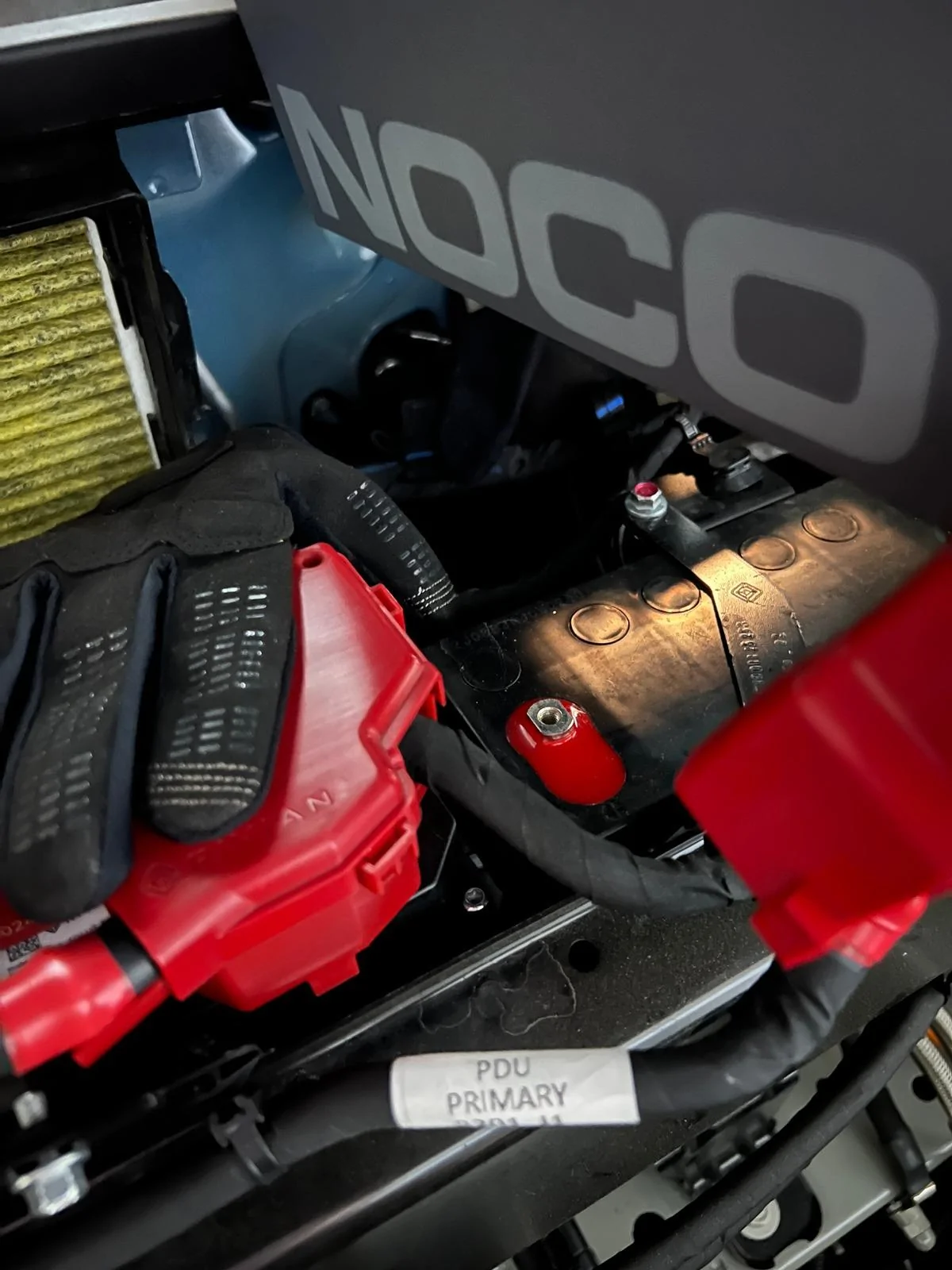

I ended up buying a battery charger and fully trickle charged my 12v to where it's now measuring ~13v. Only problem is I noticed what looks like a red liquid that seems to have leaked out of the positive terminal during the trickle charge session. I tried to wipe it up but it's completely hardened.
What is this/is it something I need to be worried about? I'm planning to hook everything back up in the morning to see if I can unlock the car and maybe get it started, but am concerned by this leakage.
I kind of think you’re just playing us now.
That’s what the batteries look like. https://www.rivianforums.com/forum/threads/what-i-learned-from-my-12v-battery-swap.13739/
Perhaps OP just never noticed it until after charging.....? OP has said this is not his wheelhouse.
Even if you did get a charge into the battery, it's highly unlikely to hold a charge for long since it was down to a few volts. Big lead acid batteries can sometimes be recovered, but these little guys have no tolerance for abuse, especially what appears to be a bargain basement brand that Rivian used.
