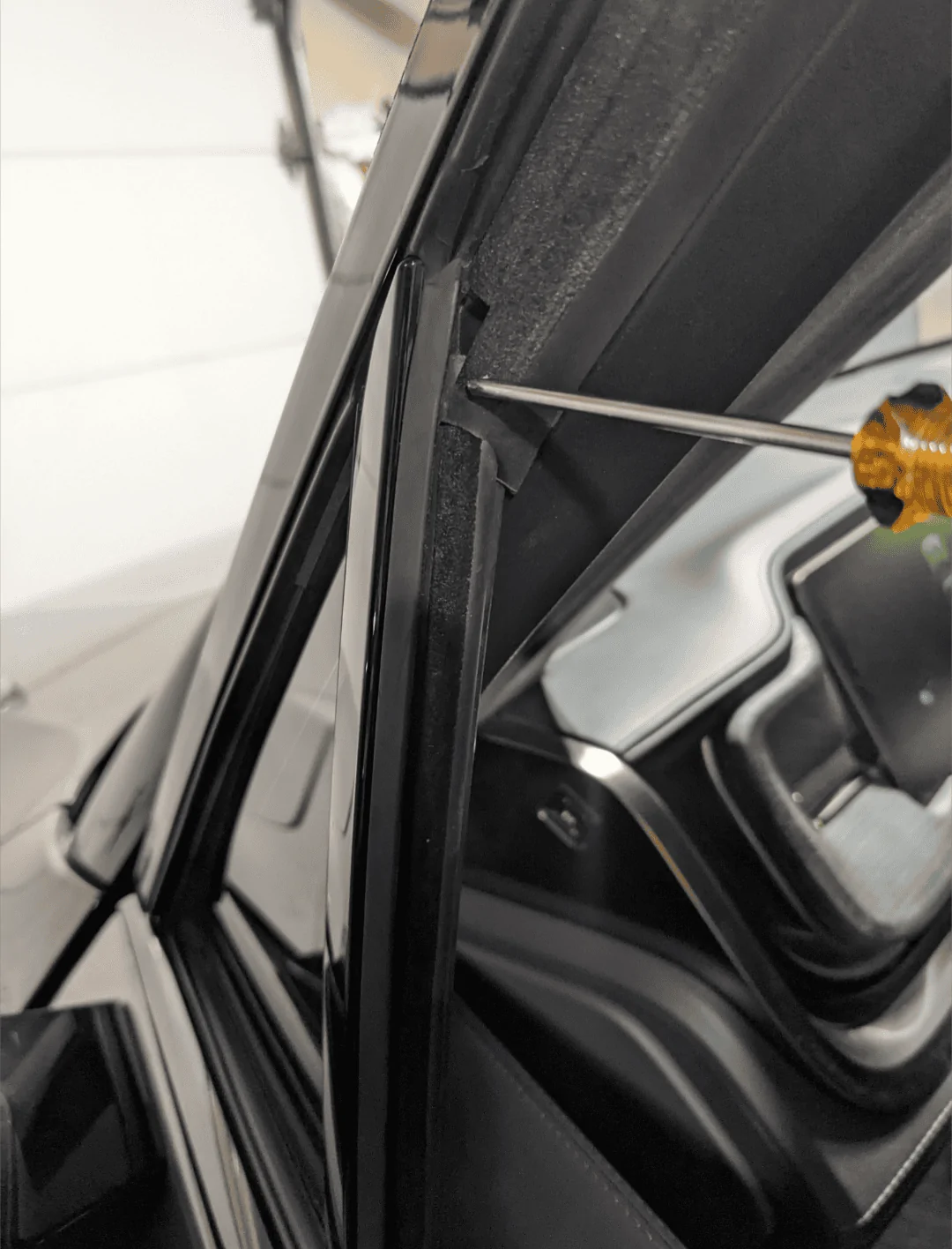

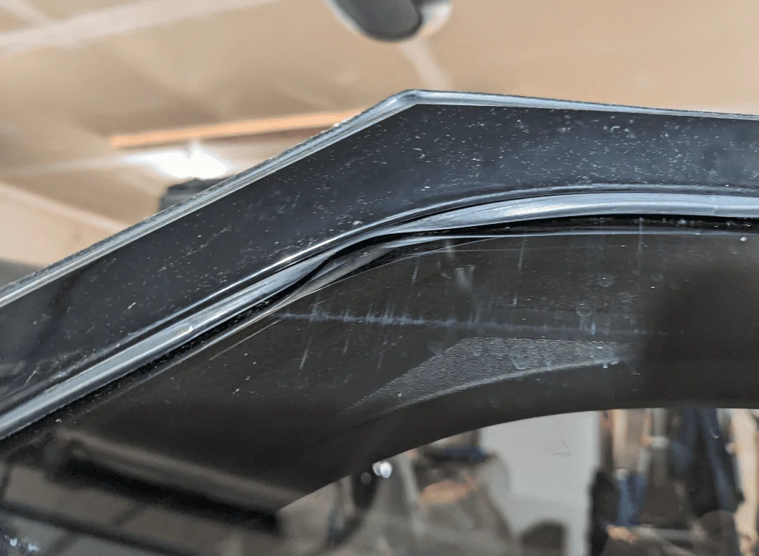

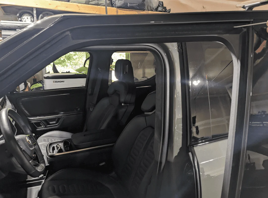

just to be clear when I say tucked in the existing seal, I mean like this

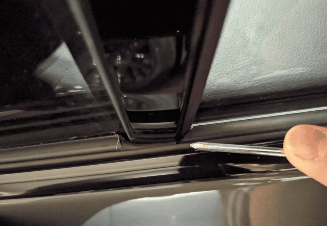

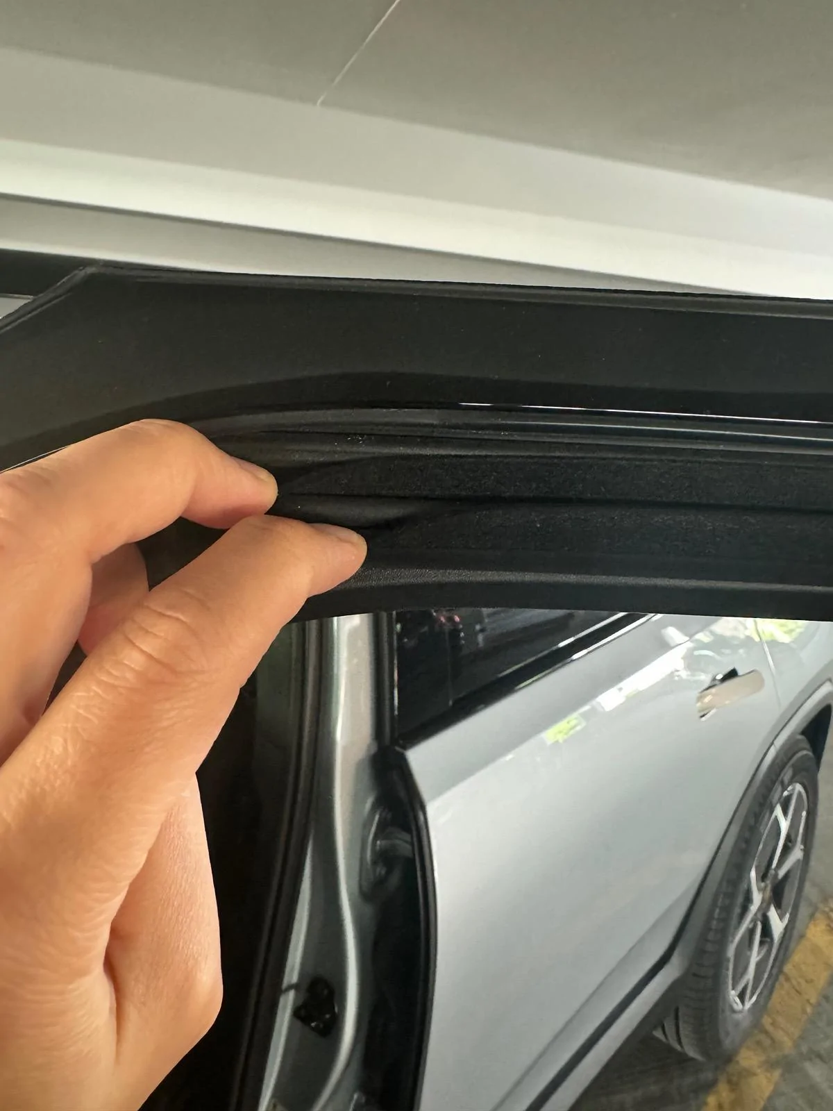

When I did both layers, I had the same difficulty with the window going up, so I removed the top one and it closes fine. My trim-lok on the sides shift around if the window makes contact with it, even tucking it in real good using proper trim tools. I jammed some more pieces around little openings here and there. But what I found was the worst was this ...
Rivian R1T R1S Guide: R1S / R1T Wind Noise FIX! 1000010843
The rubber seal on the door is getting jammed. I tested the window after only one line of trim-lok and noticed it, so I pulled it out, and it still jammed with nothing in there... So I'm wondering if I had this issue beforehand and that's been my noise source. Either way, I had to use my trim tool to keep it from jamming the seal.

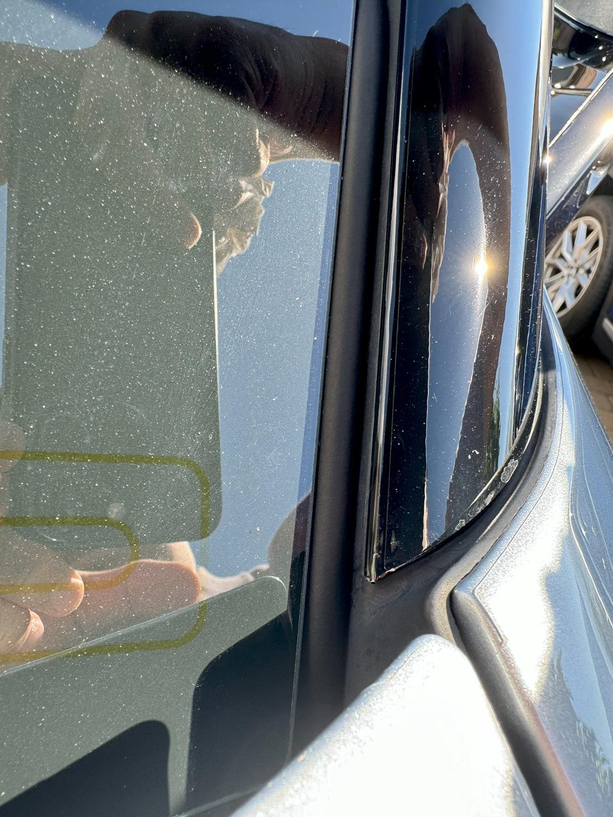

if you're having wind noise coming from above, it actually may be generated by the crevices of the windshield.
try putting some round rubber seal along the vertical sides of the windshield (blue in my picture). I used uxcell 8mm (0.31inch) to wedge in the gap
you can also try putting a flat weatherseal or a t-shape across the top of the windshield where it meets the chrome fascia (red).

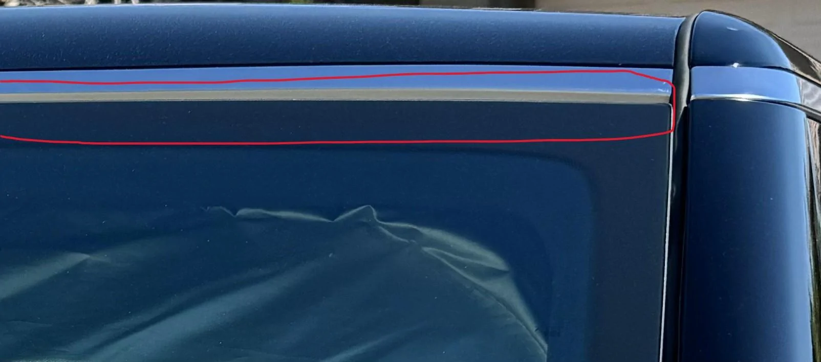

Can you please share pics of your red areas and size used? I think I’m hearing wind in these areas. Thank you.
ne0phyte
ne0phyte
May 15, 2024
133
Nevada
2024 R1S Max Pack 21' Road Wheels
As always, save some money by first putting some painters tape over the areas and see if that improves the windnoise.
If it does, the item you want to get is:
https://www.amazon.com/gp/product/B0BYSNVCFS
one item is enough.
it is a "T" shaped strip and is a 2 pack with a 14mm size and 19mm size
The 19mm size can be used to bridge the gap at the top of the windshield (see picture)

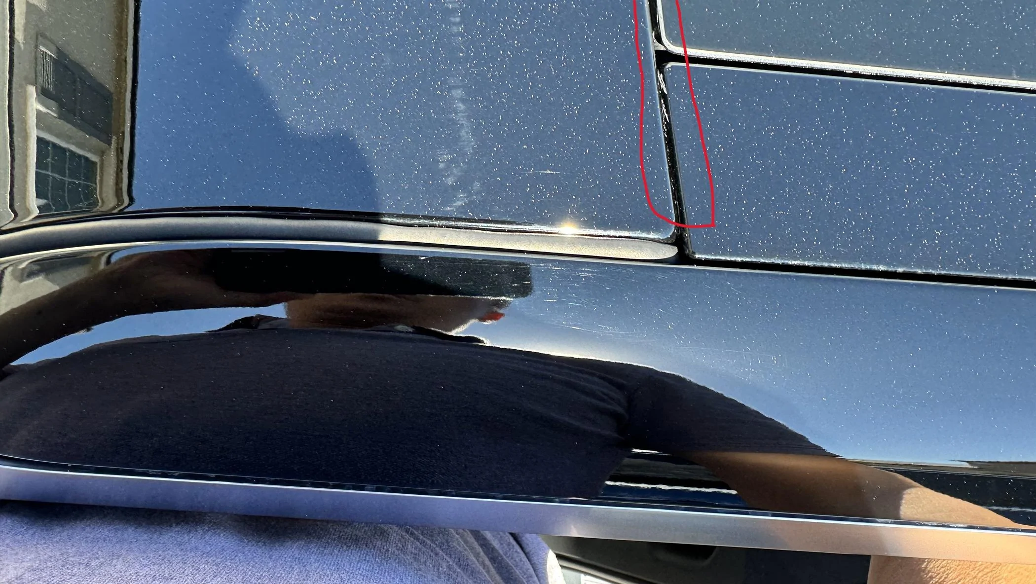

The 14mm size can be used to bridge the gap on the top of the roof (where the applique meets the moonroof glass), or you can use the 0.25inch trimlok round seal to wedge it in
Rivian R1T R1S Guide: R1S / R1T Wind Noise FIX! roof insert
For me, those areas didn't make a difference, which is why you don't see it in the pictures.

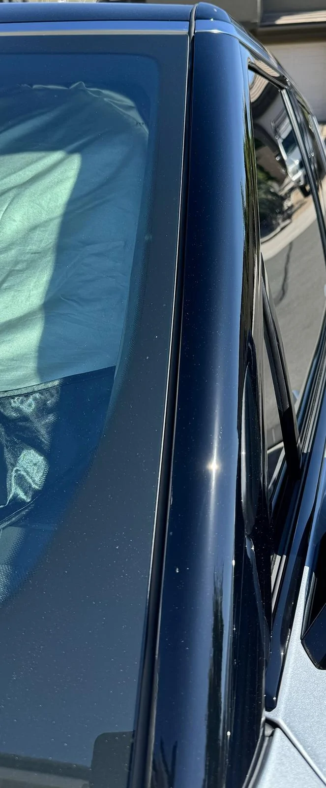

What did help me a little more is the vertical strips of the windshield. I used 8mm (0.31inch) uxcell round seal (https://www.amazon.com/uxcell-Rubber-Weather-Diameter-Meters/dp/B07ZNH29FH)
along ther vertical strips and tucked them in at the bottom and up at the top. for me, that made the car very silent. My wife says the Rivian is now quieter than the BMW!
Again, you may have to experiment with the sizes, as other posters on this thread have reported my sizes are too big or too small - which shows that Rivian hasn't gotten to the level of consistency that other legacy manfacturers have reached.
Good luck!
