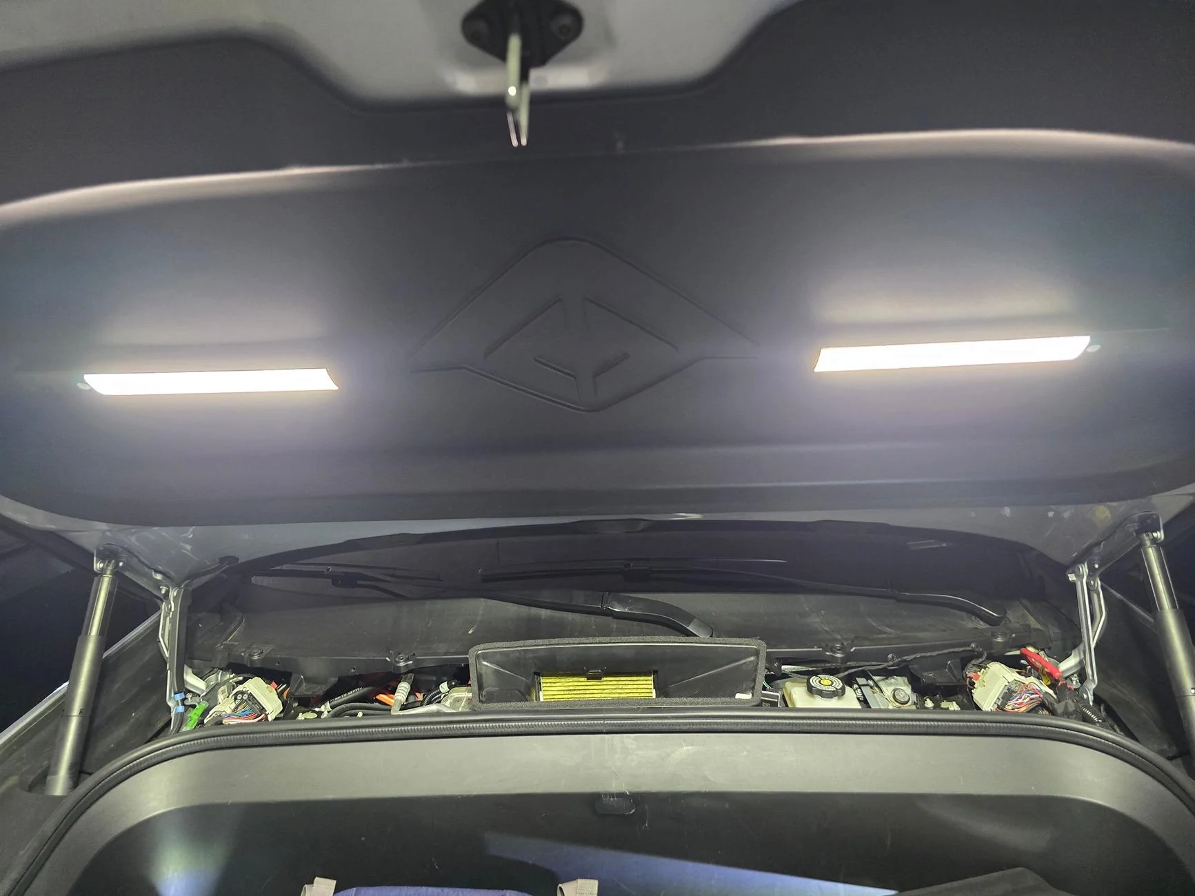

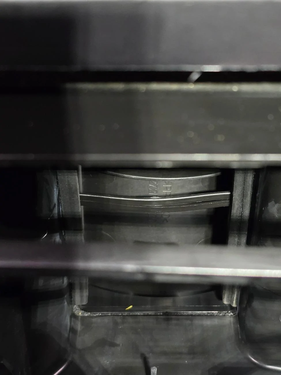

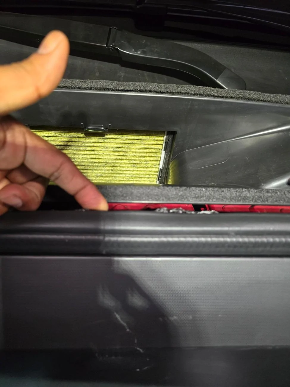

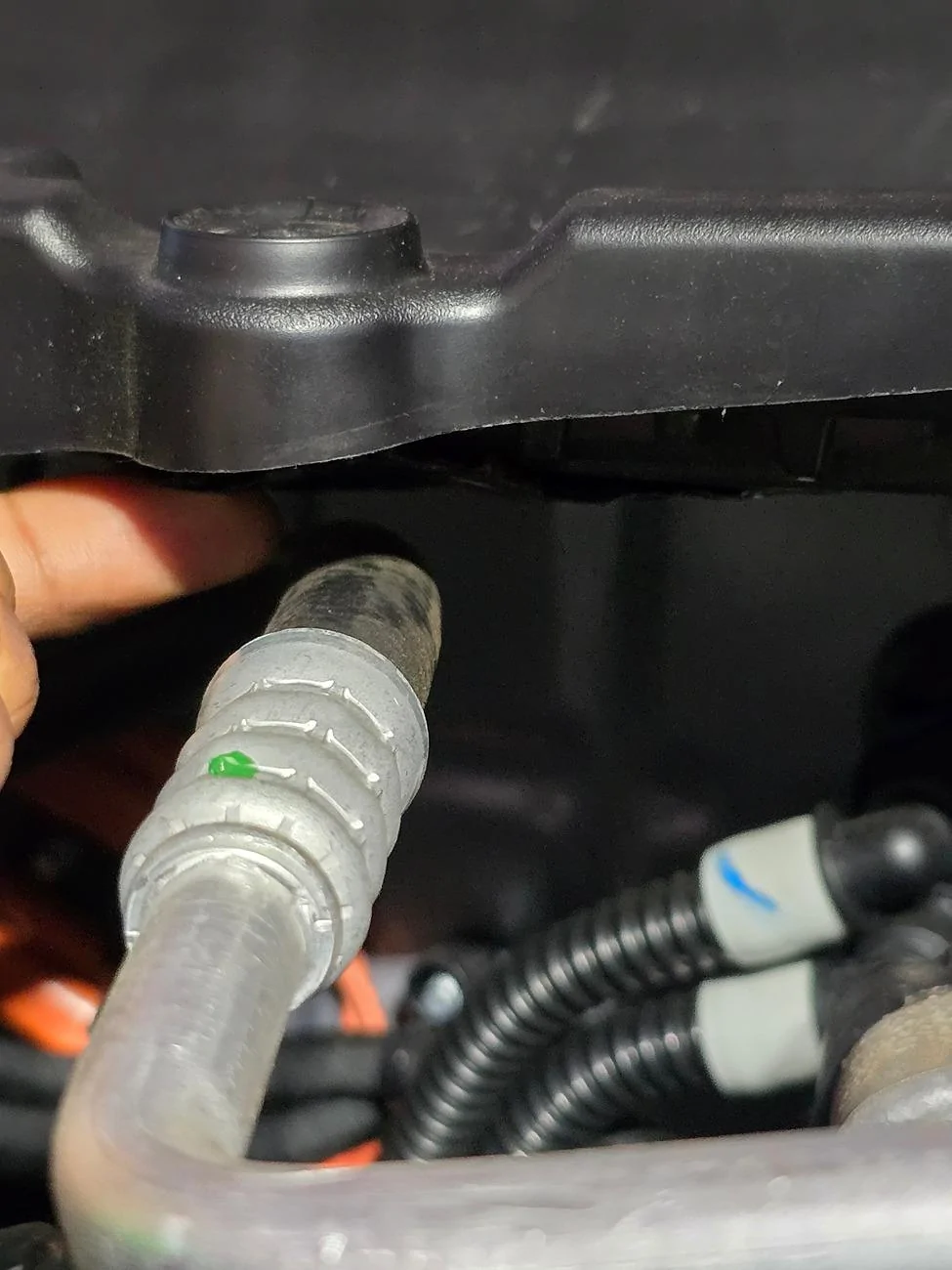

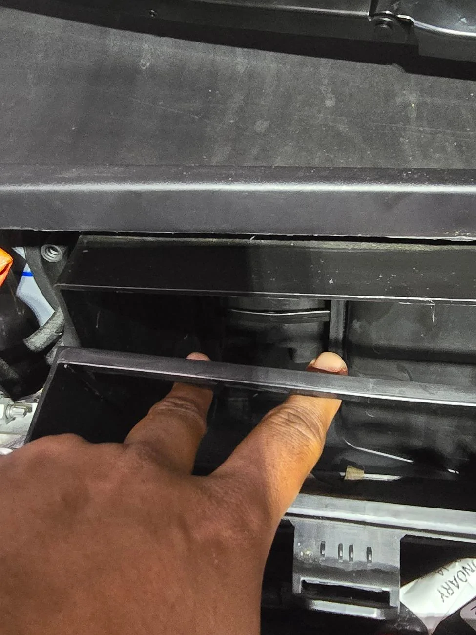

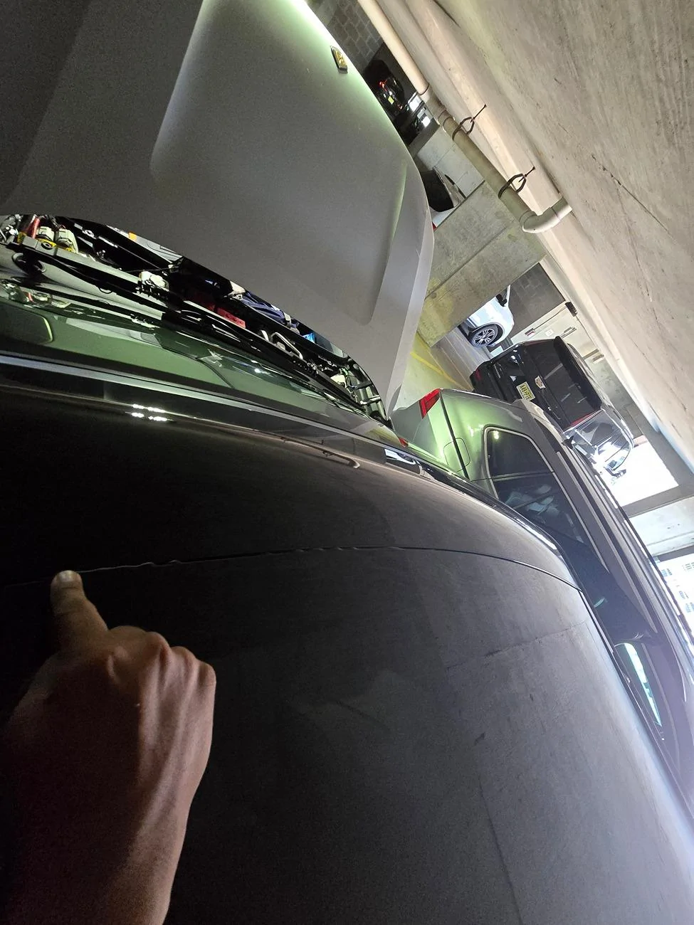

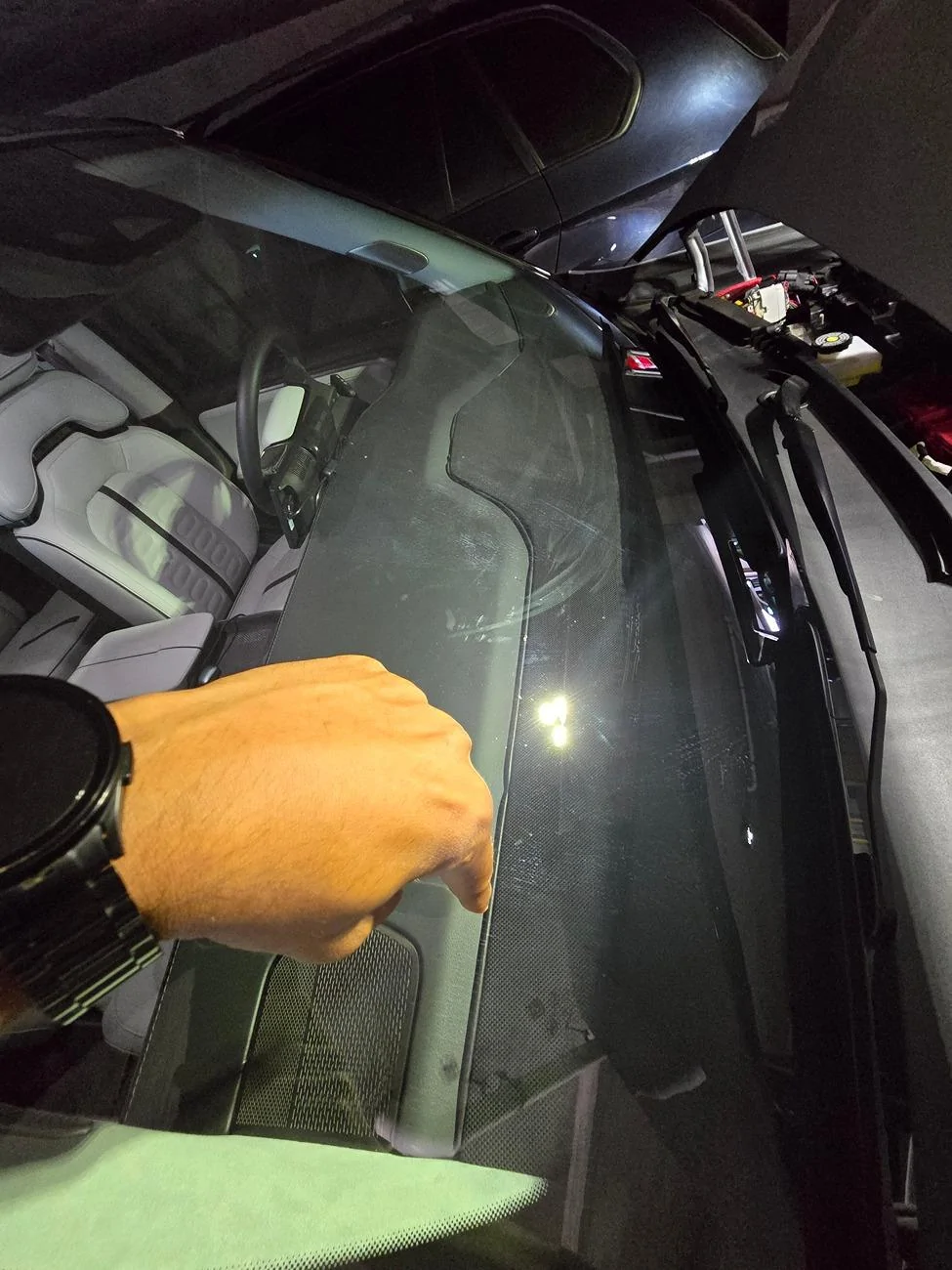

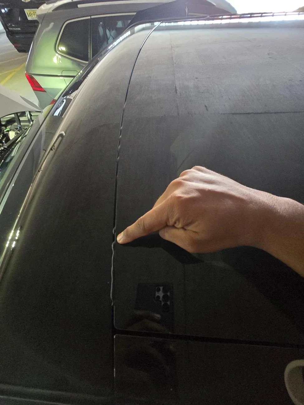

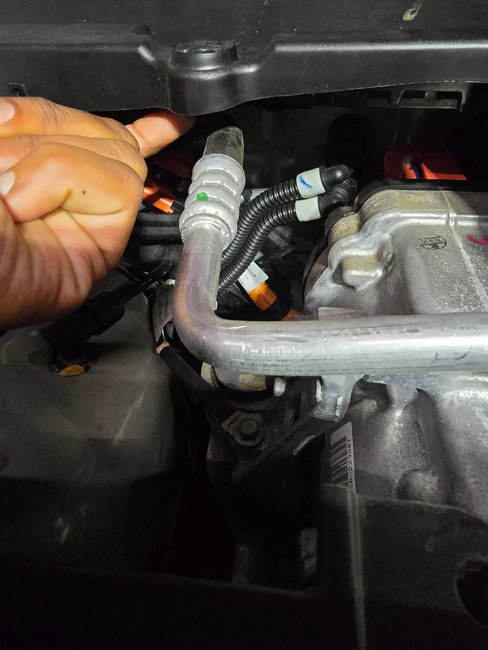

More pictures and data points as mentioned above.
Pictures refer to the following
- dynamat piece near air filter cover
- dynamat piece near air conditioner
- uxcell 4mm rubber seal dash side between the leather and plastic (where some may have had rattles)
- rubber seals vertically added two sides in the plastic housing where the air filter resides
- uxcell foam (4mm /5mm/ 6mm) in some seams top sunroof side in place of rubber seals or T shaped magnetic seals.
Rivian R1T R1S Guide: R1S / R1T Wind Noise FIX! 20240716_123830
Rivian R1T R1S Guide: R1S / R1T Wind Noise FIX! 20240716_123458
Rivian R1T R1S Guide: R1S / R1T Wind Noise FIX! 20240716_123900
Rivian R1T R1S Guide: R1S / R1T Wind Noise FIX! 20240716_123835
Rivian R1T R1S Guide: R1S / R1T Wind Noise FIX! 20240716_123726
Rivian R1T R1S Guide: R1S / R1T Wind Noise FIX! 20240716_123507
Rivian R1T R1S Guide: R1S / R1T Wind Noise FIX! 20240716_123444
Rivian R1T R1S Guide: R1S / R1T Wind Noise FIX! 20240716_123614
Rivian R1T R1S Guide: R1S / R1T Wind Noise FIX! 20240716_123604

tate16t
Robert
Apr 7, 2022
66
1,426
1,192
NY
2023 El Cap Granite R1S
Car Enthusiast
Did you notice a big difference in wind noise reduction after installing the foam in the seam along the top sunroof? This is where I believe I have the last bit of wind noise, coming from top front roof area. I did not have a chance to address it yet.

akc5247
AKC
Dec 28, 2023
322
252
NJ
2023 Subaru Ascent Touring, 2024 R1S dual motor
I just returned from long drive with my wife’s Telsa and wow, the Rivian is so much quieter and smoother. Driving them side by side uncovers the disparities.
I definitely notice the difference since I added it.
I still have a bit of area left in the seams in the middle of the large sunroof area to cover, waiting for the seals to come from Amazon.
So to clarify, you put dynamat around the plastic funnel/intake piece for the air filter? Did that make a difference? I guess I didn’t realize that’s how the ac compressor noise was getting through.
akc5247
AKC
Dec 28, 2023
322
252
NJ
No, no. I did not put any dynamat around the air filter. I put piece of rubber seals (two of them, vertical) in the air filter housing.
Dynamat was only on top of the tube near the air conditioning unit. And across that area, and not around the pipe, but just above it.
