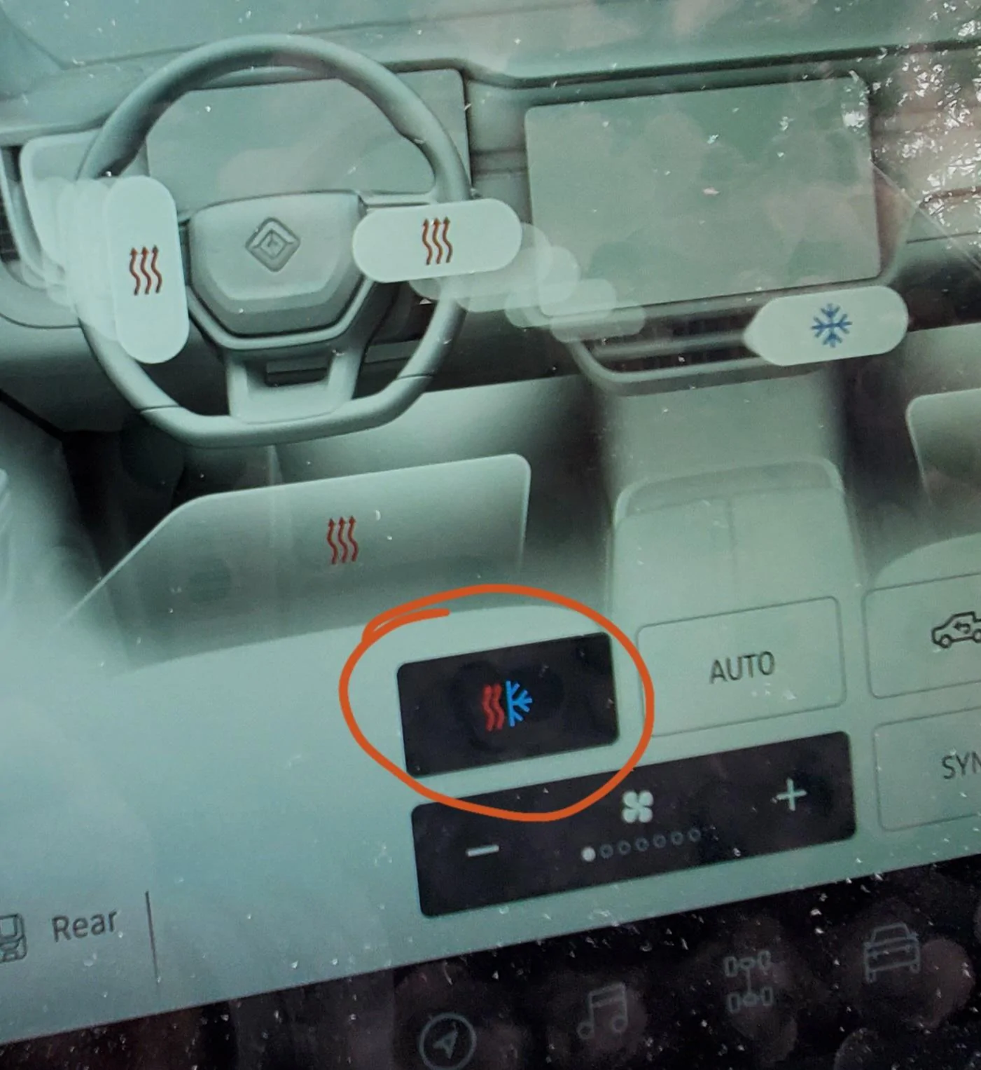

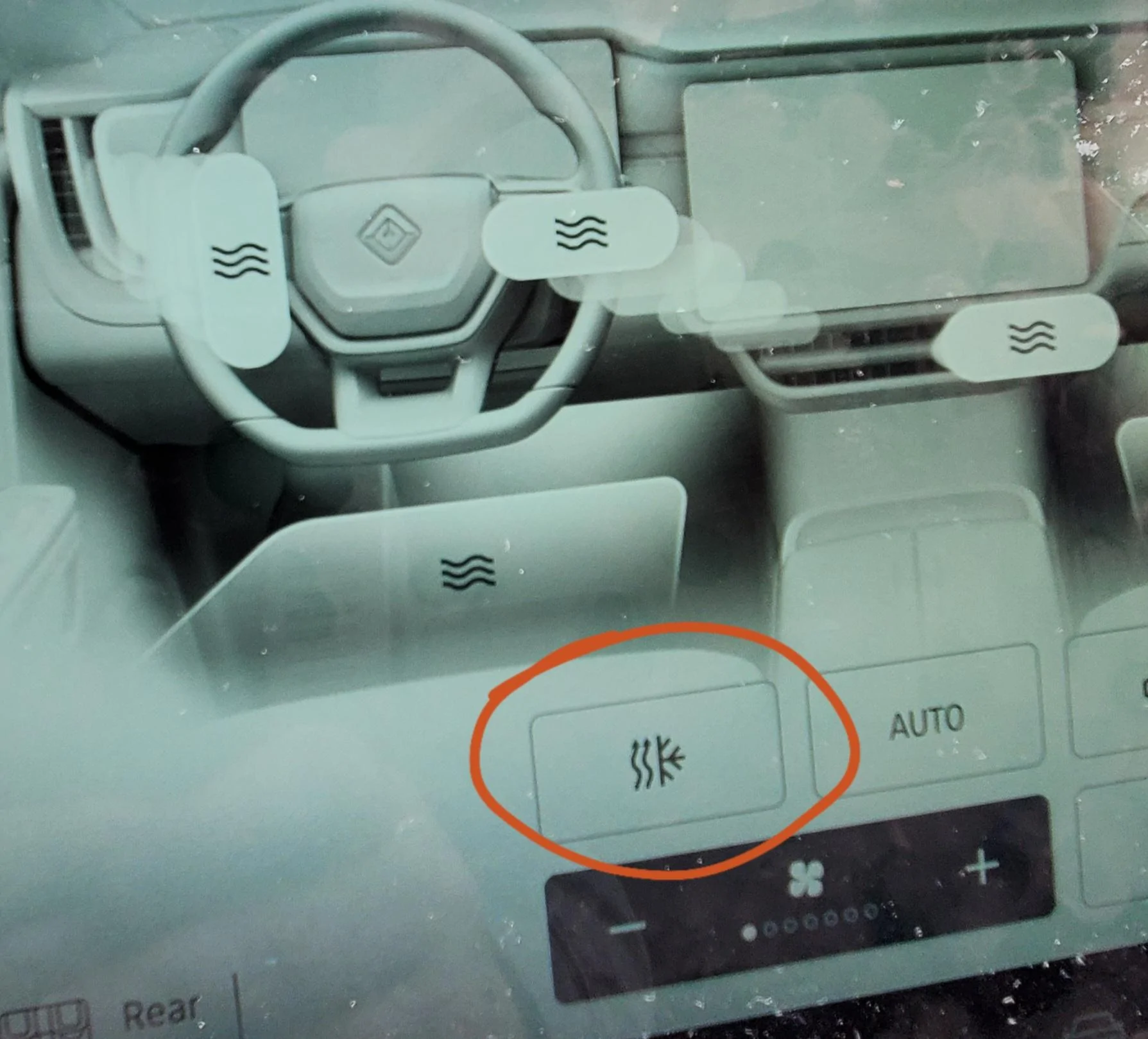

I suspect your ac/heat weren't on. Got me the first day or so. Press the button highlighted below.

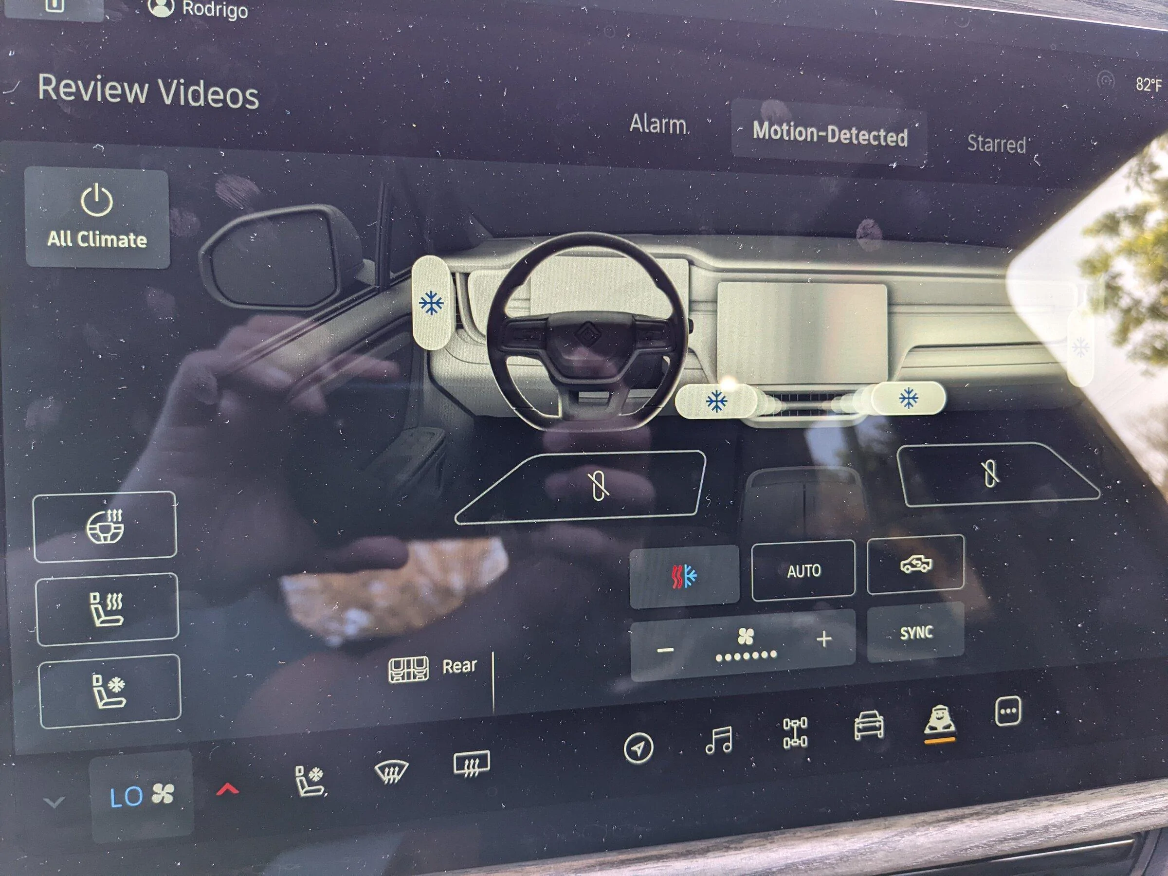

@godfodder0901 thanks! I do have it activated, I had a support call and they suggested to reset the car, but still same issue. They will submit a ticket to the tech team and will get back within 24 to 48 hours.
