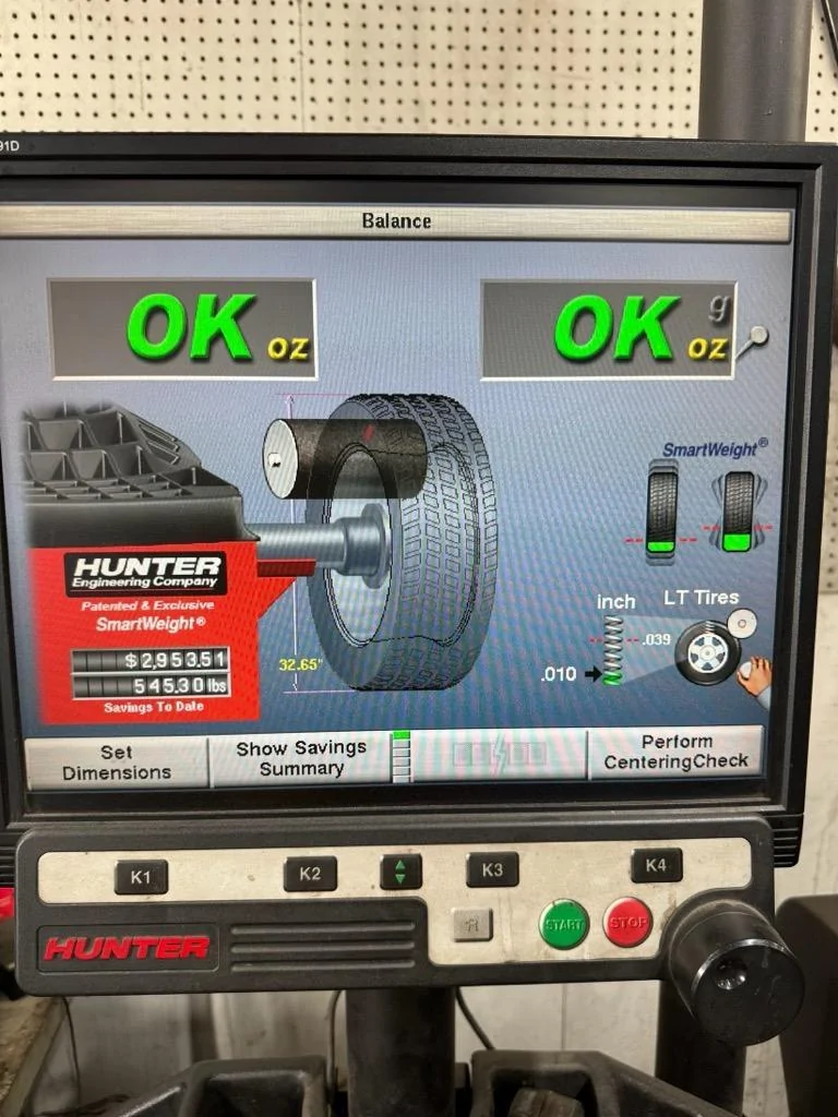

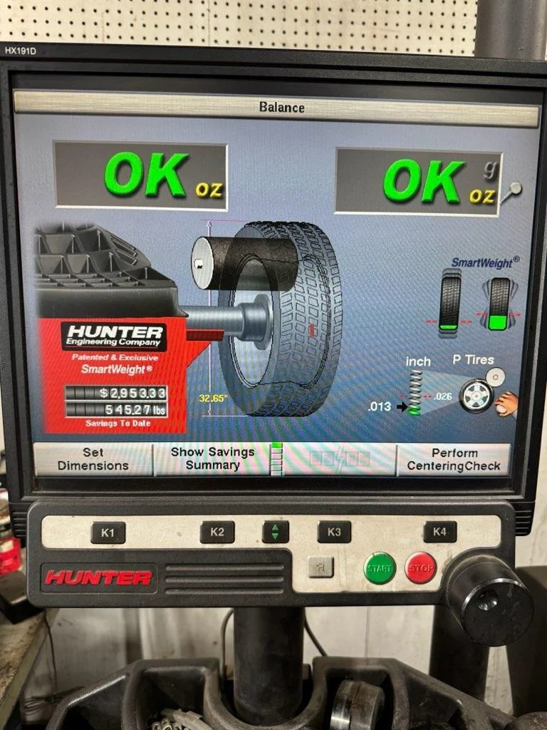

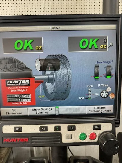

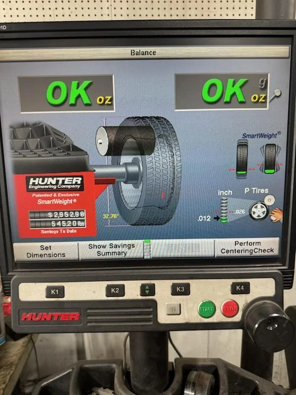

These are the road force numbers. .006 is in inch of run out converted to 6 lbs of run out. .010 is equivalent to 10 lbs an so on . Hope this helps guys. I was getting steering wheel vibration and chassis vibes above 80 mpg and now it's smooth.
