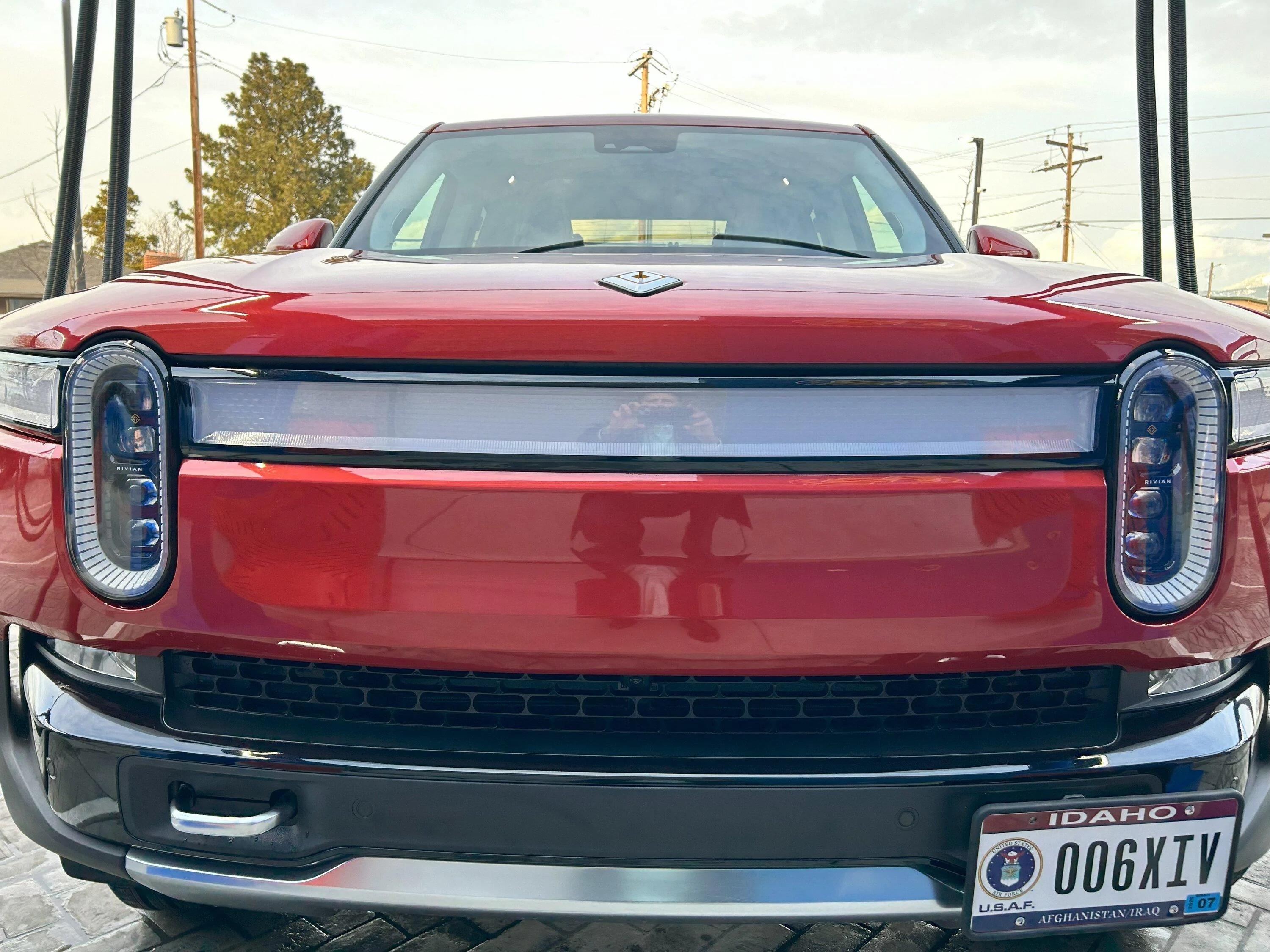

Rivian's radar is between the headlights.

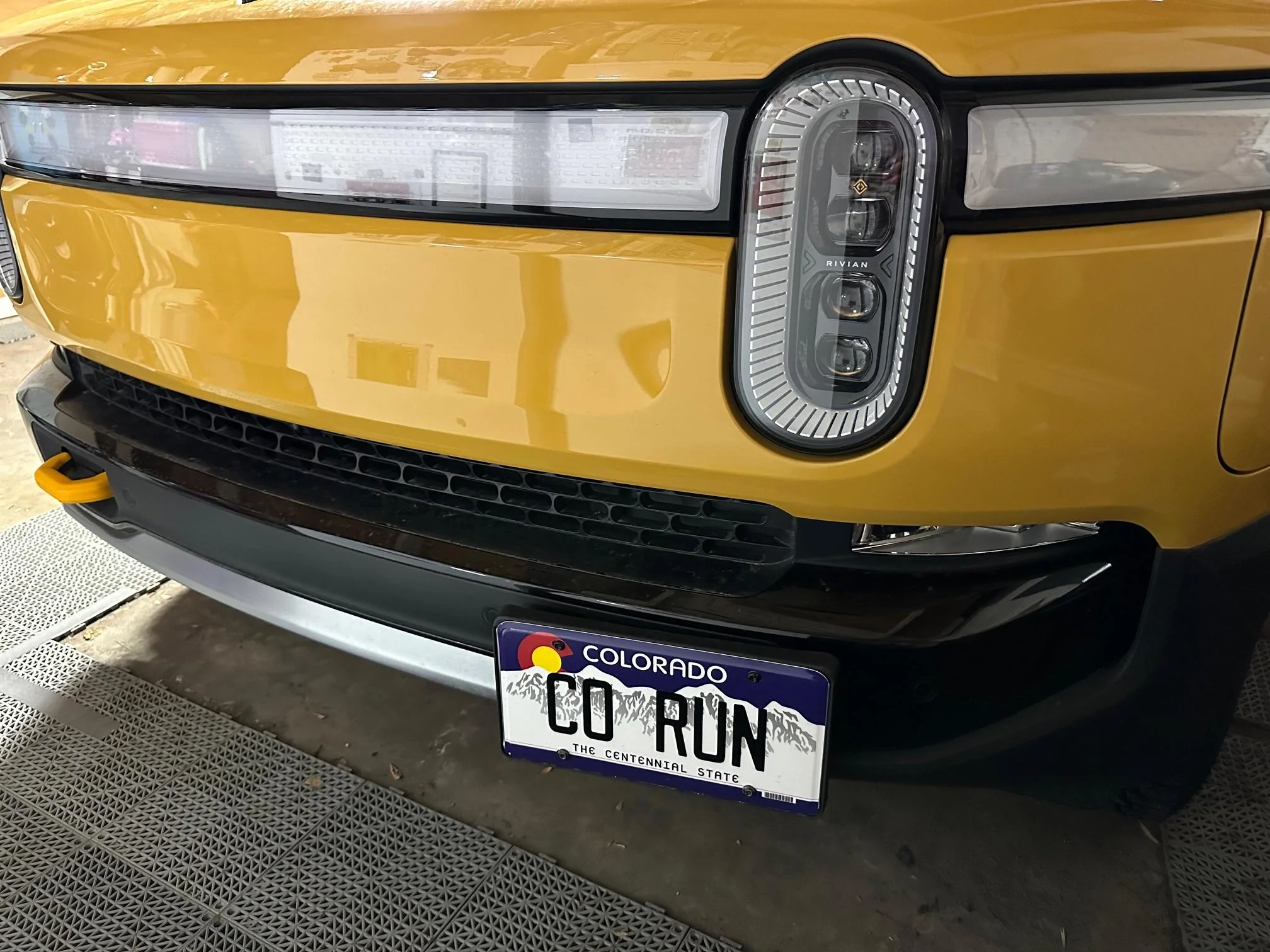

I got a tow hook plate from here
It's a lot for what it is, but it works well with the plate holder that came with my R1S. You can adjust it on the tow hook before you tighten it up. And it fits between the ultrasonics, so no issue.
Agree w tow hook options after reviewing avail options. Just remove prior to visiting the car wash. The back brace attachment has 3 different slots for attaching - can pick the outside slot to center the plate between the cameras so no interference w picture.
