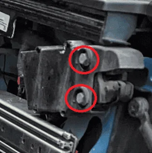

Is it easy enough to access the latches? Is the plastic bed liner held on by screws or the disposable pop-in holders?

Bedsides come out, bolts can be access by popping out the small circle things. Have to also remove the bolts through the tie-downs. Then it's just a matter of these bolts to adjust the position of the latch.
Can you DM me the steps you followed to remove the side? also is it the whole side?

I removed the liner and loosen the bolts. resolved the issue ASAP. Very easy to do. Took about 40min start to finish with testing.
