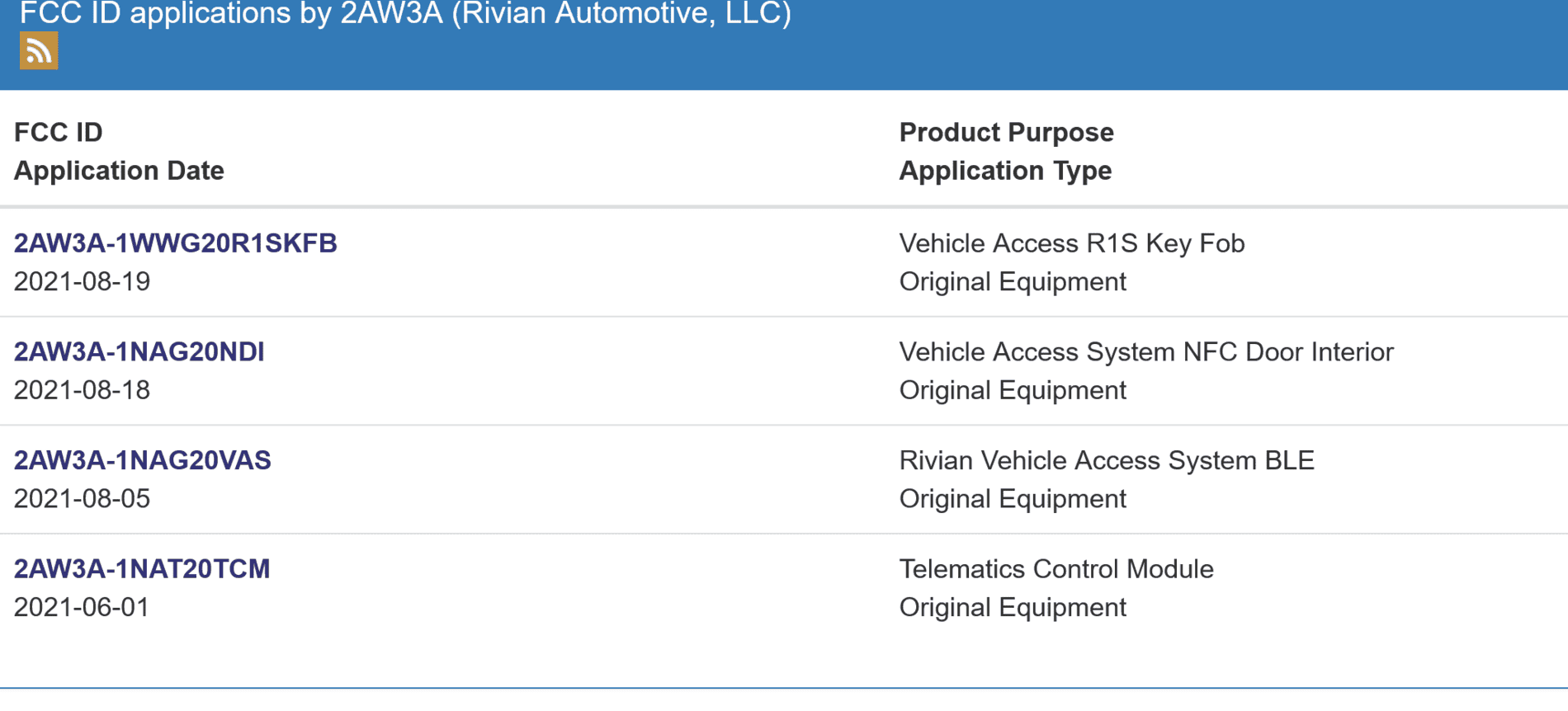

So, BLE and NFC access mechanisms. No mention of UWB so far. Not surprising even though it may be disappointing for some.

That's Bluetooth Classic which Rivian is opting not to use, favoring the newer BLE instead.
And (as you noted in the UWB thread) if the purpose of this particular transmitter/receiver is "Vehicle Access", there's no point in including BDR or EDR anyway. Those only support audio and basic data. For any "location" services like proximity and direction, they've have to use BLE.
EDIT: I just realized that the clip is probably from the TCM RF Exposure Info, not anything on the Vehicle Access System BLE device. In that document, Note 1 says:
Note 1: Referring to “TCM Operational Description_11May2021.pdf” During TCM boot-up, the device does not load any Bluetooth drivers, which means that the firmware is not downloaded.
So they're not running Bluetooth through that particular TCM, which they've purchased from another company. They're using someone else's Bluetooth component, quite likely because the TCM they're using doesn't support BLE, which is generally preferred at this point since it supports additional features that "Bluetooth classic" does not support. They're using the TCM for GPS, cellular and wifi. If you look higher up the thread, I had a post or two talking about the particular TCM component that I think they're buying and who they're buying it from.

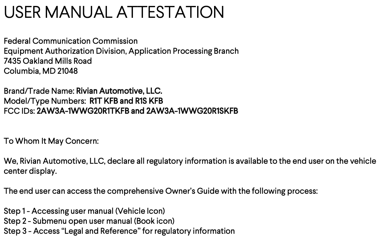

I've already noticed a couple interesting minutiae in the application for the key fob. The "User Manual Attestation" is below. There are two device IDs, one for R1T and one for R1S. That makes sense because we would expect different icons at a minimum. There may even be a different number of buttons (R1T could possibly have buttons for the tonneau cover, whereas the R1S might have separate buttons for lift and tail gates, although I suspect it'll just be for the lift gate). Also, there's a slight hint about the user manual, which does seem to be presented on the main console.

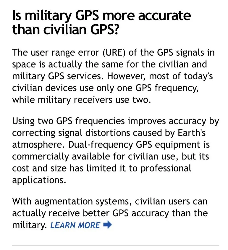

Could using two positioning devices improve accuracy? RJ mentioned they have precision to 10cm (I think?) which is pretty tight for civilian GPS
It's possible, but I would be a little surprised if that's it. One of the two devices uses multiple satellite systems, including GPS, GLONASS, and at least one other. Having more satellites would generally be better than having 2 different processors that you then have to either average out or somehow qualitatively pick between.
7,406
12,697
This is a good article on GPS, here is an excerpt
