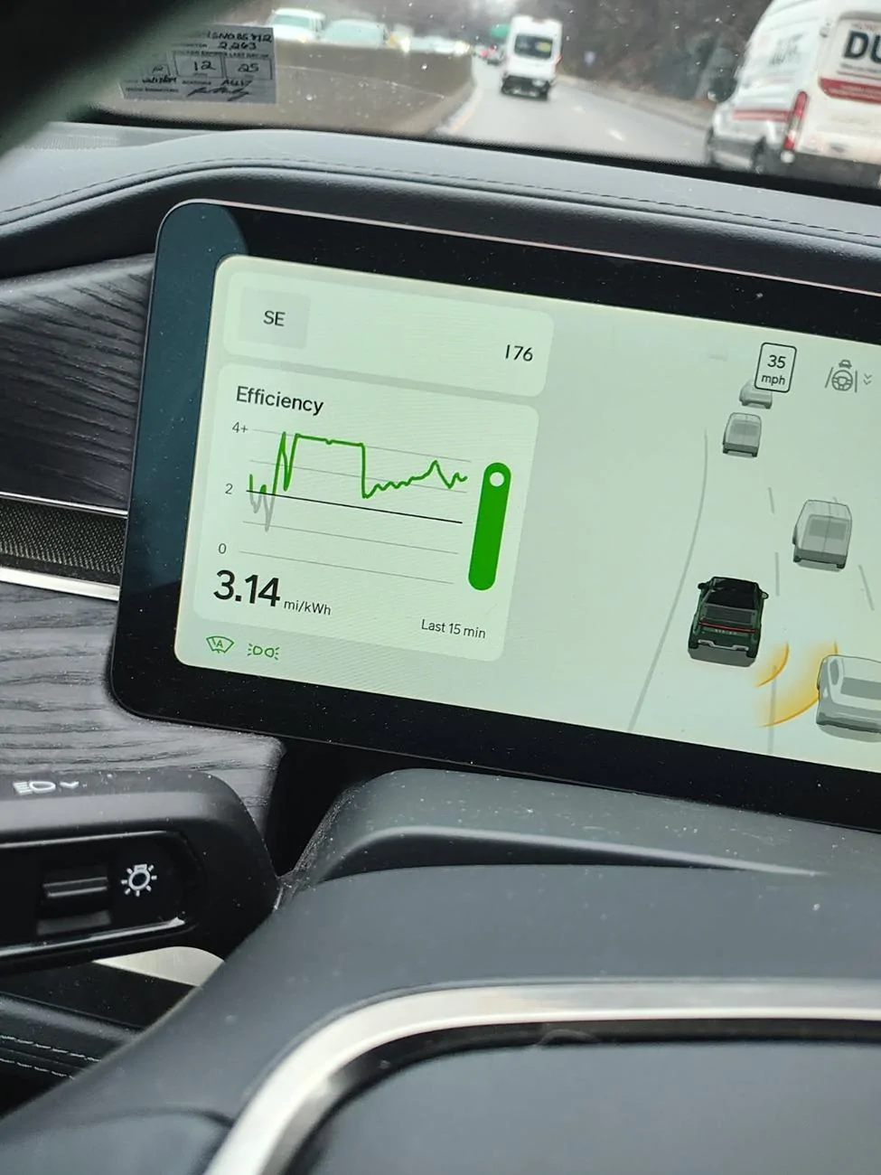

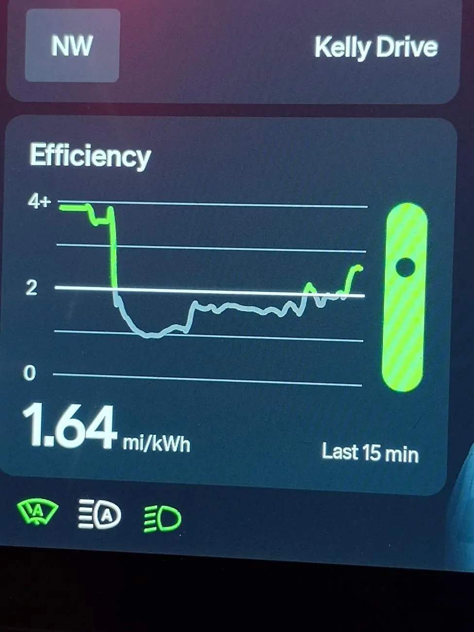

If you specifically want your battery at 50degF when you leave, you MUST schedule a climate setting with power pulling from the wall. IN ADDITION, you must make sure that at least 30 min prior to leaving, you have the range set to an amount above what the current battery % state is.
Since initially noticing this thread I've been keeping an eye on things.
I have found that the car pre-conditions regardless of whether it is plugged in or not. I have my R1T set to warm itself up for me every week day morning. On those weekday mornings I see efficiencies of over 3 m/kWh on the way to work. On the weekends, and on weekday evenings (when the car does not warm for me) I see efficiencies of a little over 1.5m/kWh.
I have also noticed that there is very little difference in battery temperature whether it is plugged in or not whilst warming in the morning.
Yesterday evening, no pre-conditioning / warming. Outside temperature was 41 degrees, battery temp was the same.
Rivian R1T R1S The preconditioning myth noPrecond
Yesterday morning, car not plugged in, preconditioned / warmed to 70 degrees. Outside temp 40 degrees, battery the same temp.
Rivian R1T R1S The preconditioning myth preCond
