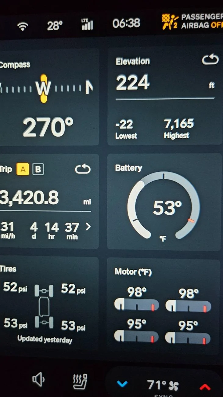

Ok, hopefully this will provide some validity to what I was saying.
This morning, I had a scheduled preconditioning. It's set to use the wall charger as necessary. It did charge the battery a little but it also warmed up the motors. So it's clearly using the motors to heat the battery like they told us. Yes, there's some passive heating from the charging, but it is actively using the motors for heat as well.
Pic taken just after unplugging before battery temp isn't visible when charging.
