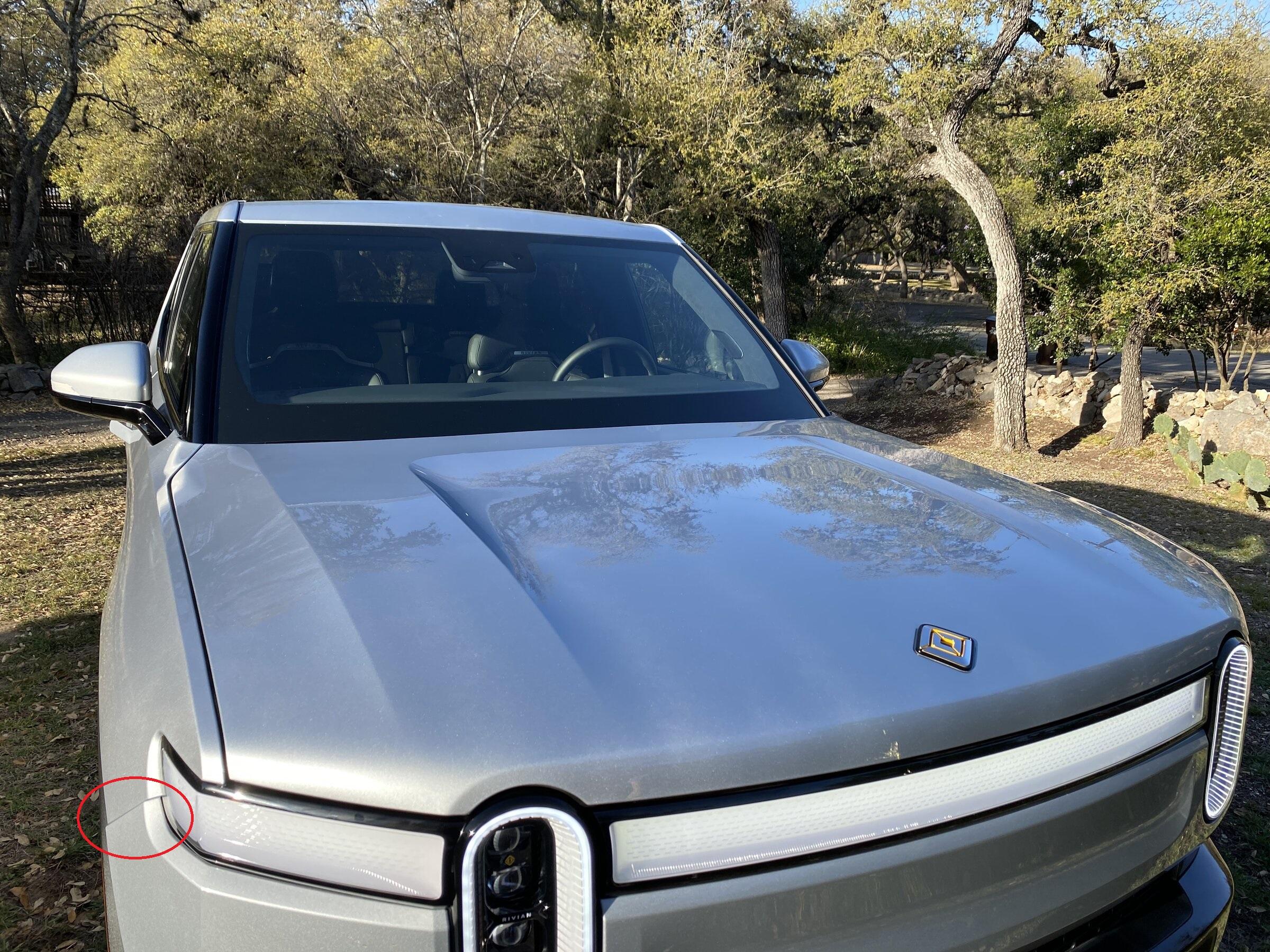

Ok, so after coming down from Cloud 9, I’ve noticed that the hood has lines in the paint. Isn’t the only way to fix this a re-spray? Needless to say I’ll bring this up with my guide but what a bummer. ?
What in tarnation... Yea that's a guide call ASAP.
Wet sanding will only do so much but it looks below the clear To be honest.

From the small amount of experience I have with paint/finishes, I can't imagine any method to fix this, other than repaint or new hood from the factory.

I almost hate to post this, as I’m not super anal about these things, but here goes:
I agree with everybody that the striping is pretty bad, and I’d need that fixed.
But, is anybody else worried about the hood alignment? Is it unlatched? It looks to me like the bottom of the hood does remotely line up with the fenders. I’m not one to obsess over a 1/8” vs 3/16” panel gap, but that looks like at least a half inch or maybe 5/8”
Am I seeing things?

While they're doing that maybe fix the bumper misalignment in the second pic.

another thing I noticed in OPs pictires was the passenger side corner of the front fascia has a similar defect. Unless it’s just jpeg compression…
Am I seeing things?
The hood/fender gap is good…but yes, that hood meets top of front piece is off…I think it’s the weatherstripping keeping it up like that as you can push down and it levels out. Other side is better…but yeah, these are only a few of my issues…the paint being the one that bothers me the most. Interior is impeccable. Gonna meet with another member Sunday to compare as he has same config. If he doesn’t have these same issues I might be testing that return policy unfortunately. ?.
That is a bummer!
I am sorry you are having to deal with all of it.
From your pic it also looks like the lower part of the fascia is misaligned. The good news is, when they fix the hood they can take care of the panel alignment as well.
Rivian R1T R1S Tiger stripes in hood paint misalign

Lol yeah this is bad application. These cars are sprayed with rotary bells that spin at like 80,000 rpm to atomize paint very finely. Looks like the flake made its way to the ends of the pattern with bad overlap - probably too dry. The guns and spray parameters are temperamental and maintaining them is equal parts art and science, looks like the paint shop is still on the science portion.
They owe you a new hood skin at the least, but to my knowledge they spray these all in one go, doors and hood included so check elsewhere. With any luck it was only the hood that was affected but often times the same robot that does the hood does the roof so check that and the front bumper too.
