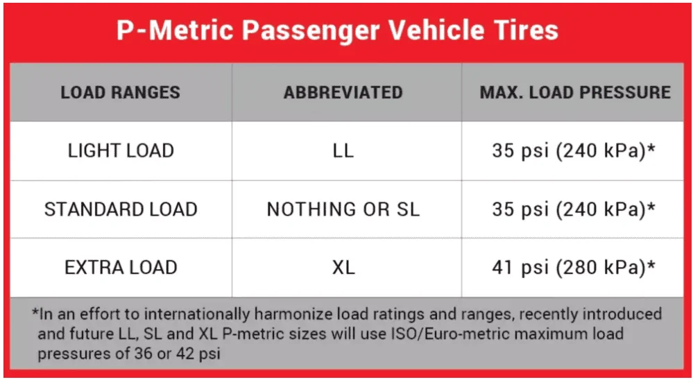

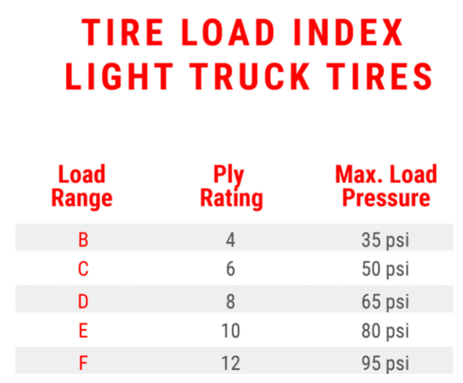

Load Range is the number of ply (for trucks) and max pressure
Rivian R1T R1S Tire Sizes 1633620337138
Rivian R1T R1S Tire Sizes 1633619962666

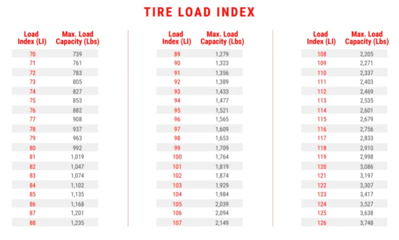

Load Index is the Maximum Load Capacity
Rivian R1T R1S Tire Sizes 1633619811509

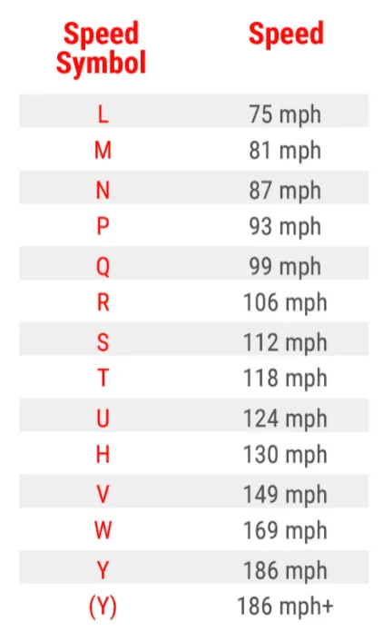

There is also a Speed Symbol representing maximum speed rating.
Rivian R1T R1S Tire Sizes 1633620033984

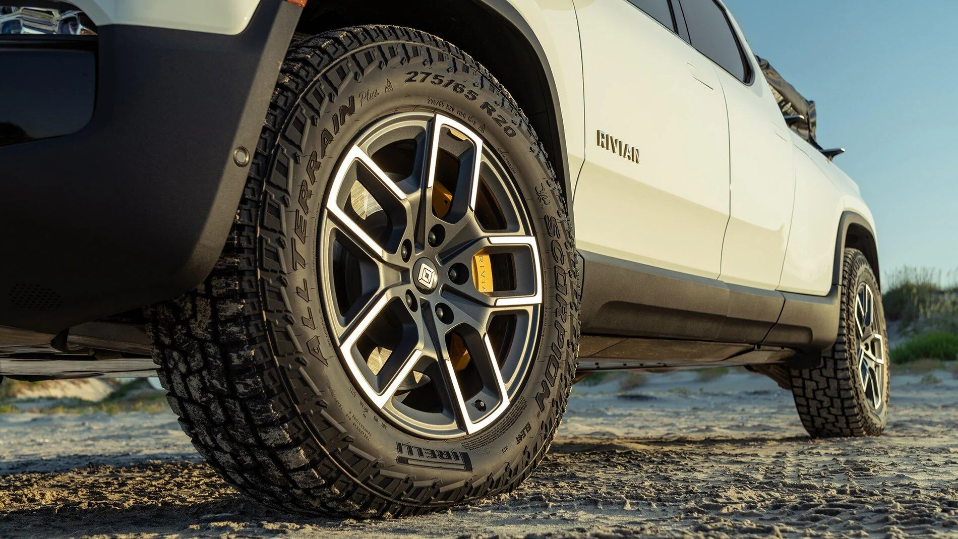

I suspect all of the popped tires are related to the fact Rivian is using a passenger tire and not a LT truck tire.
All the flats were with the 20” all-terrains, which are LT275/65R20 and carry a load rating of E / index of 123
This tire size is quite common on HD pickups.
Ladiver
Jeff
Jan 23, 2021
969
1,824
Ca
Yep, I needed more coffee this morning. The 20's are LT Load Range E. That is the same rating I have on my Sierra 3500.

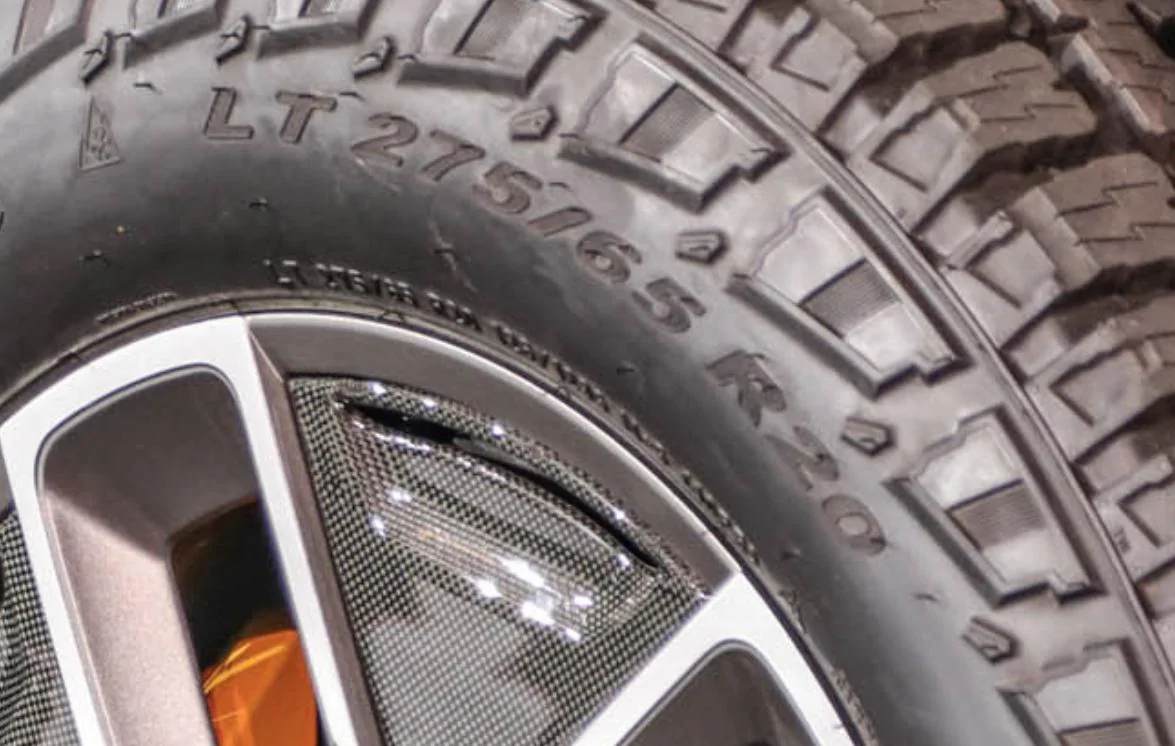

This is what made me wonder about LT- https://www.mavistire.com/tire-brands/pirelli/scorpionatelectric/2756520/4125700/
The listed XL rating only applies to passenger tires, not LT tires. I suspect they got the info from Pirelli, but who knows at this stage.
Also, if you zoom into the picture of the tire on the Pirelli site, the tire size does NOT have LT in front of it. I wonder if they were using the heavier E-range tires on trucks for testing before Pirelli got them the production tires. I'll bet the lighter XL tires would be better on range than those. I can't find where I originally found the 48lb weight for the AT tires anymore.
7,724
13,311
Silly me, the non Rivian version is an e rated LT.
The Rivian one indeed isn’t LT. load index 115
Interesting, Went back and looked at more pictures. Seems like the earlier pictures had the LT on them the later ones do not.
I assume the earlier ones were not the Rivian designed ones.
That will teach me to respond without doing more research.
I wonder if rivian’s version isn’t built off of the 275/60R20 scorpion AT, which weighs 47lbs per tire rack spec sheet.
Figure the taller sidewall adds that extra pound, remembering that tire weights are nominal.

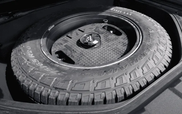

Here's a screenshot from JRE's video from Breckenridge. He's the one who blew his tire. I couldn't find a clean shot of the tire he gashed, but I assume it's the same type as the spare. I do not see LT marked anywhere, but maybe it's in smaller print or in the shadow.

Looks like LT is out and passenger vehicle is in. This definitely explains why on-road performance is sporty and responsive. I'm sure they did this for ride quality and noise as well. Not a bad option, but for those going off-road (rocks) you will want LT tires or you have a much higher likelihood of having a blowout, as we saw in the reviews.
