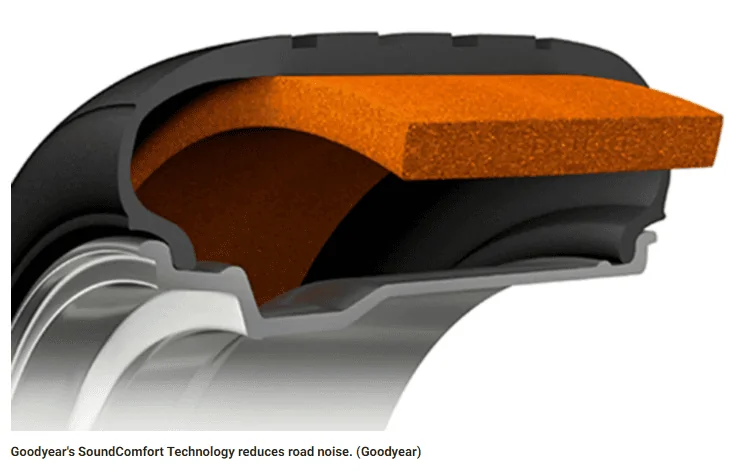

Just to add something else into the mix, caught this story:
https://www.foxnews.com/auto/goodyear-high-performance-electric-car-tire
Right now they're only releasing a 255/45R19 104W, at a $265 price point. But if they release a size appropriate for the Rivian, could be a nice replacement.
I particularly like their "SoundComfort Technology", and seems in line with many of the sentiments I was seeing on this thread.
You could not pay me to put on tires with foam insulation on my vehicles ever again. Biggest pain I've ever had to deal with tires. Just replaced all 4 on my Volvo at 10k miles, after having to repeatedly have the dealer rebalance and replace them one at a time.
Same here. Doubt the technology has evolved much from the Michelin OEM tire (that was) on my ‘17 Benz. Compared to the Pirelli I put on last April..that Michelin was louder and more harsh. Can’t confirm..but have read that some tire places would even refuse to fix a flat on that type of tire?
Foam is just dumb. It offers zero benefit, no noise reduction, nothing. Call it a conspiracy theory if you want, but the reason I think certain brands (Volvo, Tesla, Mercedes…) do the foam is it makes other tire companies not want to deal with repairs. Lots of Teslas in my area so the tire shops still work on them, but some are known for charging an extra ”tesla” fee, but it’s because the foam. As soon as you tell them they’re not factory tires and no foam they drop the fee and treat it like any other car that stops by. Discount Tire near me is my usual go-to and they happily work on Teslas. No extra fees or BS. But they do whine about the foam…. Even though it only adds a few seconds to the repair. Grinding the foam away from the patch site is all that’s required, but they can’t mark the tire for re-mounting and skip the re-balance as they usually would. They have to do a full re-balance if they cut foam away.
Our Model X had foam in the front tires from the factory, but not in the rear tires. Tesla usually glues the foam in, but has been inconsistent with it over the years. Our Model Y has it in the Goodyear F1s that came on the 20” factory wheels…. I’m running Pirelli winter tires on 19” wheels now and no foam there. Those F1’s are garbage tires, probably putting on some good all seasons before I throw the 20’s back on this spring. But for a couple exceptions, Tesla uses some really crappy tires. Many automakers do, which is sad.
