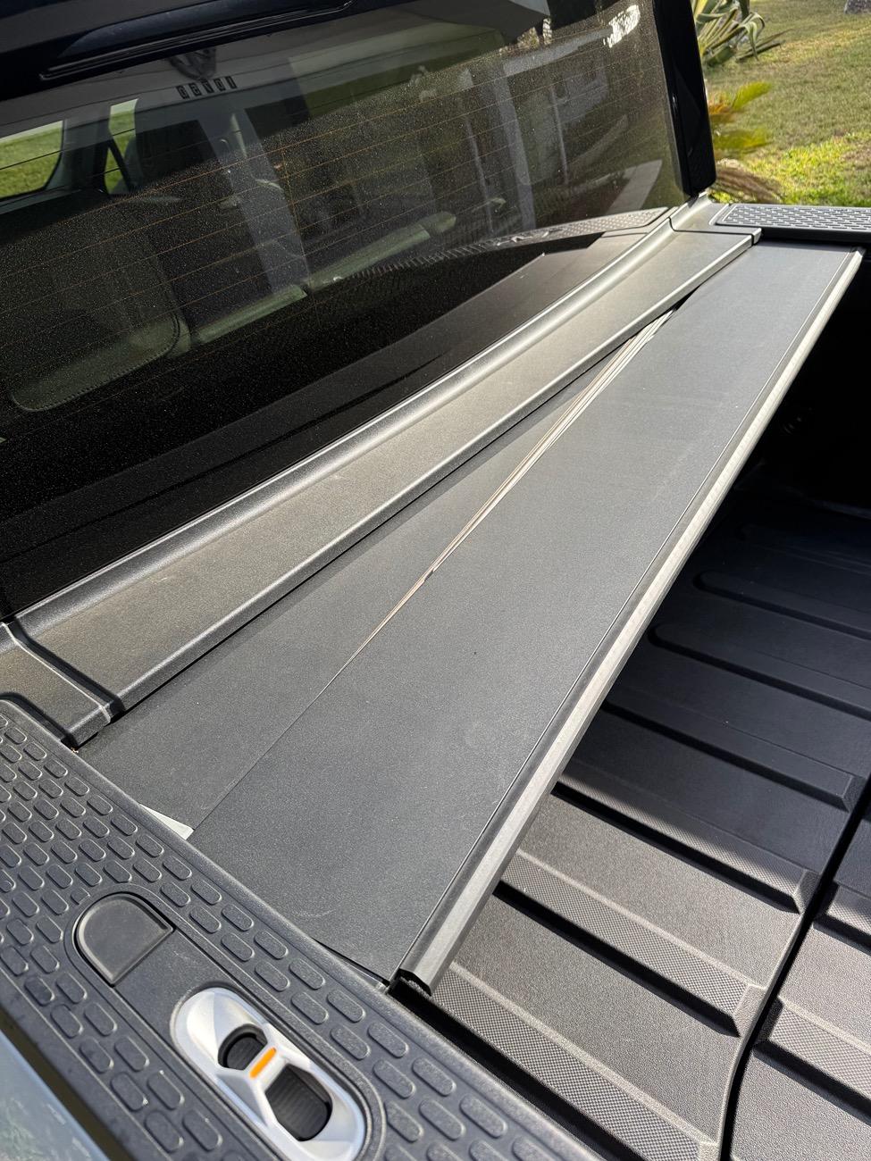

My Gen 2 R1T 2025's automatic tonneau cover is jammed. I'm wondering (a) how many others this has happened to and (b) has anyone tried fixing it themselves? Service said they had to replace the whole thing. I'm curious what the guts look like and why it's not designed to be repairable. I tried the 3 quick push and then 1 long push of the button: it made it worse. The issue isn't that the motor stopped. It's crooked and jammed. I've tried to keep it clean. --- Besides some silicon spray and regular cleaning of tree debris, etc ... what else are people doing to keep it working?? Cheers all!

It's serviceable but there's no point because of the high failure rate, they just swap it out for the improved design.
Trust the process, you'll be far happier with the Version 2.
Edit
Here is what the one you have looks like internally. The Version 2 is a roll up style that eliminates the decoupling/syncing issues of the current design.

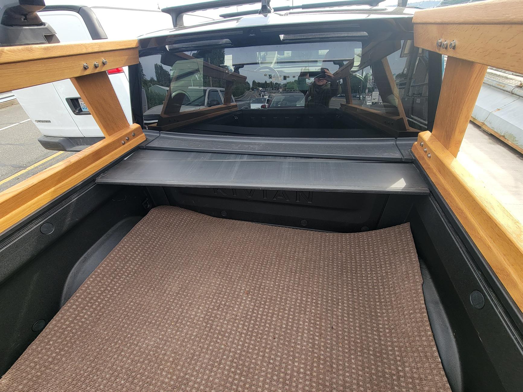

Service will likely require you to remove that aftermarket rack, or charge you labor on it.
