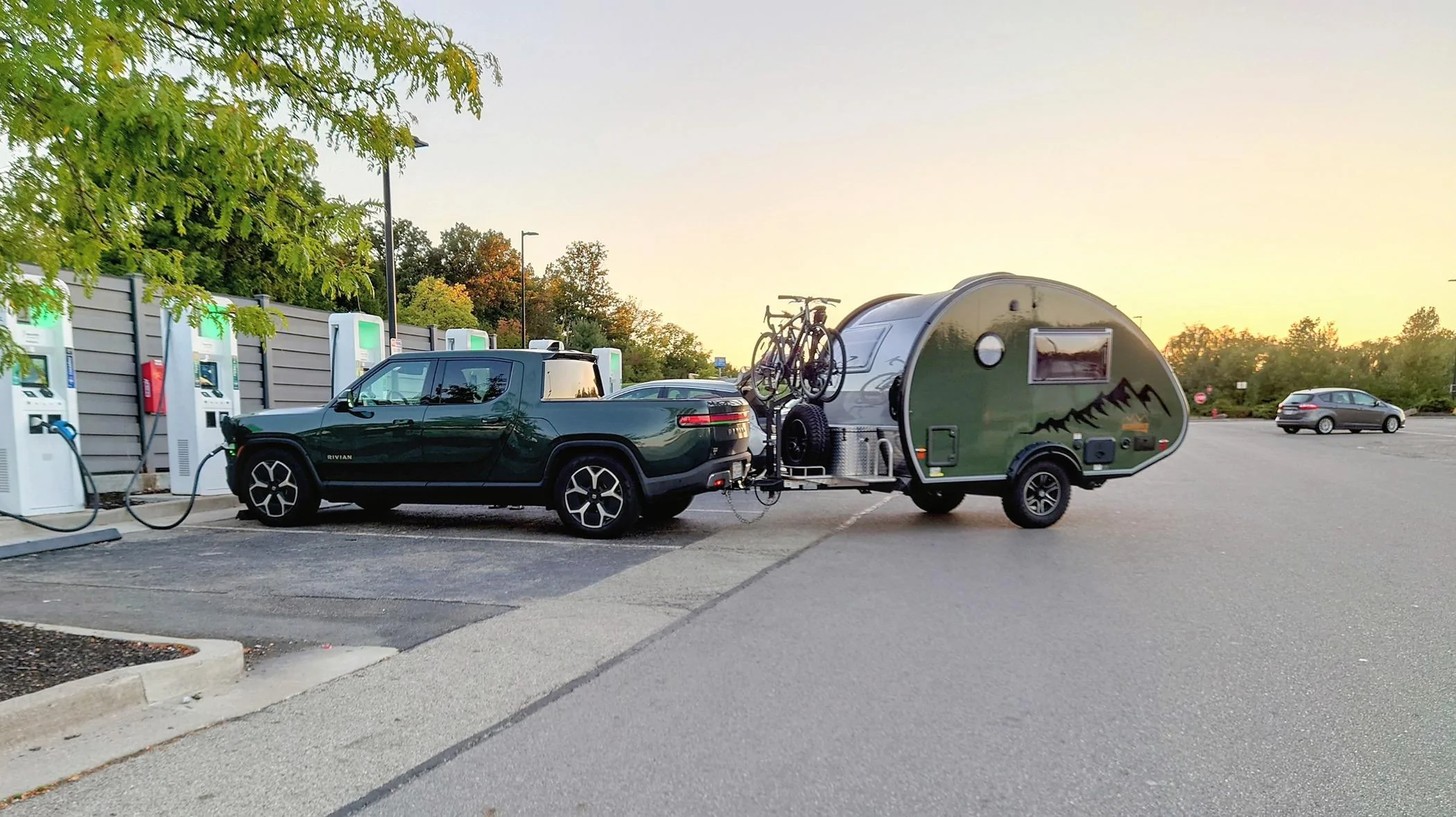

Are you, by chance, talking about a T@B 320?
If so, expect about 1.3mi/kWh at 70mph. 1.35-1.4 @ 65mph.
Source:
