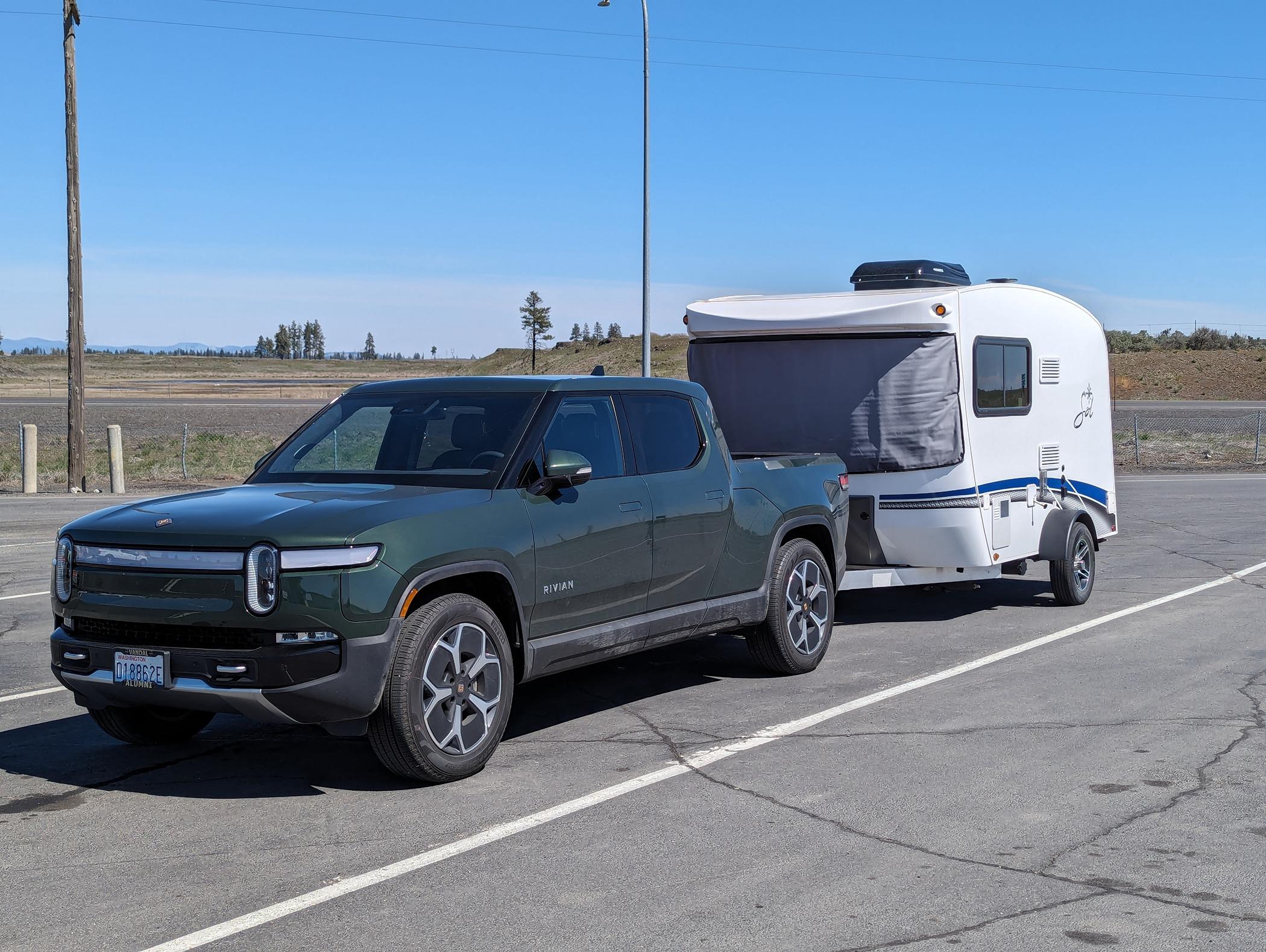

First camping trip of the year in the bag!

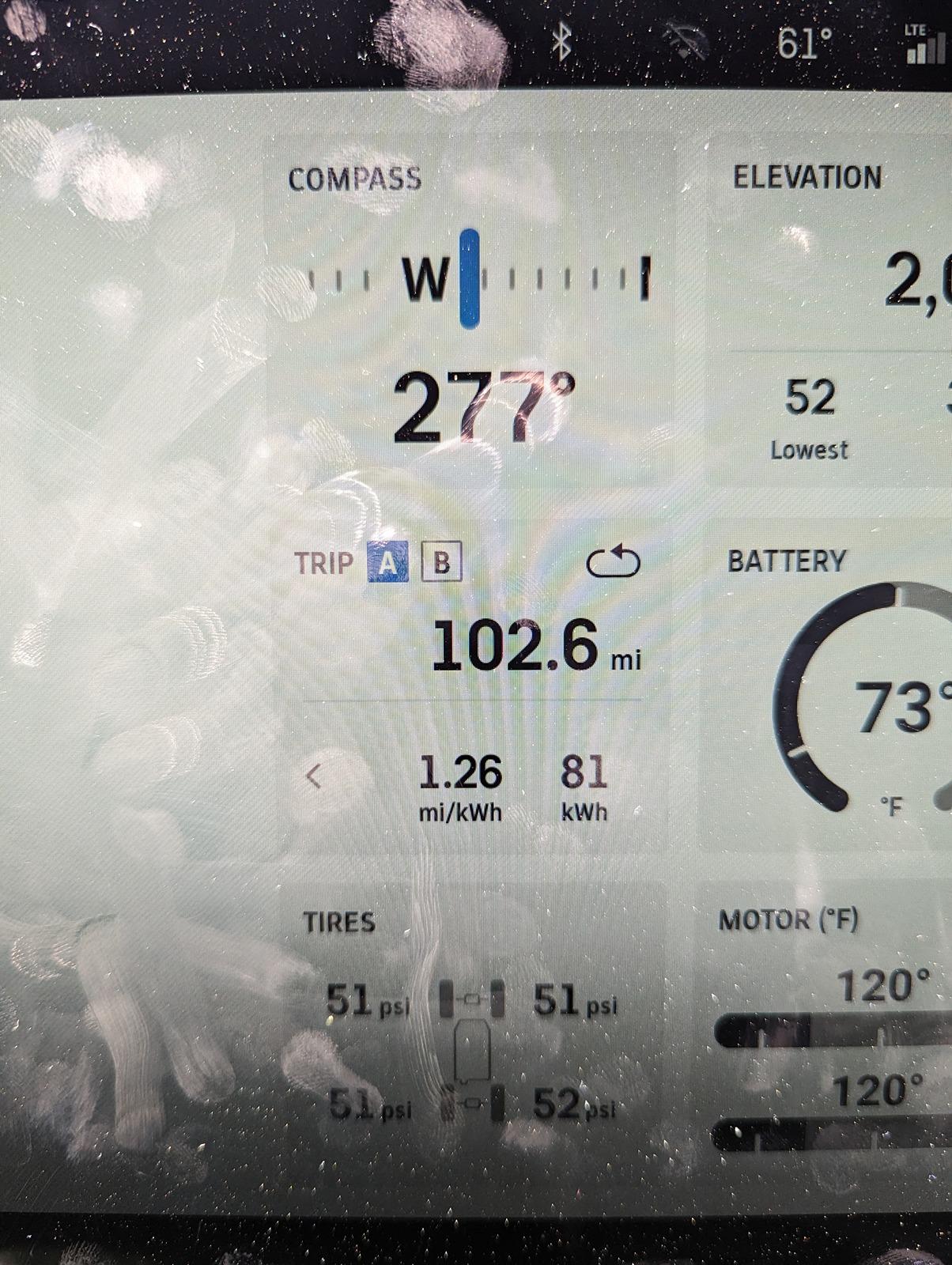

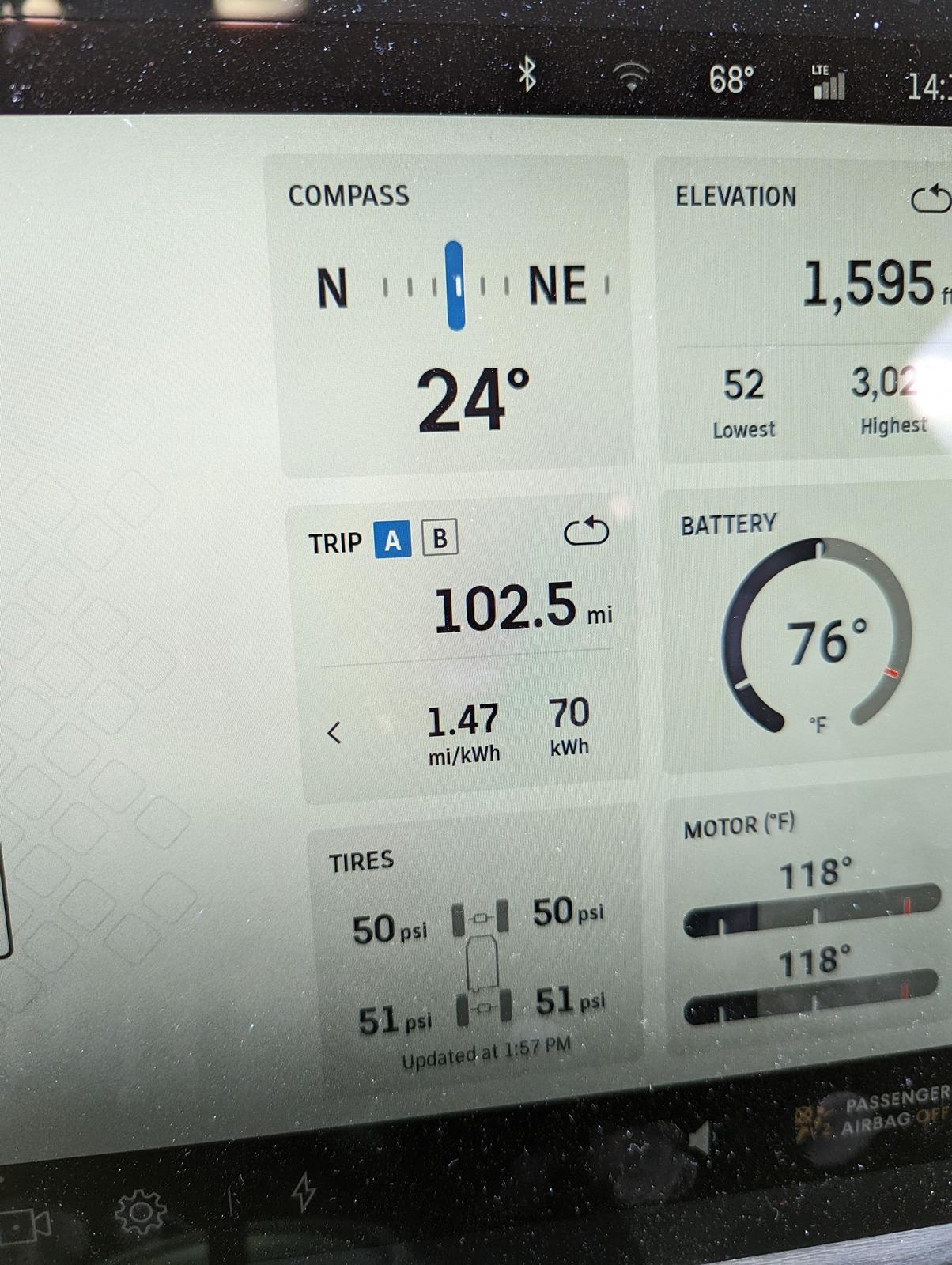

Here's some numbers:
Total towing distance: 205.1 miles
Max speed when towing: 60mph
mi/kWh on the way: 1.47
mi/kWh going home: 1.26
mi/kWh average for trip: 1.37
Overall, my wife and I are very happy with this setup! Never had to charge on the road (45% left on arrival, 35% left when we got home). There's a 1,000 foot elevation change over about 10 miles on this route, downhill on the way and up going home... so that affected things. Also had a nice tailwind on the way out, but crosswinds heading home today.

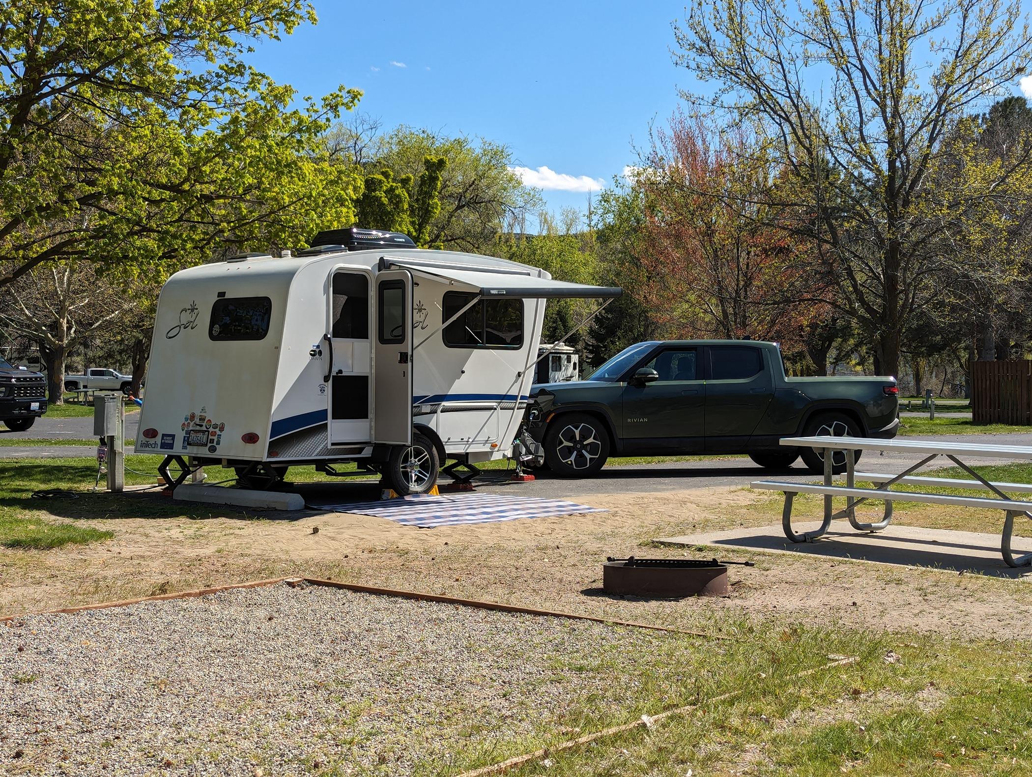

Nosed in so that we could charge the truck off the 14-50 outlet at the campsite. Wish we had chosen one with more trees around it for more shade and some wind breaks... oh well.

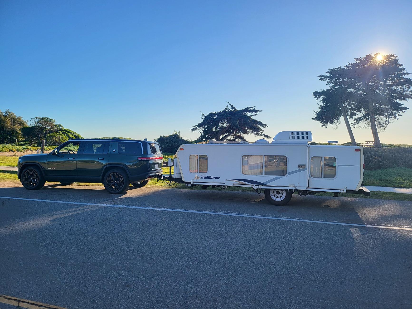

I’m newly considering getting out of an ICE tow vehicle (12 mpg towing) and trying an R1S to tow a 3700 lbs dry off road camper. Haven’t seriously thought about this until they upped the range a bit in the refresh, but still wondering what towing range will look like with the second gens. I see the range you’re getting while towing, but curious how that compares to the range you normally see unladen. What’s the percentage hit been for you? To be honest, anything above 200 miles is fine for me as I need to stop anyway; it’s really charging time that is the biggest concern. I think EV’s have tackled the range issue by and large now; but charging time is the remaining bugaboo for me.

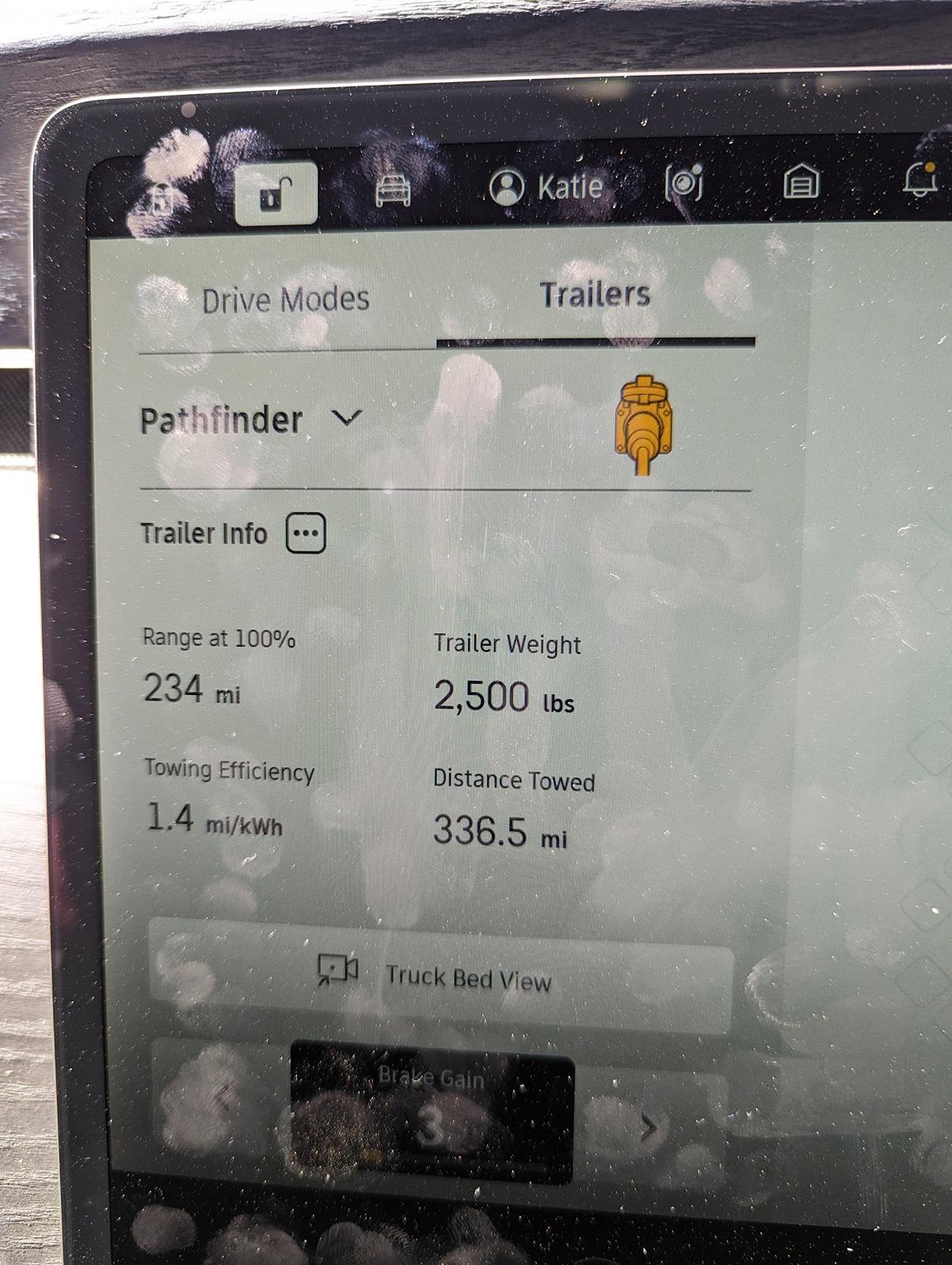

You will lose between 1/3 and 1/2 of your range towing, not unlike an ice. Get the biggest battery you can. I get 225 miles of range towing this
