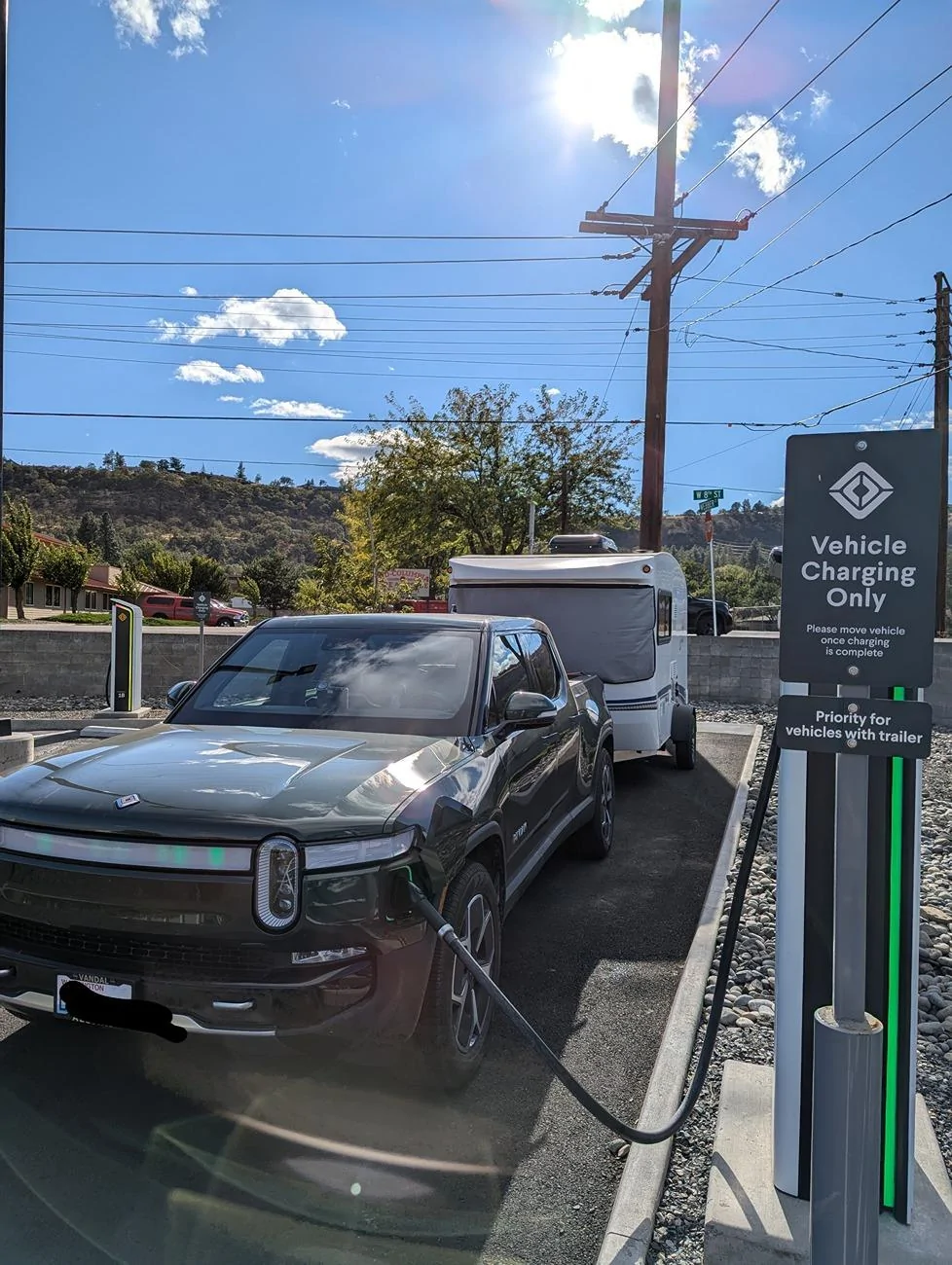

Charging at the RAN in The Dalles, OR.

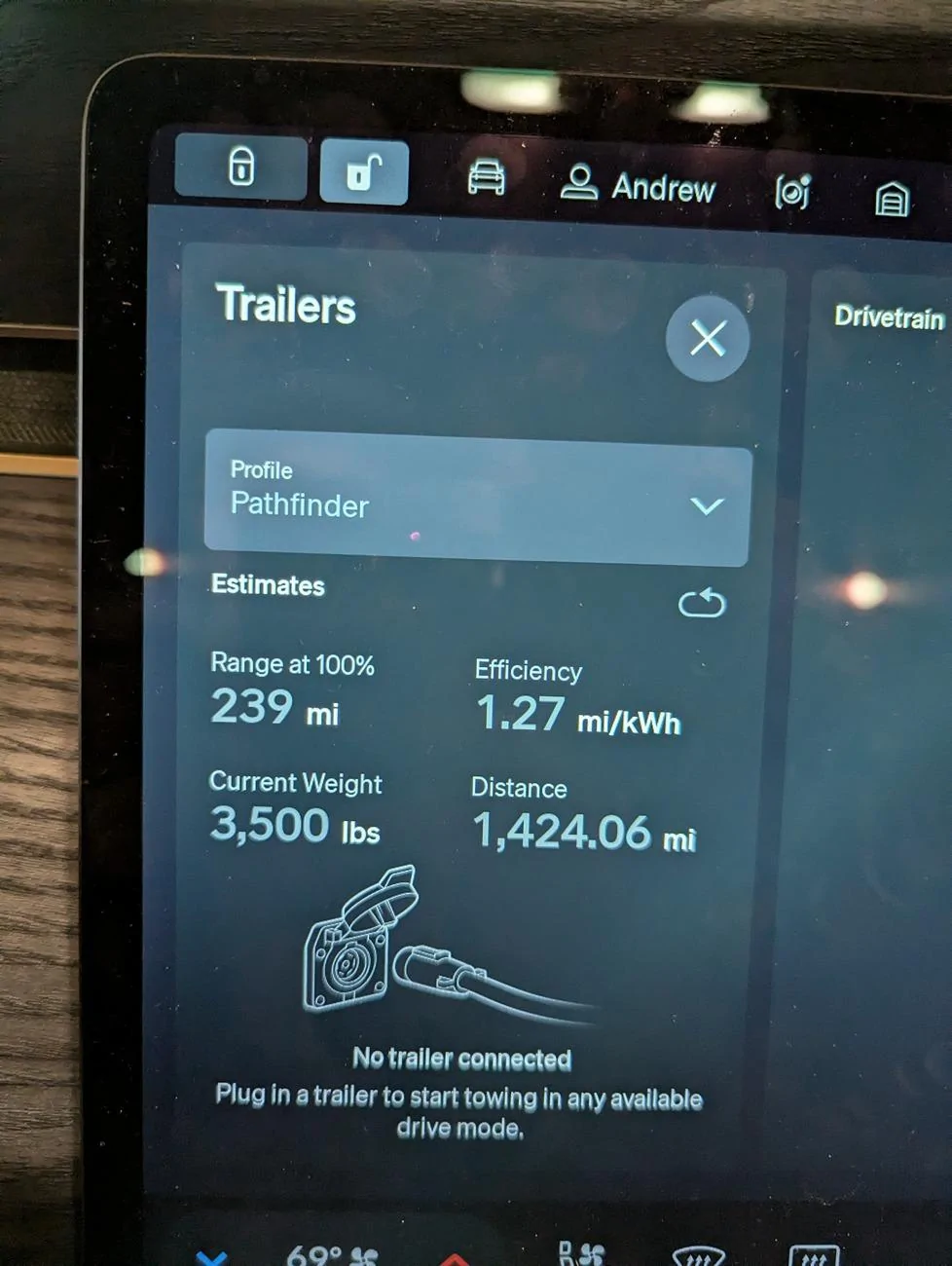

Total trailer stats (for the total ownership of the truck). It was always over-guessing the weight of the trailer...
