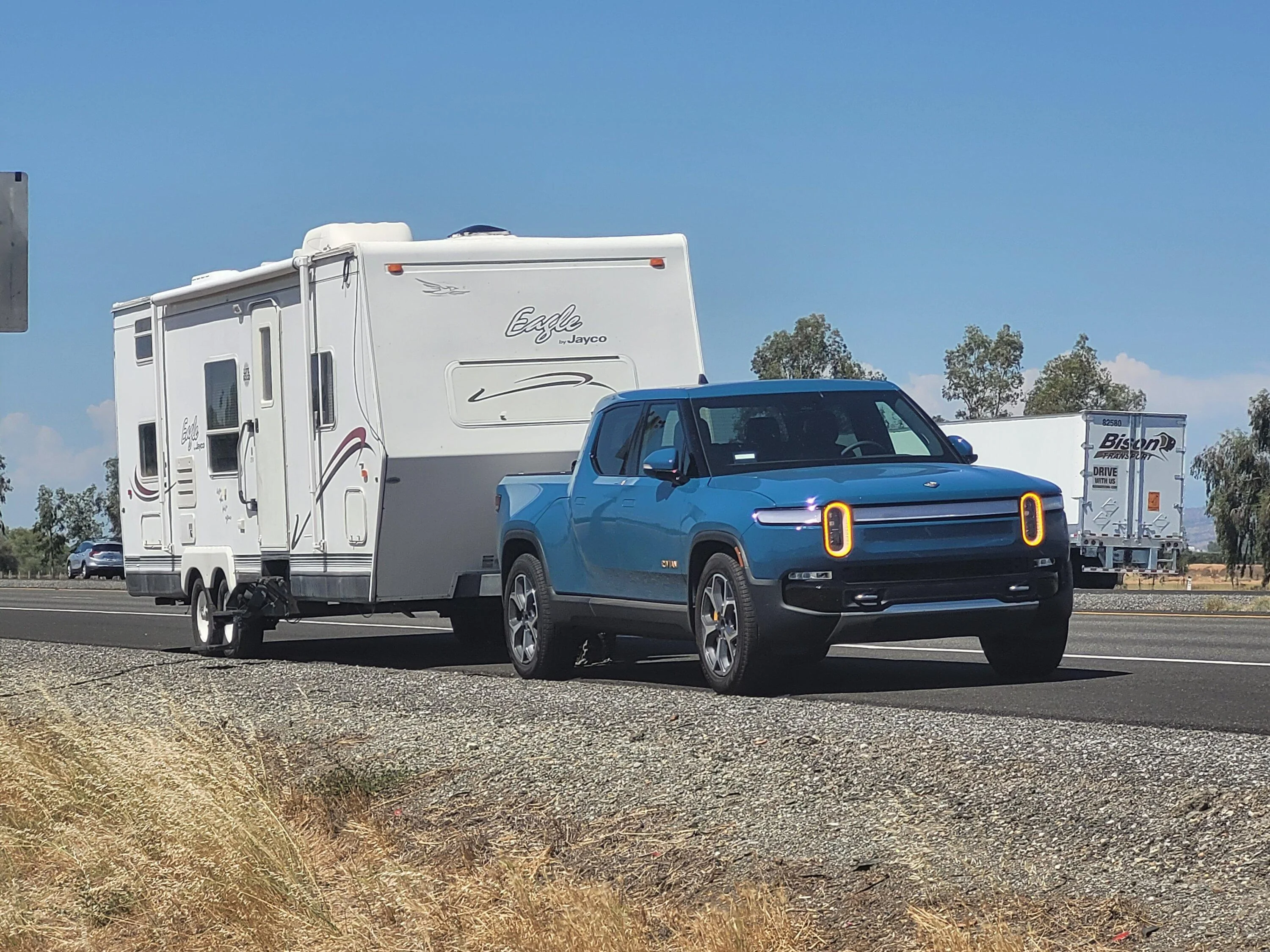

Well, sadly the R1T didn't make it home.. Major failures coming home down the moutain out of Anderson in 100 deg Temps. First low battery voltage failure, then low coolant warning, battery warm warning and then the truck went Into an emergency shutdown procedure and I couldn't get off the highway so I'm stuck attached to the trailer, with now way to unbrick the truck so I can at least get the trailer home (only about 30 miles from home).
At this point Rivian said they have never dealt with this situation (no way to move vehicle, or release E brake.)
It was all going so well.. this was the easy part coming downhill..
I'm currently waiting ( 3 hours so far) on a busy I5 truck highway, waiting on a tow truck and a CHP vehicle so we can get my trailer and truck home, then off to the service center..
Ugg
Ugg

Tried that too. 12v seems to be ok. The truck locks and unlocks ok, but main screens don't boot up.. bricked.

I wonder if it is the other 12 volt battery. Seemed like the Monroe crew said it looked like separate 12 volt circuits but not sure I trust that assessment, seems like a strange configuration.

Spent about 4 hours on i5 waiting for Rivian to get a tow company. Finally got a tow, took it to my house and tomorrow, it goes to west Sac for repair ( three days later) The truck definitely lost some type of cooling fluid or coolant. It was dripping something out of the front passenger area. This concerns me as I know the battery had no way of cooling itself which is why it totally bricked itself. After 4 hours, it finally turned on enough so I could release the e brake and tow truck could take it home, and I could hook up trailer
I'm not sure how comfortable I feel with this truck now. That experience had to carve some life out of the truck.. It seems that the overheating fried some other systems as well.
