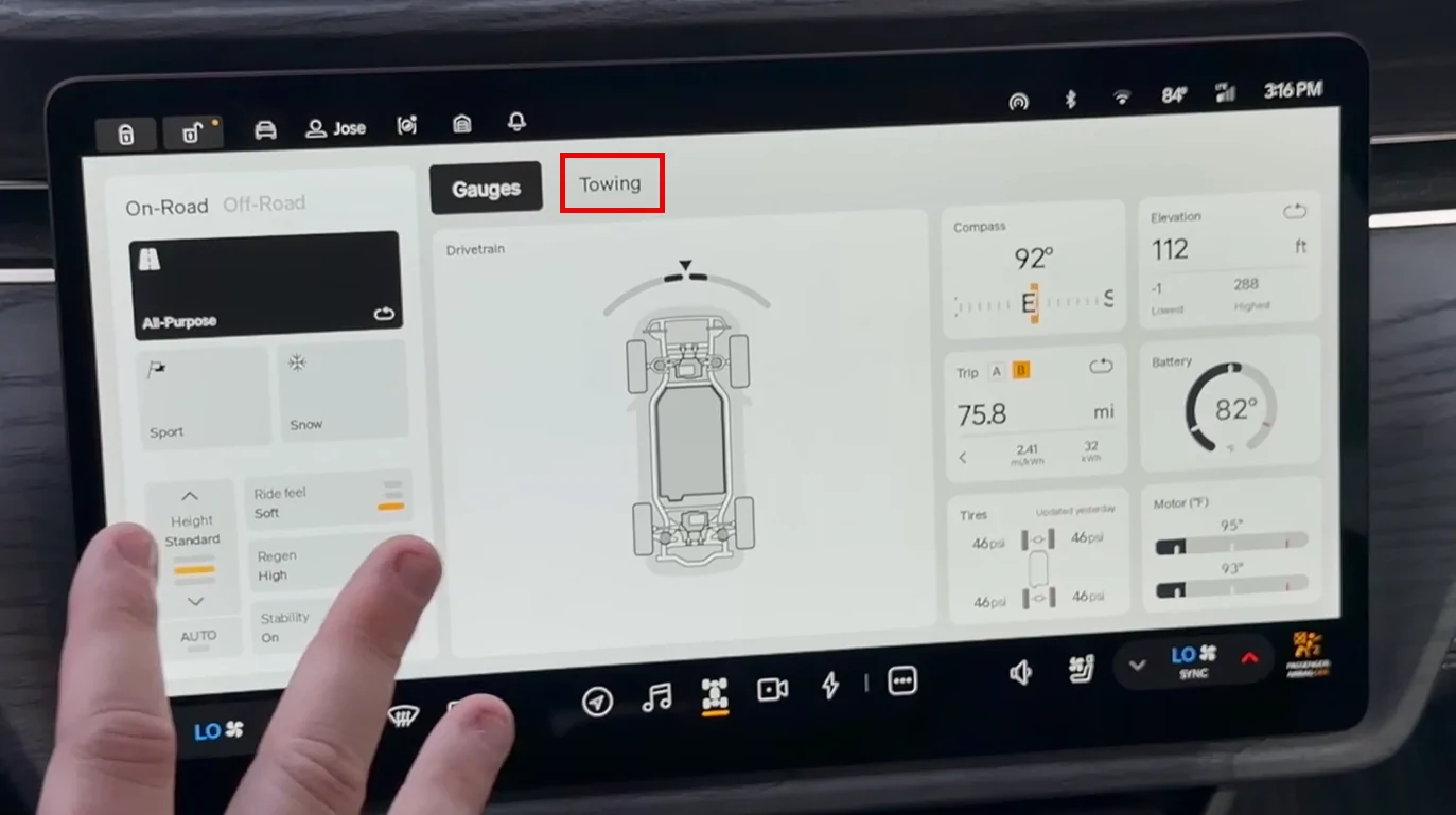

If you are on a newer version of the software, trailer mode is now on it's own tab on the gauges screen - it's not a button with the rest of the driver modes. You can check to make sure the trailer shows as connected there.
(Stealing this screencap from Jose/RivianTrackr):
Rivian R1T R1S Trailer Detected But No Trailer Mode 1778677307775-54

Thank you so much @VandalSibs - I owe you an adult beverage! It must have been in the recent release as I was camping recently and I didn’t notice the change until now - and must have missed it in the release notes! And I chatted with Rivian support and they didn’t have a clue what was going on. But boy trailer mode seems buried now in the UI - I hope this is not a harbinger of the future where Rivian has given up on their vehicles as tow vehicles and relegating it to some hidden feature …

Happy to help! I think it was two or three releases back - whenever the RAD tuner finally got added to the Gen 2 quads. In fact, that's the reason why that area is above the 'gauges' view now, as they needed a place to access the RAD tuner. When they did that, they decided to move the Trailers info there too.
I don't think it's any de-valuing of the towing experience as much as them wanting to avoid putting too many buttons under the different drive modes that are available. Towing modes/profiles can end up a bit buried under menus on other trucks too from what I've seen, EV or ICEV.
