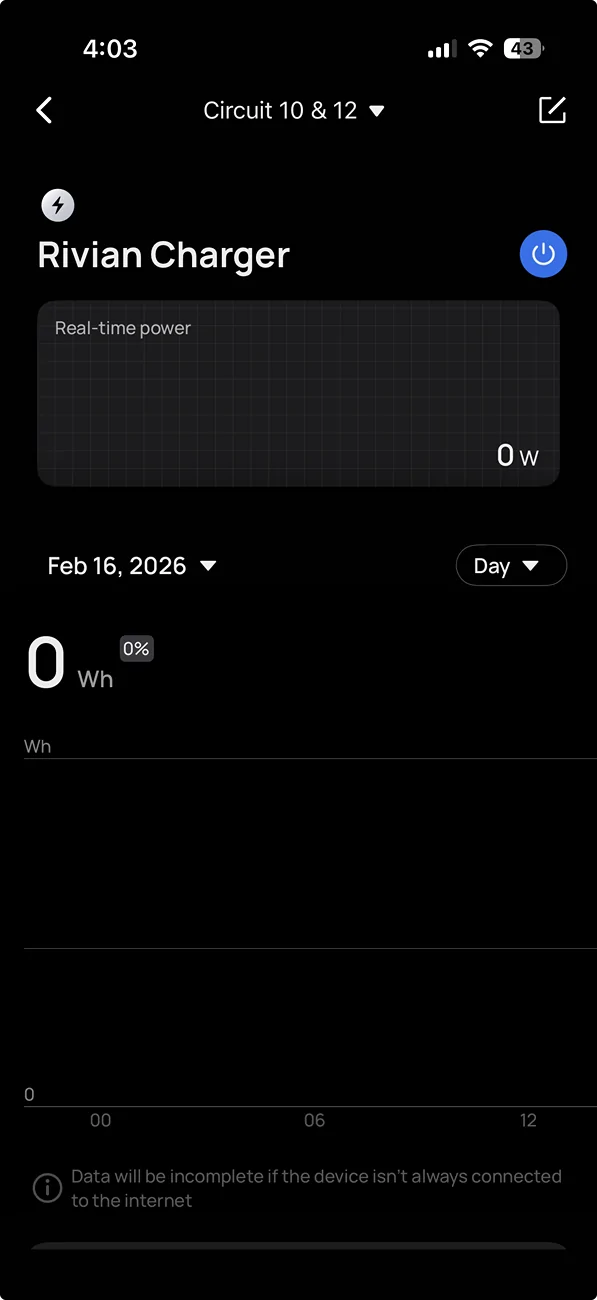

That doesn't make any sense. My Rivian wall charger consumes virtually no power when not charing my R1T. I have it running through a smart home panel that monitors energy consumption and it shows zero watts currently.
Rivian R1T R1S Turning off My Wall Charger 1771275809777-uf
