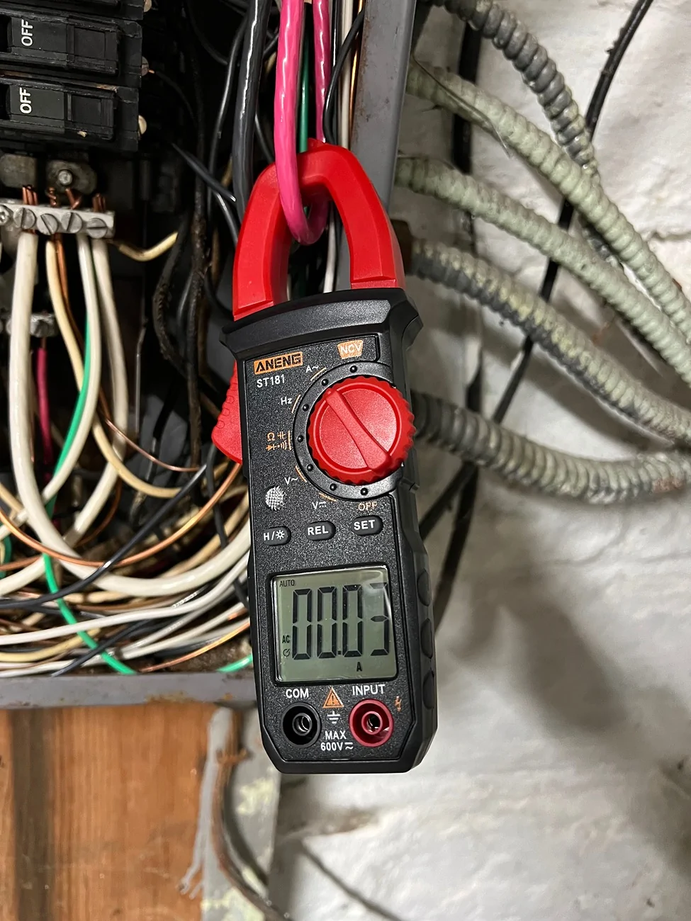

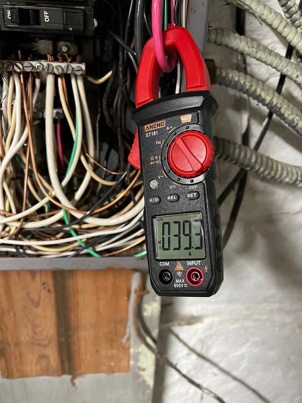

I ordered one like this just to try.
https://a.co/d/02T3lyBQ
Got clamp meter today and here to report results from my dedicated EV charging breaker on service panel. I have Grizzle 40A mini portable on 14-50 outlet. Usually plugged in and ready to charge 24/7.
When idling = 0.03A or 30mA
When charging = 39.3A
It’s roughly about 7W and consume 5kWh/month idling.
Yeah, we complain about phantom drain in our vehicles, but we tend to forget about vampire drain in our houses. With all the phone chargers, routers, wireless access points, cable boxes, etc. etc. it is $10 to $20 a month for the average house.

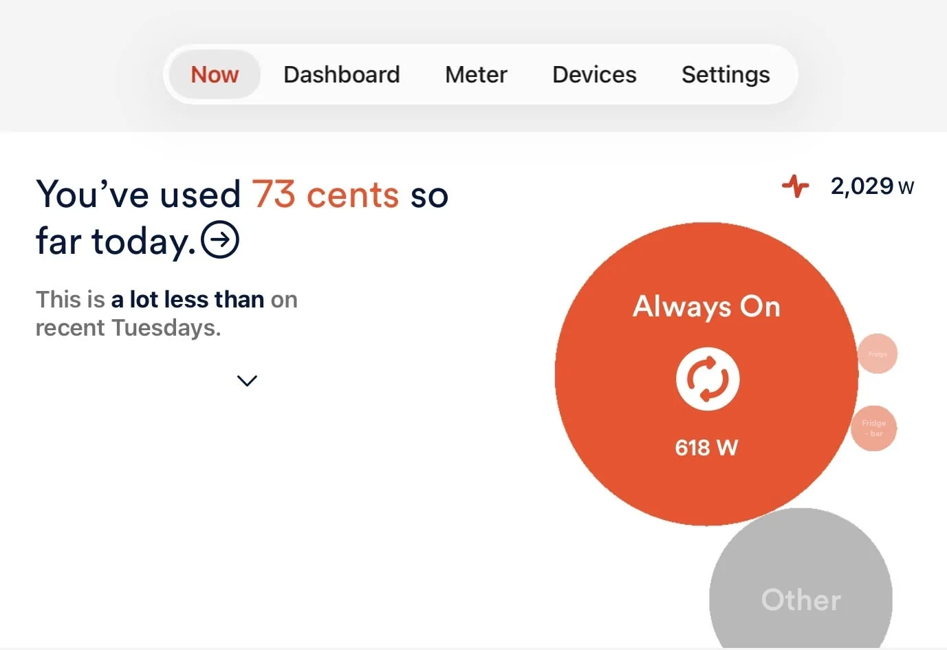

My house uses 620w perpetually. I've given up on tracking down all of the devices. Sometimes other consumers are surprisingly high, for example the rest of the 2k right now is just a vacuum. With our low electric rates, the 620w is about $23, whatever.
Using Sense? I had forgotten about it - used to have it installed, but when my generator was swapped out they didn't put it back in the box. Going to have to dig it out and get it up and running again!

Yeah, it's an older Sense system. Today, I'd get one of the more advanced systems with a monitor for every breaker. It's pretty good though.
It was interesting to see how much power the AC uses in August here, when pre-cooling it.
