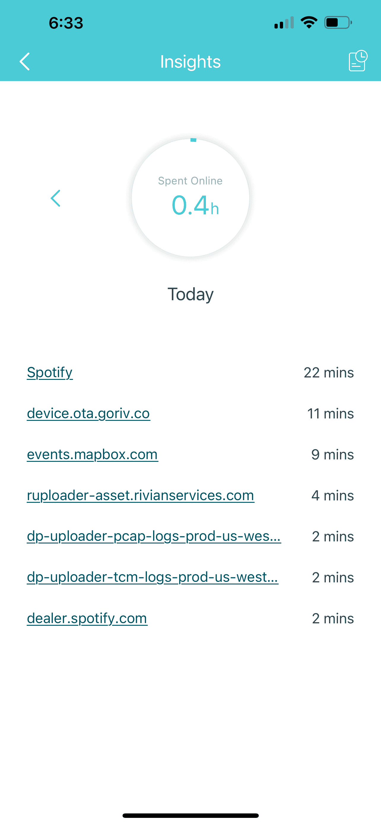

This was from the past hour with everything off, paak, gear guard, app exited from phone, not charging.

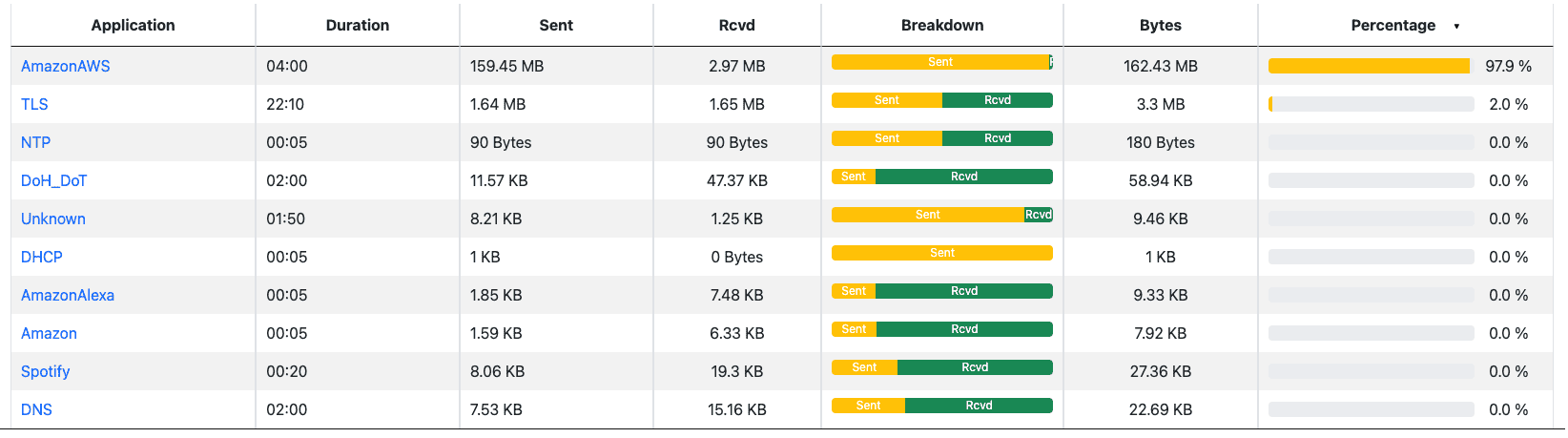

Those hosts look familiar. Here's a screenshot I took a few weeks ago of the applications in use:
THe truck is "turned off" and spent 22 minutes communicating to Spotify? That's ridiculous.

I just exited Spotify on my phone. Will see if that changes things.
I’ve heard Spotify play through the Rivian when I’m already in the house with doors locked.
