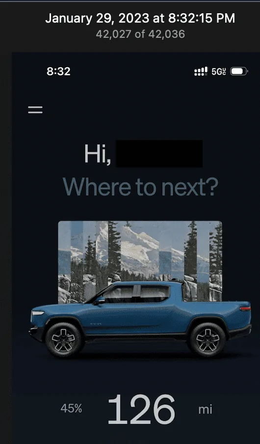

On Sunday, 1/29/2023 @ 8:32pm local time, my R1T was at 45% SOC and 126 miles of rated range. I left the truck unplugged overnight at my next door neighbors' house because I was waiting for some paver sealant to dry and cure in my driveway. Shout out to my awesome neighbors! Anyway, I noticed the rear tail lights would blink every few minutes while in my neighbors' driveway. I'll post of a video below of the blinking, which is not the actual video from 1/29/2023. Rivian service had previously told me such blinking is normal; however, I suspect the blinking means the truck is awake and not sleeping.

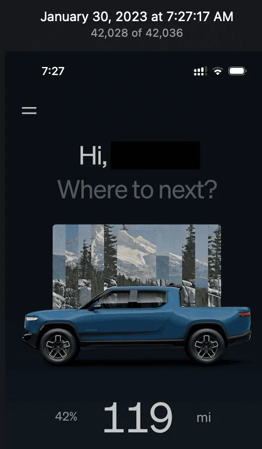

On Monday, 1/30/2023 @ 7:25am local time, the R1T was down to 42% SOC and 119 miles of rated range. So overnight loss of 3% and 7 miles of rated range.

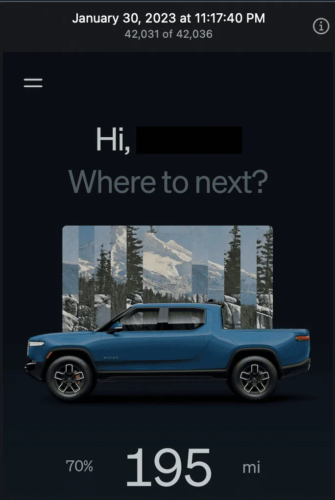

On Monday 1/30/2023 @ 11:17pm local time, the R1T was parked back in my driveway and charged up to a 70% limit and 195 miles of rated range. I unplugged it AND removed the front frunk trim piece. I noticed the rear taillights were longer blinking and I assumed the vehicle went to sleep.

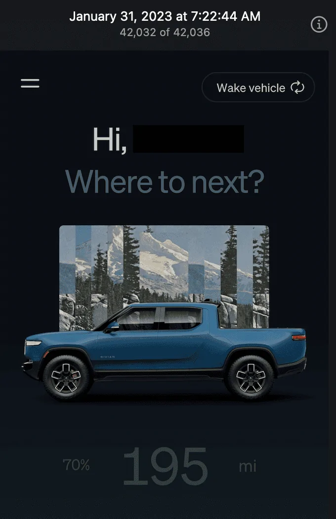

On 1/31/2023 @ 7:23am local time, the R1T was STILL at 70% SOC and 195 miles of rated range.

1/29/2023 8:32 pm:
Rivian R1T R1S Vampire Drain Relating to Frunk Trim -- my solution to reduce drain % 1-29-2023 832pm
1/30/2023 7:27 am: 3% SOC loss and 7 mile loss of rated range:
Rivian R1T R1S Vampire Drain Relating to Frunk Trim -- my solution to reduce drain % 1-30-2023 727am
1/30/2023 11:17 pm: 70% SOC and 195 miles of rated range
Rivian R1T R1S Vampire Drain Relating to Frunk Trim -- my solution to reduce drain % 1-30-2023 1117pm

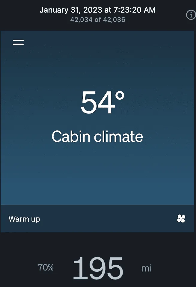

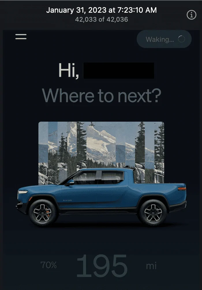

1/31/2023 @ 7:23 am: Screenshot of vehicle sleeping, waking up, and showing no apparent loss upon fully waking.
Vehicle Sleeping:
Rivian R1T R1S Vampire Drain Relating to Frunk Trim -- my solution to reduce drain % 1-31-2023 722am Sl
Waking:
Rivian R1T R1S Vampire Drain Relating to Frunk Trim -- my solution to reduce drain % 1-31-2022 723 Waking
Fully awake and no apparent overnight loss:
Rivian R1T R1S Vampire Drain Relating to Frunk Trim -- my solution to reduce drain % 1-31-2023 723am No apparent loss

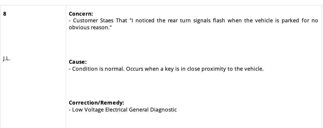

Rivian's response when I asked them the address the blinking during an 11/8/2022 service appointment:
Rivian R1T R1S Vampire Drain Relating to Frunk Trim -- my solution to reduce drain % Rivian service response RE blinking
They actually told me if a key fob is within a whopping 100 feet of the vehicle, the blinking can occur. FWIW, I took out the key fob battery and would still see the blinking.
The blinking did appear to stop when the vehicle was finally asleep.

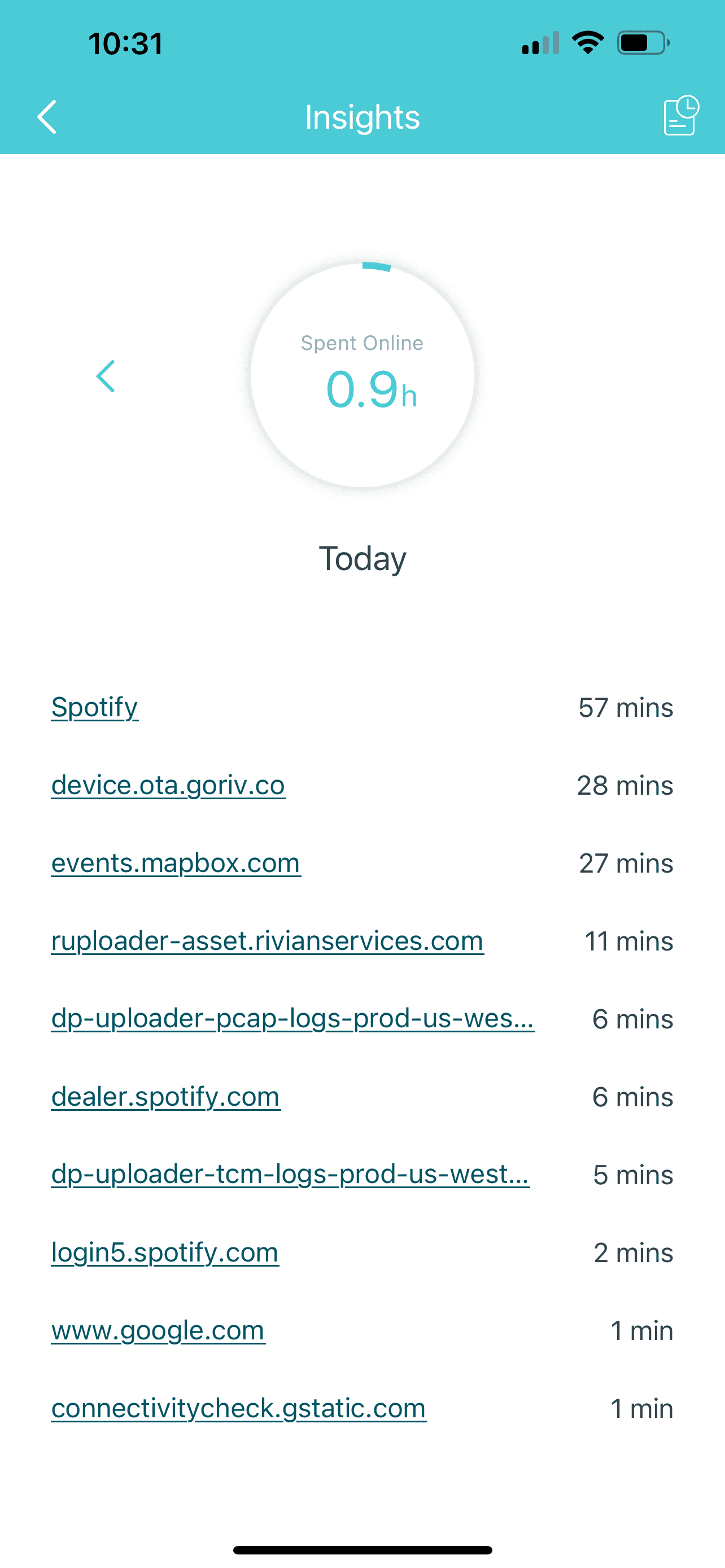

Past 4 hrs. Spotify and Rivian app were not running on my phone. Vehicle has been sitting.
Rivian R1T R1S Vampire Drain Relating to Frunk Trim -- my solution to reduce drain % 00F538E8-220E-4D30-B6AA-B085D87C7FA2
What the heck could Spotify possibly need to do while the truck is idle? And mapbox? Other than an update, why so much activity?. It sure seems like little regard was given to phantom drain concerns during architecture and design.

My rear lights also blink. I thought I had read that happens when it senses paak (BLE) from a distance (too far to justify fully unlocking). But I've also read conflicting stories, so who knows.
Vehicle Sleeping:
Waking:
