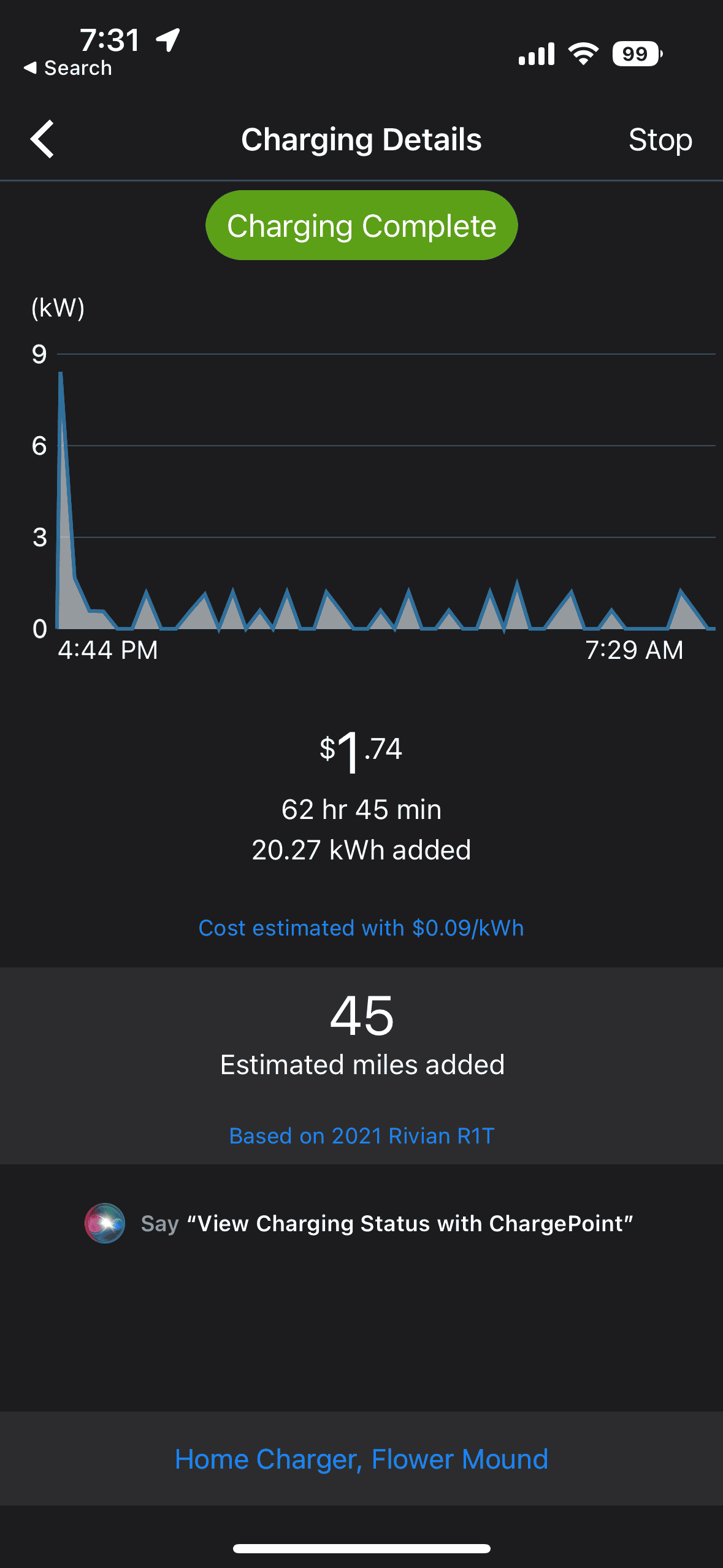

This is my test. Left it plugged in for 62.75 hours.
Locked, GG on - but off at home, PAAK app on.
Rivian R1T R1S Vampire Drain Relating to Frunk Trim -- my solution to reduce drain % CP
