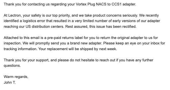

Received a statement from Lectron and they’re sending me a new one to test (will update y’all once I have it): “After conducting a root cause analysis, we identified a logistics error that resulted in a limited number of early versions of our adapter leaving our distribution partner. These early units, intended for testing purposes only, were subsequently intermingled with mass-production units. This issue has been rectified, and we are replacing all affected adapters.”

my Lectron Vortex had this same issue, I emailed Lectron and here is the response. new adapter already on its way and a free shipping label to return the current one:
