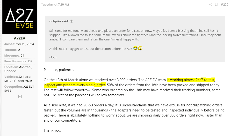

If I understood correctly this issue is for a certain number of adapters, not all of them.
Probably what happened that in the rush some latches got installed reverse.
And maybe Lectron does not test each individual adapters made but some randomly (normal QA).
What is interesting that if I understood @A2ZEV's posts A2ZEV does test each manufactured unit individually (and that is why they are relatively slow to send out the big amount of orders). This might be a winning difference between Lectron and A2Z adapters.
I based it on this post:
@A2ZEV does go above and beyond. Amine from their team called and followed up via text to ensure he is available to help next time I'm at a supercharger (to my earlier post where I couldn't get it to work so far).
Getting a good product is one, but backing it via follow up is a guarantee that they want to stand behind their product.
That itself is worth it's price.
[Standard disclaimer: I don't work nor do I know anyone personally at A2ZEV. Just a customer]
