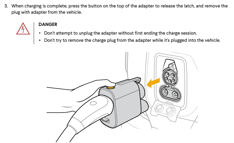

Wait a minute, I thought that the adapter+plug should be removed from the vehicle FIRST before detaching the adapter from the NACS cable. This is how the instructions for Rivian/Ford are written. Lectron is wrong here!!
I guess Lectron has their own charging procedure to follow.
My personal opinion is that any adapter should be foolproof since they will be used without regard to the actual instructions by a wide range of drivers. So they should be safe irrespective of the assembly order, provide a locked, low resistance connection, and assemble/disassemble without undue force being required. Not sure if this last condition is being met but time will tell.
75
9,221
12,786
I think Tim-in-CA is right, both NACS and adapter are to be removed together first. But, if the charging session has stopped, there shouldn't be any danger. But, "because lawyers", instructions are typically written to be as fail-safe as possible.
As for tightness of the adapters, I think it has to do with the polymer blend involved. Dimensions change between when they are freshly molded and when settled to room temp. So it's not precise to start with. And to account for wear, they are probably made slightly oversized.
