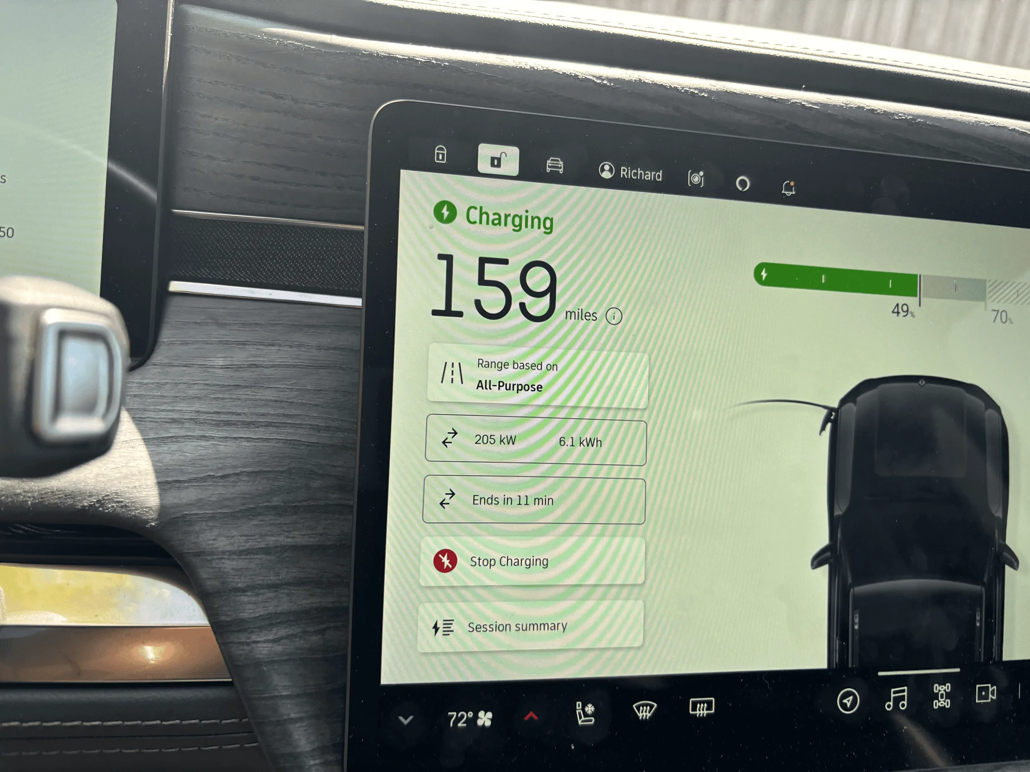

@A2ZEV et al, I finally got around to testing the A2Z adapter. Worked great. Plugged in at about 49% SOC on my R1T. Top charging power I saw was 205 kW (see attached photo). However...
As others have noted, getting the Tesla plug securely inserted into the adapter takes a non-trivial amount of force. Also, the lock switch does NOT have a sharp, satisfying feel indicating when things are locked. I needed to test the locked state (by trying to pull Tesla plug out) several times before I finally got things locked. I doubt most folks will be as patient as I was, so I expect many will assume either the charger or adapter is not working.
The next time I charge, I may try some dielectric grease to see if that reduces friction and makes it easier to insert the Tesla plug into the adapter. ??‍♂

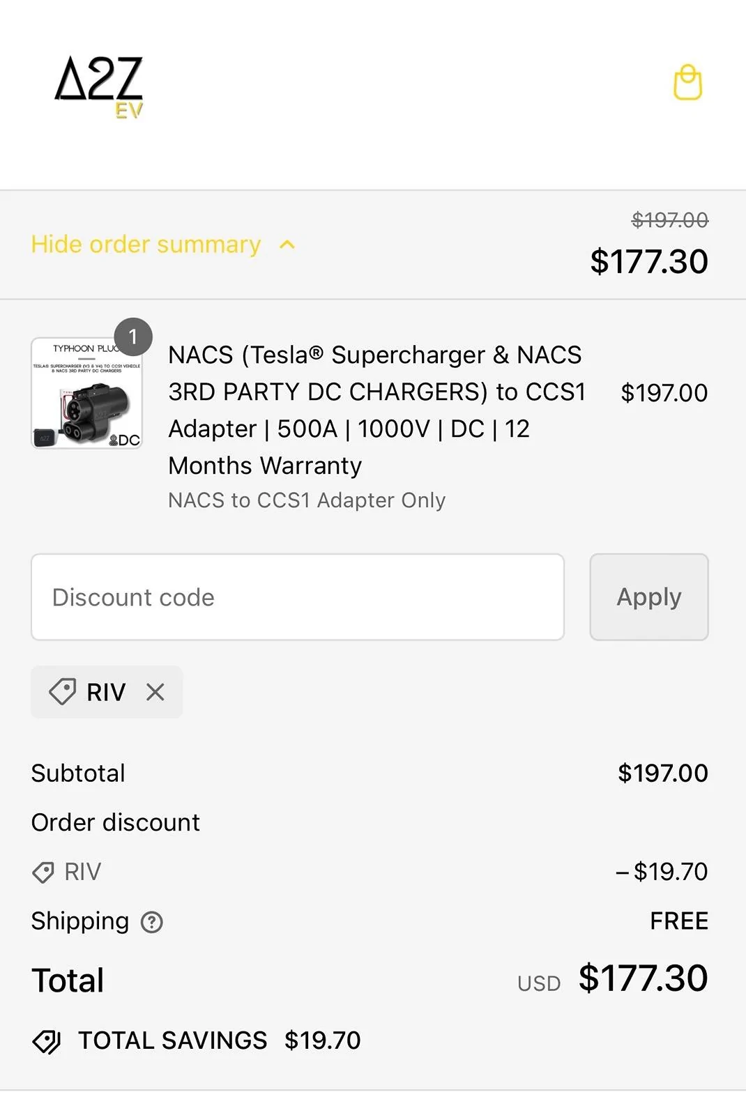

I don't understand why anyone would pay more money for Lectron Vortex adapter and take on the risk of safety defects.
I would order an A2Z adapter using the "RIV" discount code to get it for $177 shipped and then call A2Z to upgrade to $15 overnight expedited shipping.
It still takes 3 weeks for your order to ship out and then after that you will get it next day with UPS Overnight.
They are extremely responsive and will be able to give you an idea when your adapter should arrive.
Maybe ask them what options you have available to expedite delivery.
