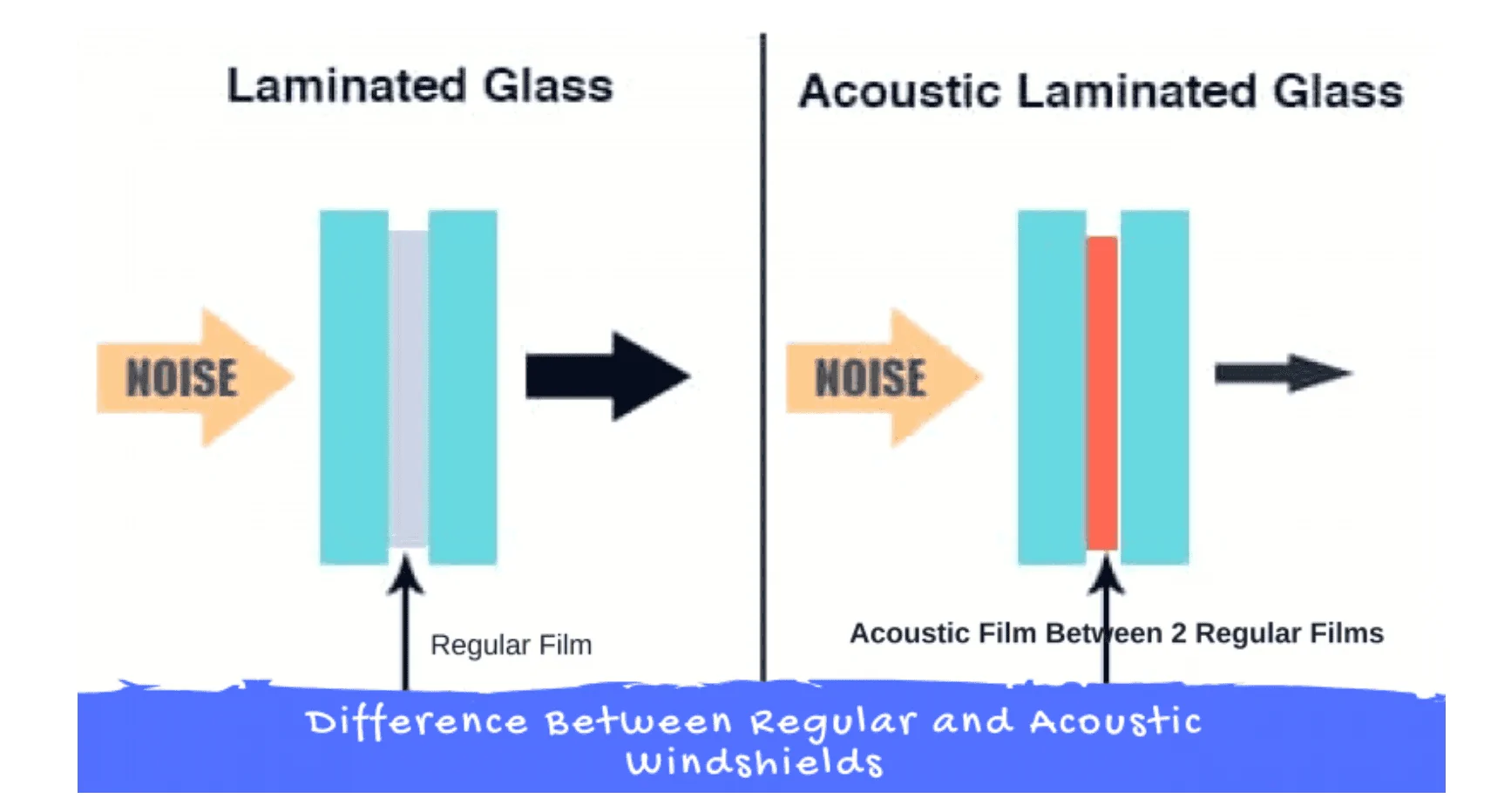

I don't see it mentioned here so I will bring it up the front windshield on this truck and most of the new vehicles is acoustic glass two thin layers glued together to make the sound better in the cab. This is why they seem weaker than the windshields you are used to but the Hummer, new F150 and most new trucks are starting to go this route because it makes the cab so much quieter. This is also one of the reasons the glass is so expensive.
Laminated safety glass has been required for windshields since about 1937.
Zoidz
Gil
Feb 28, 2021
227
5,218
11,740
Right, but it appears acoustic glass is laminated safety glass 'on steroids' and is overall thinner.
"What is an Acoustic Windshield? An Acoustic Windshield is a windshield with added layers of soundproofing insulation. In between the two layers of glass, there are two layers of Standard PVB and one layer of acoustic PVB in between the Standard PVB making the cabin of the vehicle quieter.
Acoustic vinyl also allows vehicle designers to reduce the thickness of the windshield without adversely affecting noise levels. This is especially significant as automotive engineers try to cut weight off vehicles to make them more fuel efficient. Acoustic vinyl windshields meet all of the same federal safety specs as regular vinyl windshields."

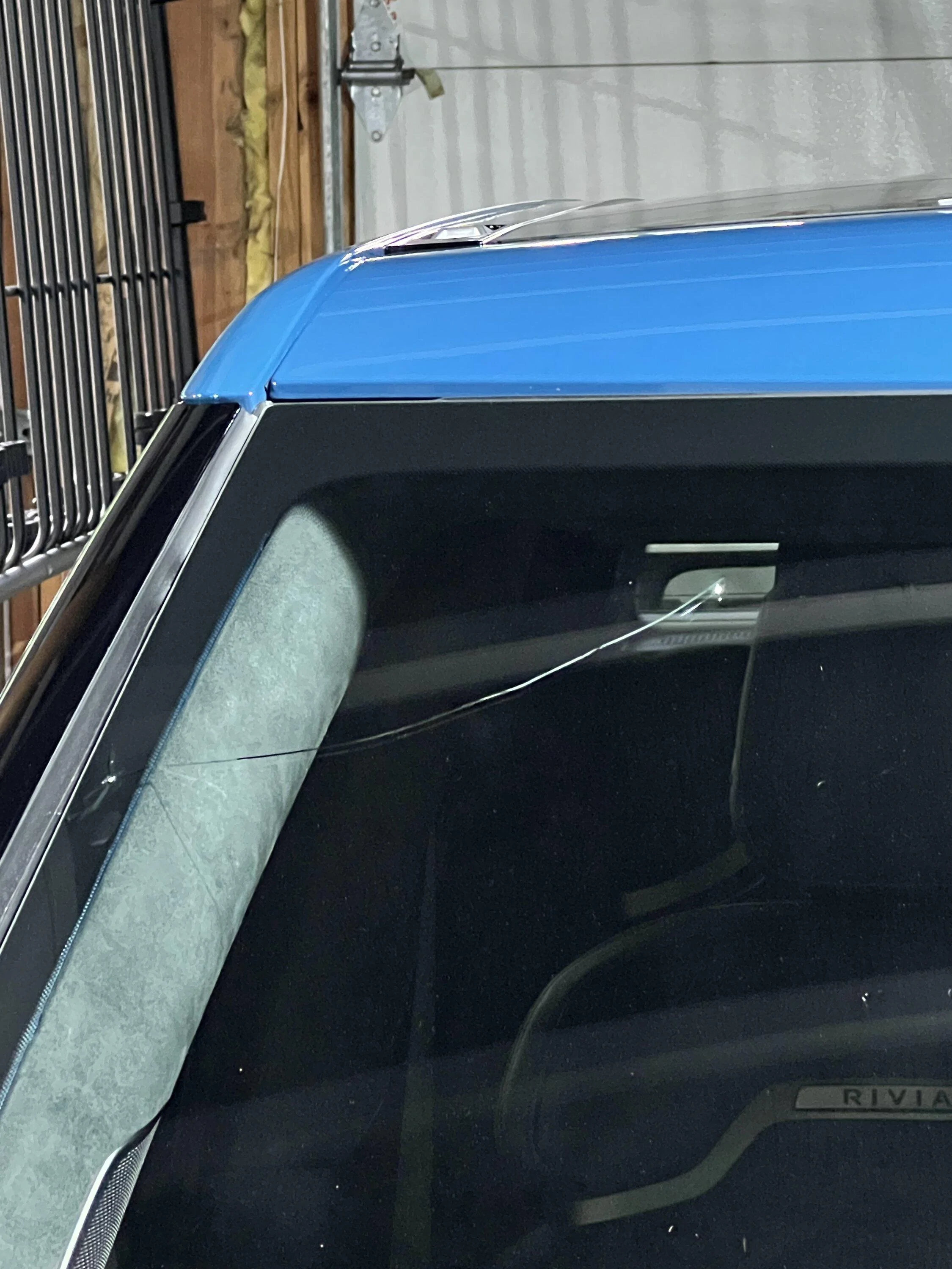

So I guess mini-update, the crack has spread upwards about an inch and a half from just sitting in the garage
Spoke to a new service person, and he said he would actually contact the Bellevue Service Center and get some answers, rather than just attaching a note to the report like the last gal did. Fingers crossed ?
