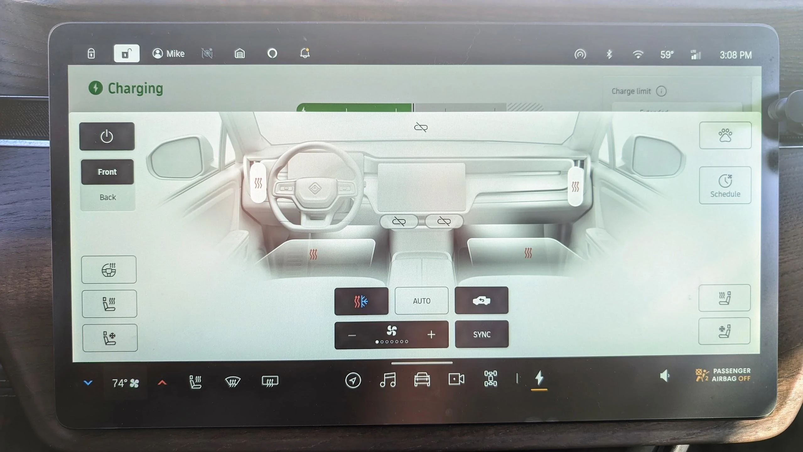

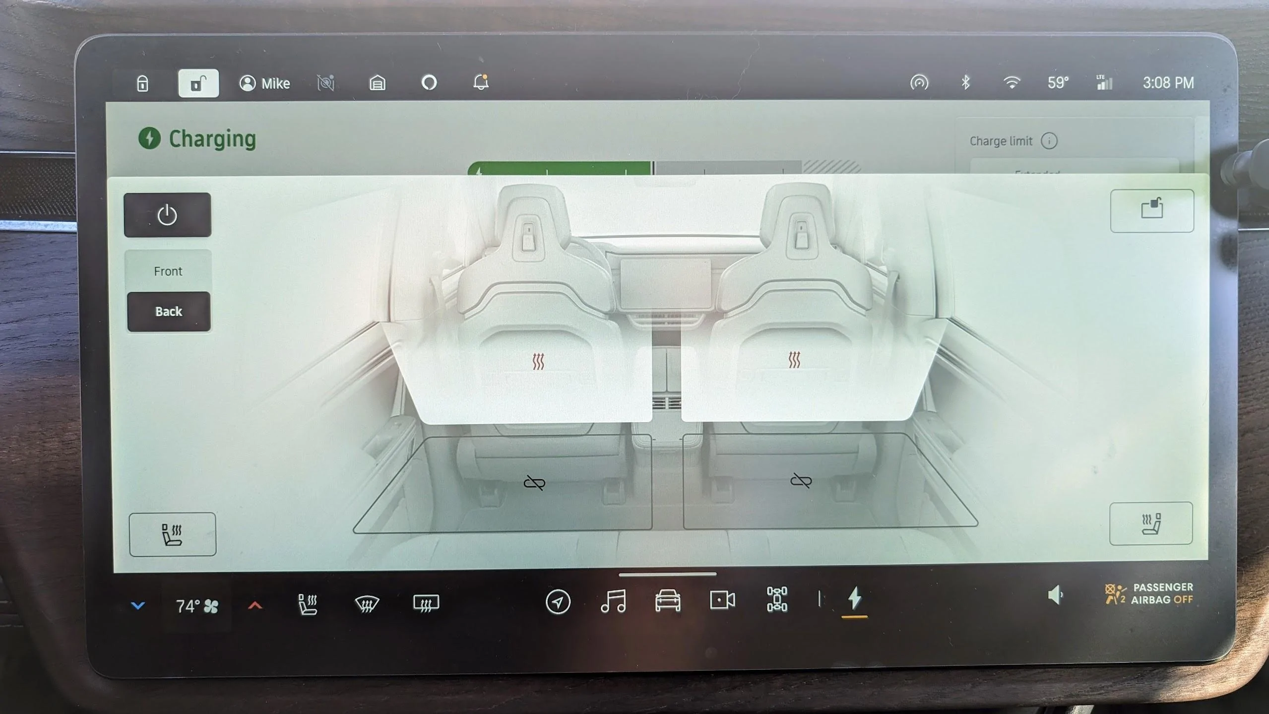

I understand that your heat's not working well and you are frustrated, but your reply is kind of rude and makes me regret trying to help you.
Literally just try the settings I posted in my photos. That's why I took the photos and posted them for you. They've worked well for me all winter, even when it was 5 degrees outside.

known software bug….work around is to be sure your rear heat is on (I just keep rear floor vents on during winter)….

No complaints about mine. Try these settings.
A few thoughts:
  • You can tap & drag to adjust direction of vents/airflow (lot of new owners don't know this)
  • Supplement with heated seats & wheel as needed
  • Don't use Auto, otherwise it will do stupid, unpredictable things (just my opinion) ?
