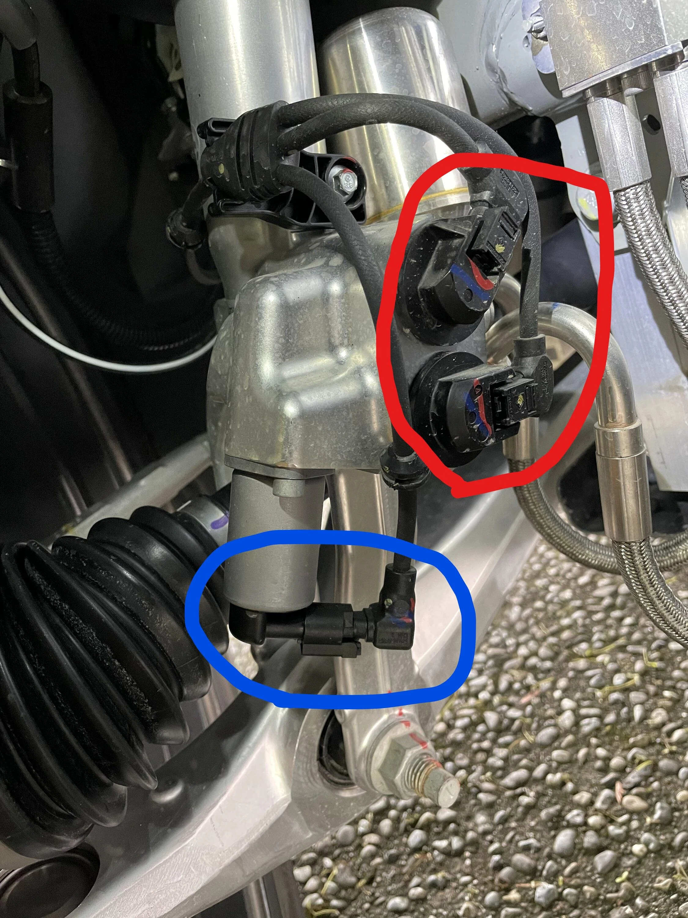

So, hard reset didn’t work. But it was because there was a second connector loose on the opposite corner of the vehicle too. Once that one was reconnected, the error just went away. Woo!
Nice work! Please do provide Rivian details of exactly which connectors were loose so they can make sure this doesn't happen again.

@mindstormsguy, would you mind please showing which fitting was loose and the tab that needed pulled to secure it?
Is it either the blue or red versions circled, or another fitting?
Thanks again, urtheman.

Forgive my stupidity, but I don’t want to assume. These connections are located under the car near the wheel, right?

Once the second connector was also plugged in, the error cleared.
Yes, these are behind the wheels, at the bottom of the shock. But if you’ve had your truck for a while and haven’t had an issue, I’d say yours is clipped in, and you’re not going to have the same problem as me.
Just curious, both front, both rear or mixed wheels?
Opposite corners. Front left, and right rear
Im not sure you could lift each corner anyways.. as you would have to put the suspension is lift/spare tire replacement mode. And it sounds like that part of the menu is currently/was locked out?
I didn’t try, but it probably would have worked. Air suspension still worked. It was the damper adjustment that didn’t change.
