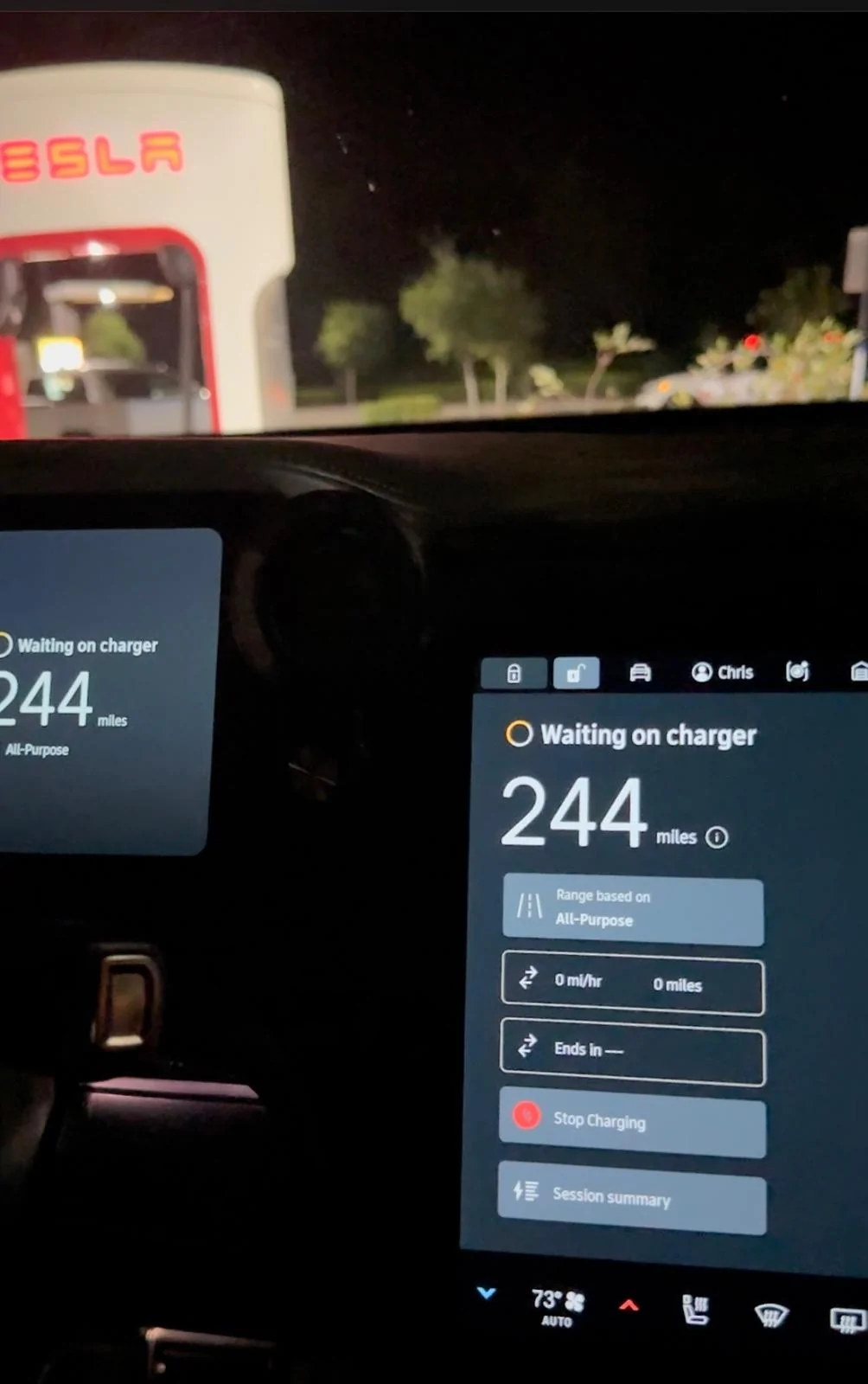

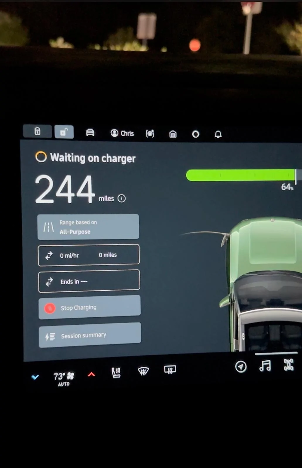

I wanted to test out the Lectron Tesla adapter, at a Tesla Supercharger 250kw. (I know, iLectron is not currently an approved adapter by Rivian…), but it didn’t seem to work. These two stations showed up on my Rivian navigation system, I assume they are available for use.
I tried two different Tesla supercharger stations (both rated 250k). I kept on getting the “Waiting on Charger” notification and it would time out and start up again. This happened multiple times and after about tens minutes, I aborted the test in both locations.
Vehicle: 2024 R1S, Max Pack, Dual Motor
My current software Version is 2024.07.02
My current battery SOC was at 64% when I attempted charging
Data and cellular connectivity was fine in app and in the vehicle.

I have had this exact same issue with my R1T but with Electrify Canada, IVY and Petro Canada. I don’t know about Tesla stations that require an adapter but the one I have tried with a Magic Dock has worked.
The charger fires up and seems like it’s going to start charging but then the truck says unplug and try again. Any 50 kW charger works from what I have tested so far. But anything higher other than Flo, Rivian and the one Tesla with Magicdocks will not charge.
I really believe it is an issue in software with the truck but who knows. In Canada where I am there are not many options for chargers so hopefully it gets rectified at some point otherwise I’ll be spending a lot more time charging on trips.

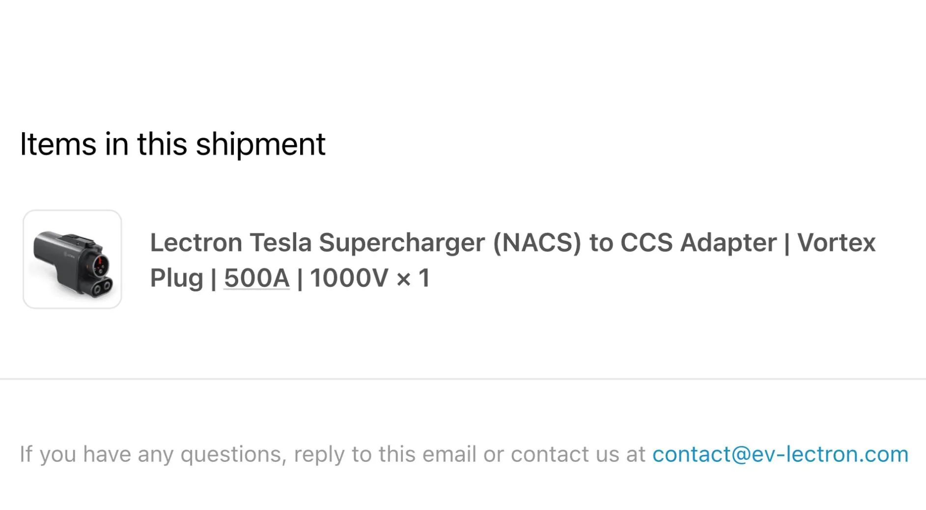

Can you show us a picture of your adaptor? You're confident it's a NACS to CCS adaptor and not their NACS to J1337 adaptor?
I am away from the truck, but this is what I was sent. And I checked the specs and it is exactly as depicted. I ordered it months ago and it arrived a few weeks ago and I just got around to testing it.

Truth! While this is not an urgent need, I figured, I would try it out and get the adapter. I am quite familiar with and have teslas since 2012, so, I am comfortable with charging, and traveling up and down the east coast every few months Utilizing Tesla chargers. I am optimistic when the official Rivian adapter is delivered this won’t be a problem, but I am hesitant about calling their support prior to that. Hence I resort to this very active and knowledgeable forum to help diagnose.
