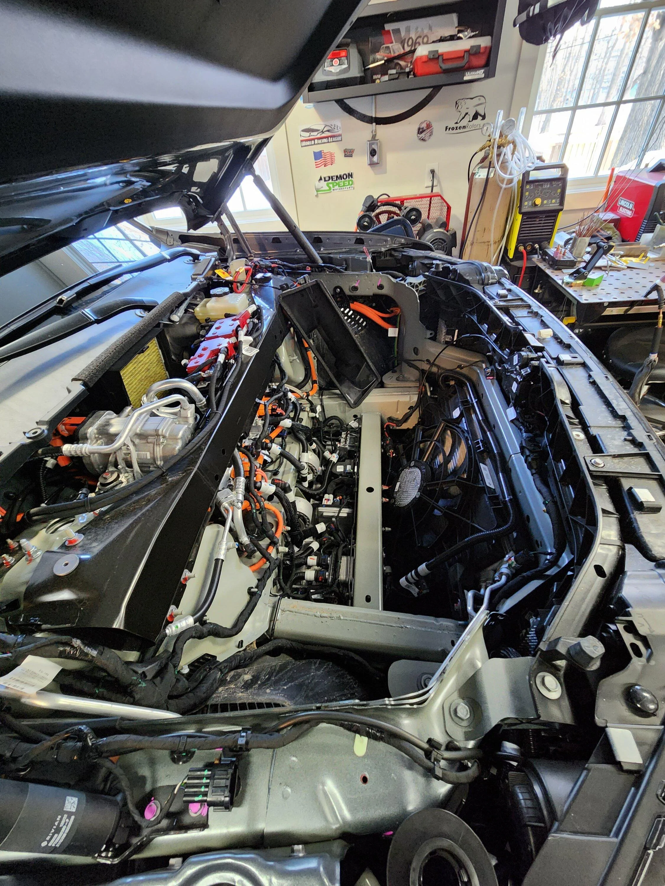

2. The Rivian batteries are just cheap sealed lead acid batteries. 12V 18ah. I've got a ton of them laying around I use on my race cars. They are the exact same, probably all made in the same factory (hah). Size, ah, post locations & thread size...everything. See pics, sorry the Rivian one is fuzzy (I deleted the wrong image).

Rivian R1T R1S What I learned from my 12V battery swap 20230325_102639
Rivian R1T R1S What I learned from my 12V battery swap 20230325_102611
