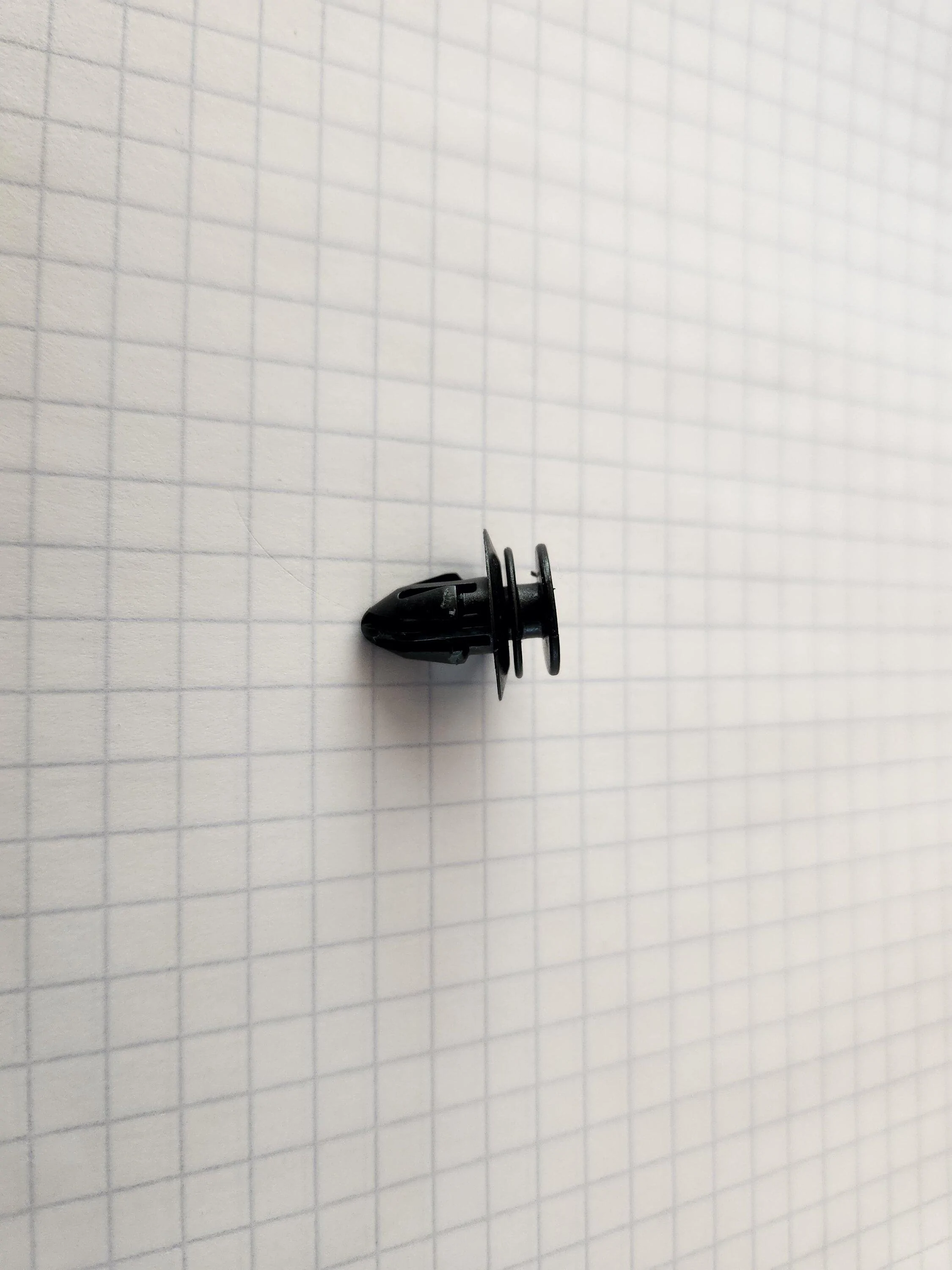

Are they conventional automotive trim panel clips or something special that would need to be sourced from Rivian? I am really interested to see more of what is under the skin but am reluctant to break a bunch of clips and connectors that are not designed for graceful removal.
They are pretty standard. There is a black one and a white one. Here is an actual pic of the black one and something similar out of a dodge that I found with a quick search that probably does the trick. You won't break all of them, probably need a handful to replace.
