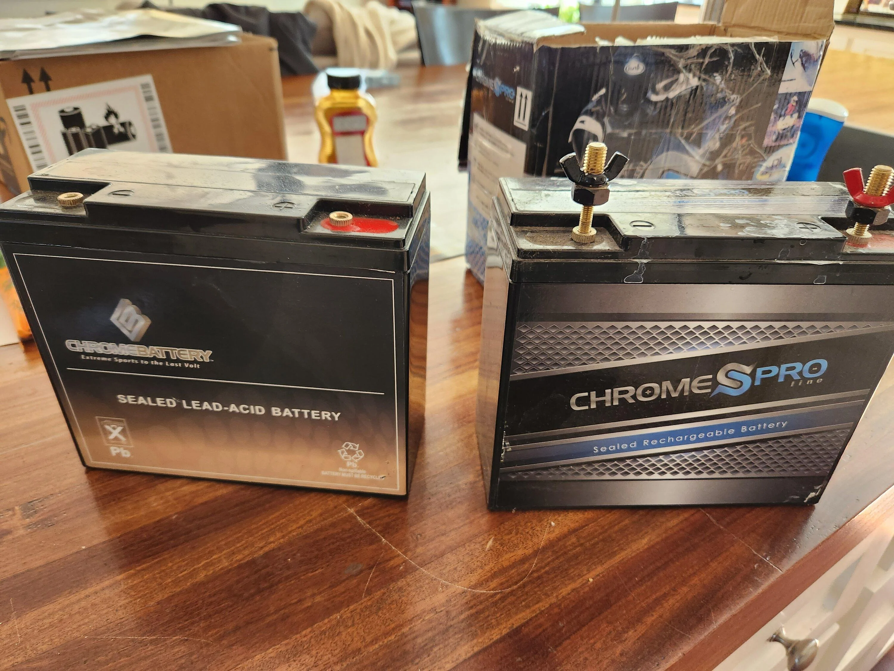

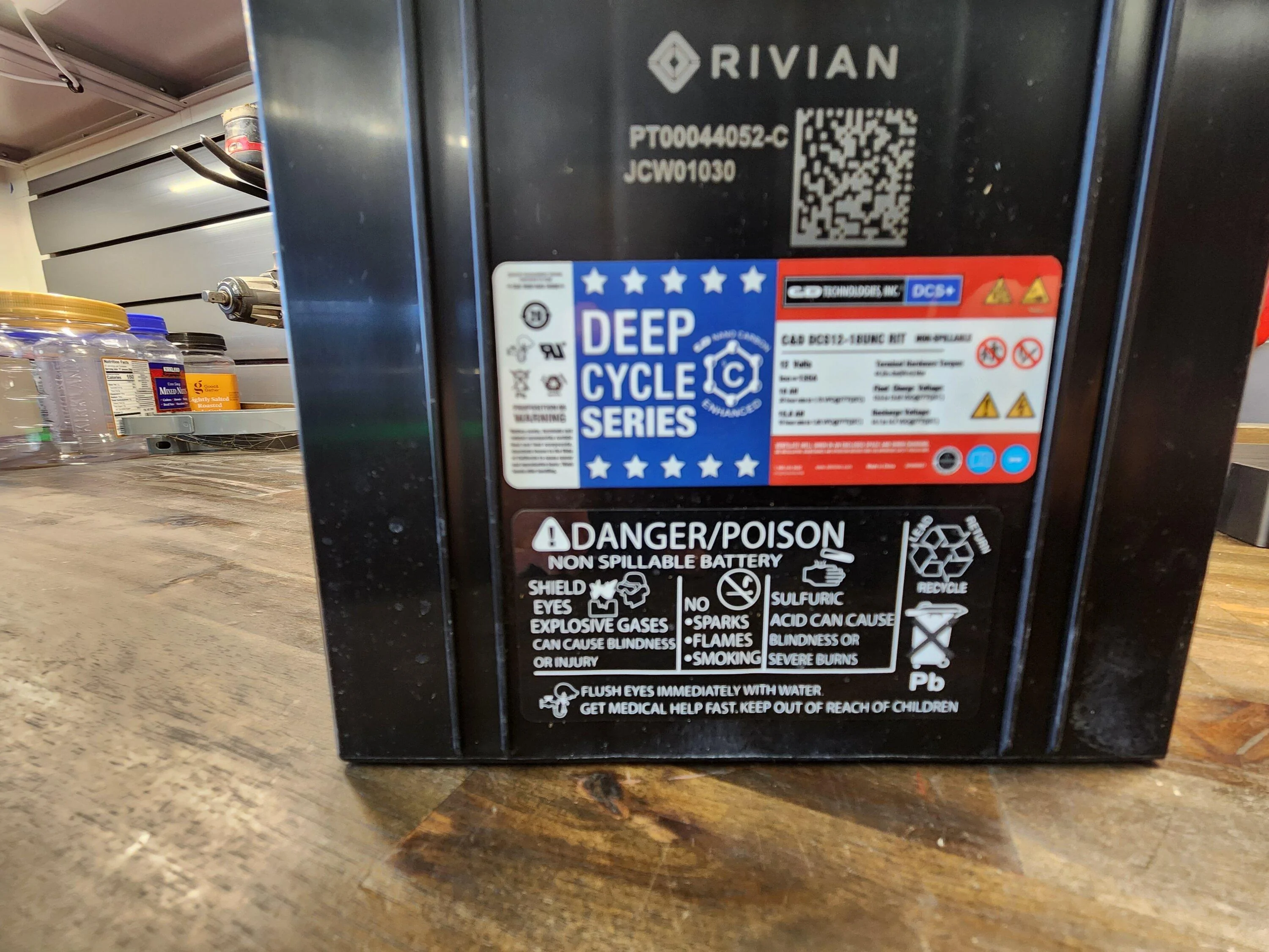

2. The Rivian batteries are just cheap sealed lead acid batteries. 12V 18ah. I've got a ton of them laying around I use on my race cars. They are the exact same, probably all made in the same factory (hah). Size, ah, post locations & thread size...everything. See pics, sorry the Rivian one is fuzzy (I deleted the wrong image).

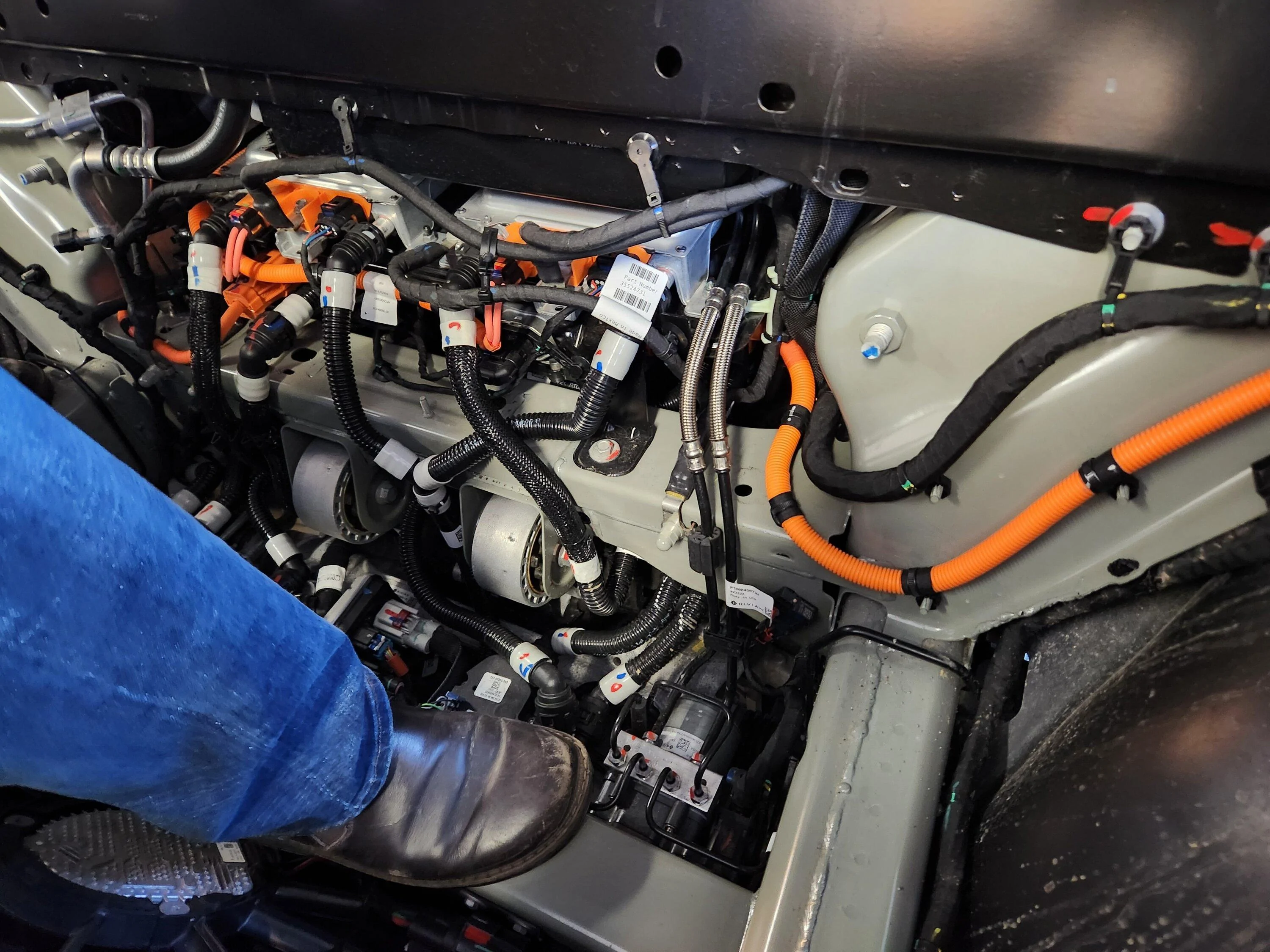

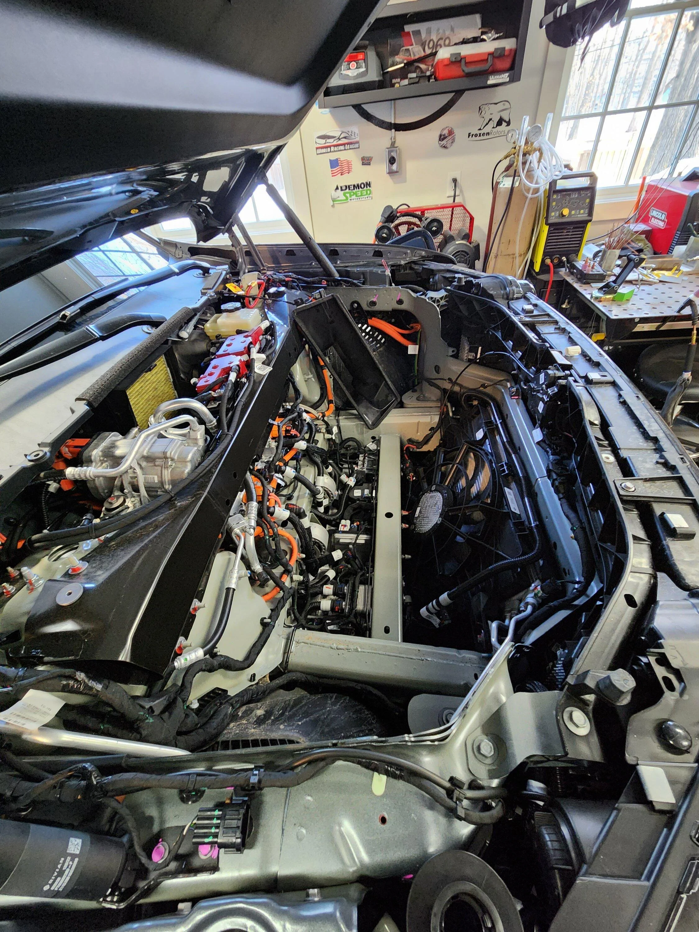

4. Removing the frunk and getting access to everything is ridiculously easy. Remove trim and it exposes 6 bolts and two electrical connectors for the emergency frunk exit...boom frunk out in like 15 minutes. Be prepared though, you'll break a fair amount of clips doing so. What the frunk removal exposes is the beauty of the simplicity of an EV compared to an ICE vehicle. The electronics/software aside of course. In these pics (again not great ones) you can see the ABS pump (next to foot). The AC compressor (simple to service). The two inverters below the battery. The heater (aka a blow dryer on left side, hard to see). The seat chillers (left side - directly opposite the abs pump). Two front motor mounts. Anyways, it's all so simple and easy to access.
