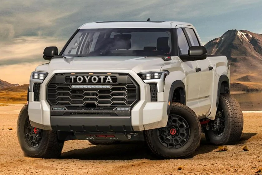

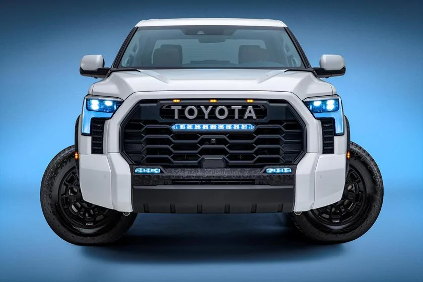

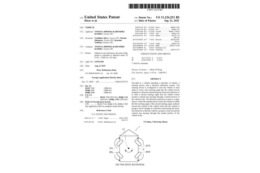

4 wheel steering is more practical for day to day driving. Tank turns are IMHO a trick or gimmick that has very few applications other than to show off to friends. TOYOTA already has designed and patented 4 wheel steering and side sliding.
Rivian R1T R1S When Will R1’s Get 4-Wheel Steering? TOYOTA 1
Rivian R1T R1S When Will R1’s Get 4-Wheel Steering? TOYOTA 2
Rivian R1T R1S When Will R1’s Get 4-Wheel Steering? TOYOTA 3
