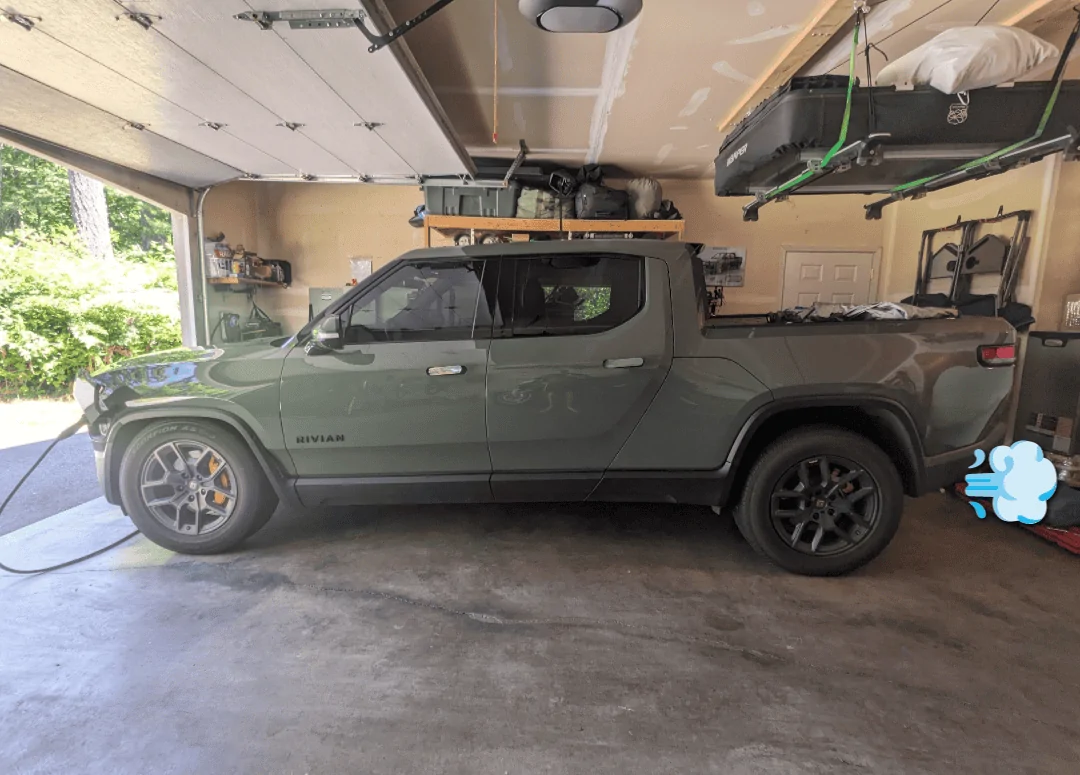

That’s weird. If you go into settings and put it at low then immediately back to regular height, does it self-correct?
Mar 29, 2021
121
6,436
10,875
Kitsap, WA
Downward Dog!
It was in low, so I put it into standard and it got really confused, then finally titled back the right way and filled the front left.
148
13,611
27,524
Air leak will cause this to happen. Did it take a while or was it immediate?
madgrey
Allan
Feb 26, 2022
903
1,241
Fidalgo Island, WA
Hardware Design Verification
Mine had this issue for the first few months. The SC said that an air line had a rolled O-ring (after replacing a bunch of other stuff)
Mar 29, 2021
121
6,436
10,875
Kitsap, WA
Overnight, but why stick the ass up so high? The front was in the Low height like before, but the ass went into high.
Rural1T
Brett
Mar 17, 2024
45
58
Montana
Was there a heavy load in the bed the night prior?
With my T I've noticed that after you remove a heavy load from the bed the rear suspension sits high until you drive the vehicle again. I think it's due to the vehicle adding air pressure to the rear suspension to level the vehicle under load.
edman007
Ed
Aug 10, 2022
269
429
New York
CY R1S
If the rear went up, then it's probably a leak on the inside of a valve (so air leaked front to rear because the front has more weight on it, it didn't leak out of the system)
