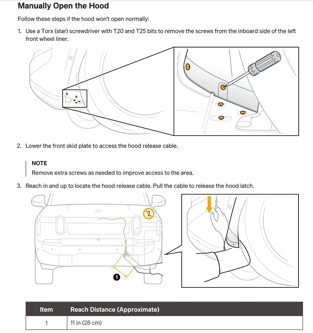

Mike beat me to it. I wouldn't want to actually have to learn or do the manual frunk release procedure, but that's what others have said as well.
https://www.rivianforums.com/forum/...where-do-you-store-jump-box.25416/post-503746
FWIW, the manual frunk release process is actually pretty easy. You really only have to remove the farthest screws in the bottom part of wheel well and then you can pull the plastic back far enough to reach in and pull the cord at which point the frunk pops loose.

Does anyone have a link to a video showing this procedure? Would be a great bookmark for an emergency.
It's in the manual. Note there is not a lot of space in there depending on your wheel position. I think I ended up using the torx bits directly not the screwdriver.

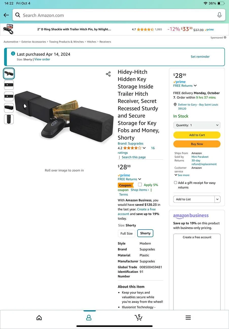

Hoping that all of this will forever be for nought (and after being cautioned by Houston SC that a jump box may not work)…
I used this with a hitch receiver pin key and a quarter:
Rivian R1T R1S Where To Store Jump Starter IMG_0104
This for the receiver with the necessary torx wrenches, paint can key (to help remove the cover to gain access to the 12V jump cable) and some foam to prevent/minimize the inevitable rattling:
Rivian R1T R1S Where To Store Jump Starter IMG_0103

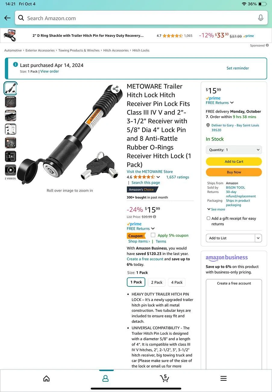

with this hitch pin lock:
Rivian R1T R1S Where To Store Jump Starter IMG_0102
I did have to cut down the wrenches and the key…

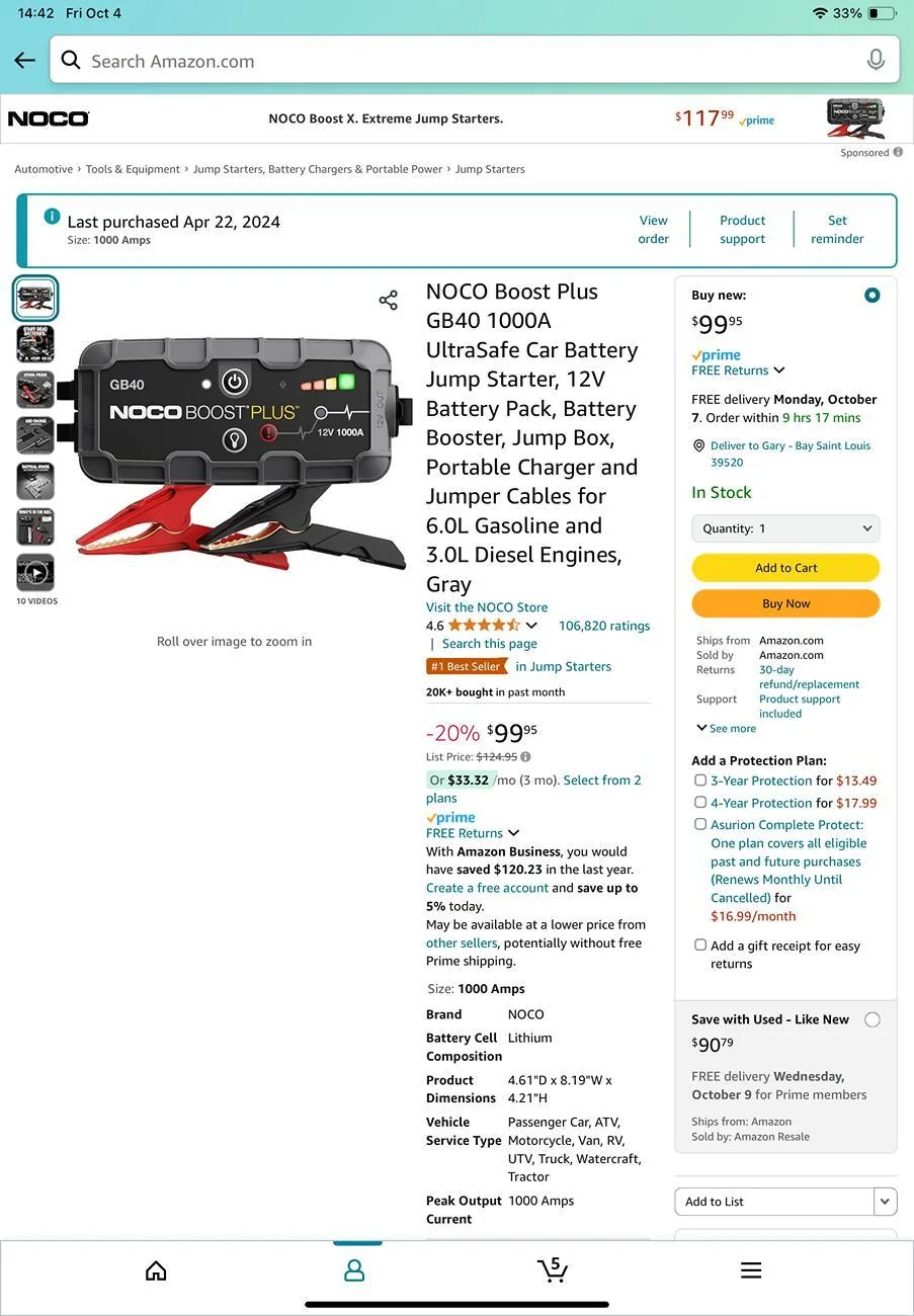

This jump box:
Rivian R1T R1S Where To Store Jump Starter IMG_0105
