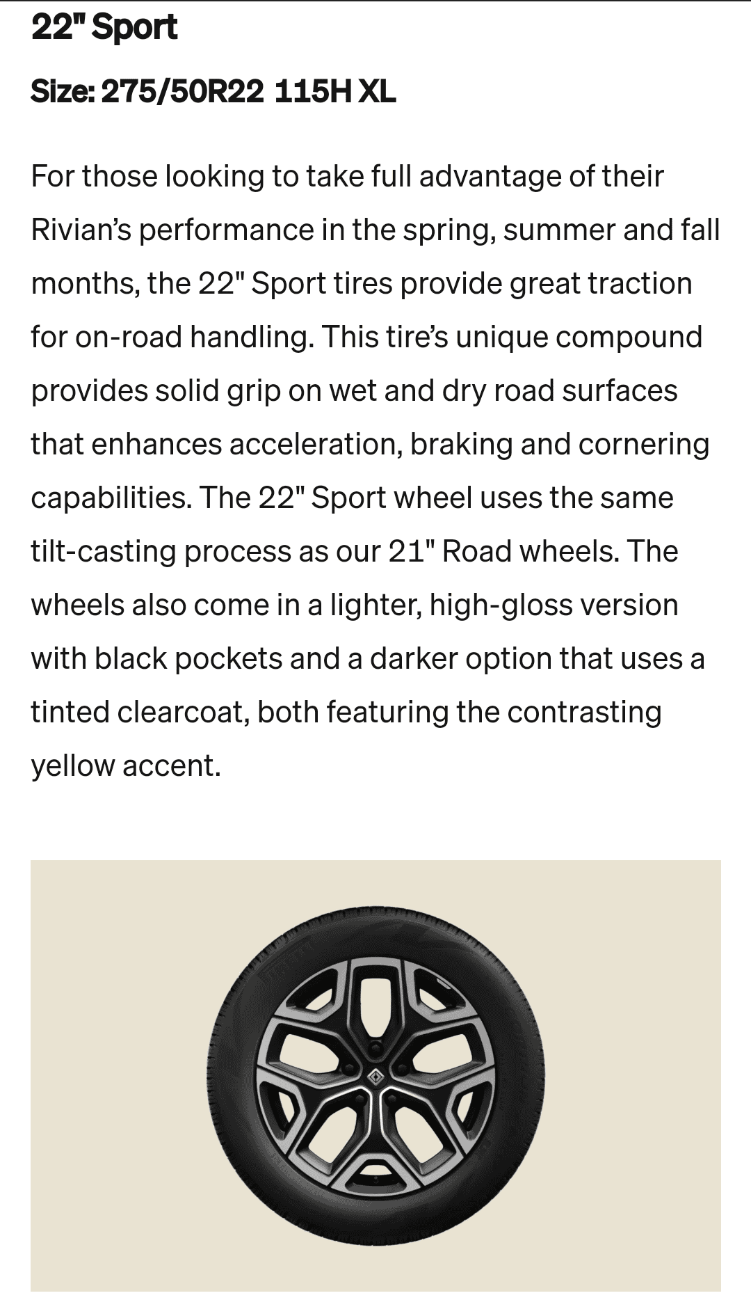

I'm in the Puget Sound region as well and I'm going with 20s because I do off-road. But I'm considering 22s for a potential R1S. I thought they said 22s are best for icy and wet, but can't find that now. Just this:
Rivian R1T R1S Which tires to get for driving in the rain? Screenshot_20220221-123511~2
